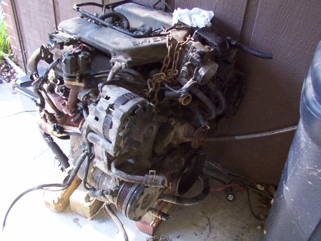

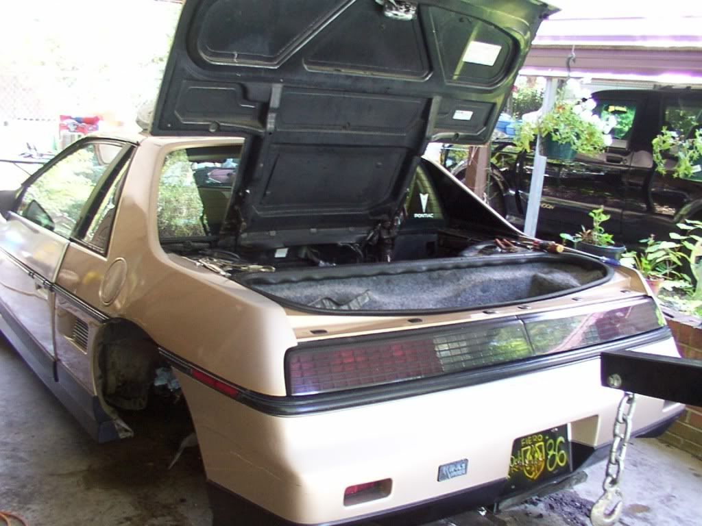

Well figured I would start a build thread for the 3.4 motor I'm putting in my car. Since the 2.8 finally spun a bearing or something(haven't pulled the pan on it yet) but the 2.8 didn't have much longer with the knocking and noises it was making.Anyway pretty much all of yesterday me and my buddy went to two junkyards with no luck for finding a engine we decided to call it quits and return home,well I came home and started looking around on CL and found a guy parting out a 93 Firebird with a 3.4.Anyway I got this great running 3.4 out of a 93 Firebird with a 5 speed at a deal I couldn't pass up.Pics to follow of the lucky engine thats going in my car and a few of the donor car.
How to pull motor mount bolts and trans bolts lol
engines coming out
Engine out an at home
Tomorrow i'm getting a engine stand from John (Fiero Redux) and can start working on it.

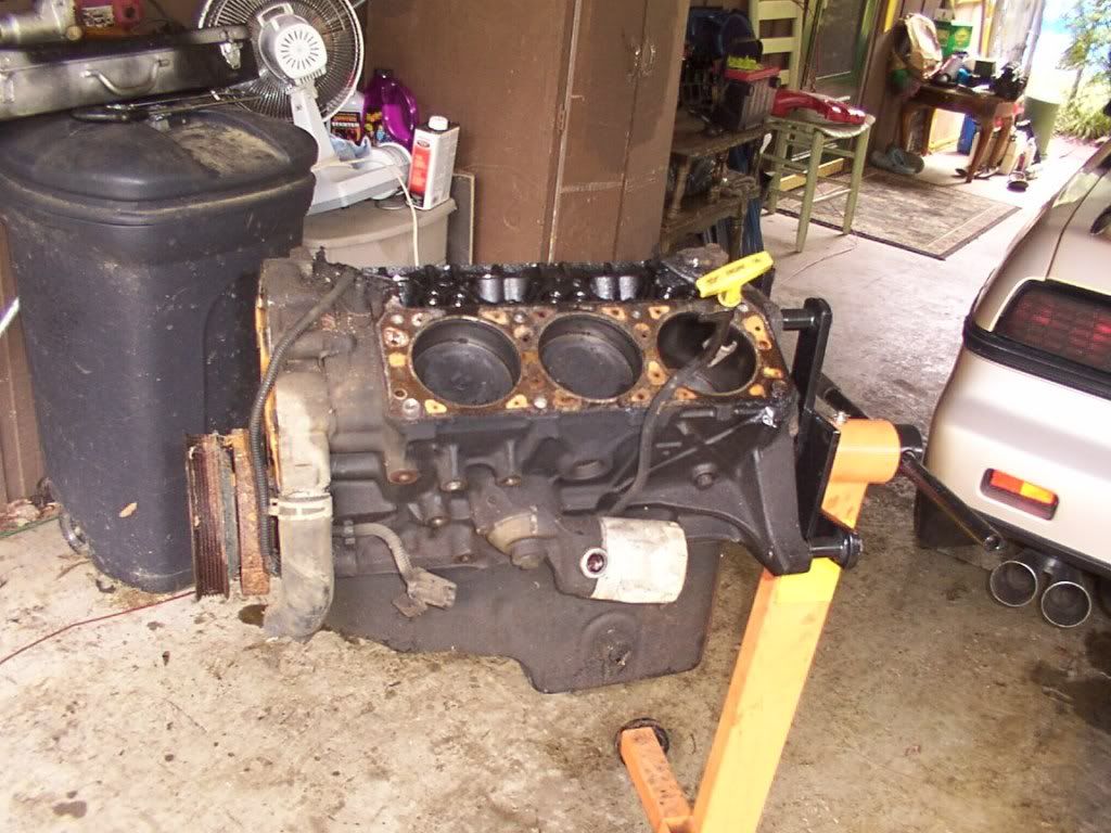

Been tearing the engine apart on the 3.4 getting it ready for a good cleaning.

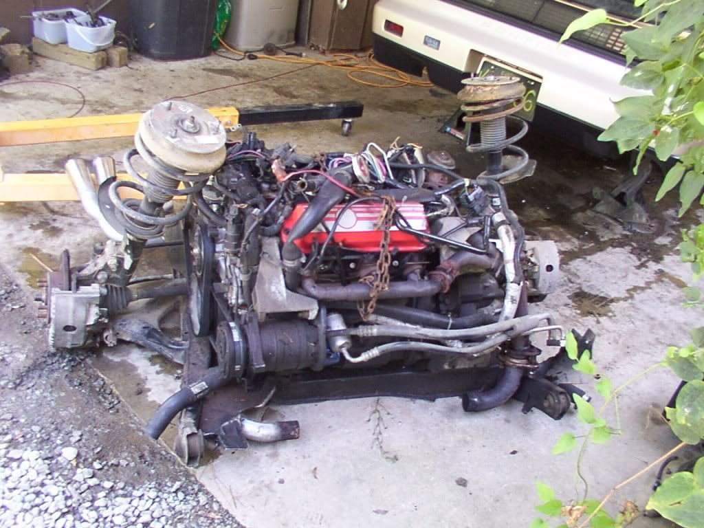

Korey what was on the other end of the chain...eric....that is a unique way to do trans mounts....
NCTyphoonKid
Posts: 1278
From: Trinity, NC USA
Registered: Jun 2008
Report this Post07-11-2010 09:51 PM Click Here to See the Profile for NCTyphoonKidSend a Private Message to NCTyphoonKidDirect Link to This Post
I assume you mean when it's on its side? A 4x4 80 something chevy blazer

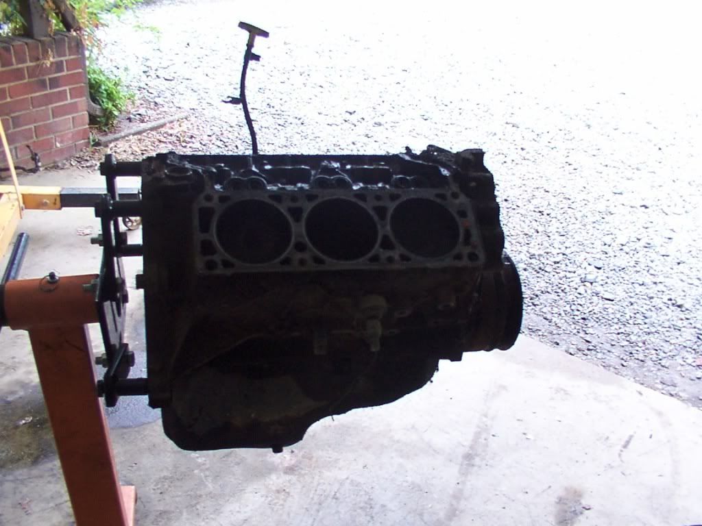

Report this Post07-12-2010 04:18 PM Click Here to See the Profile for NCTyphoonKidSend a Private Message to NCTyphoonKidDirect Link to This Post

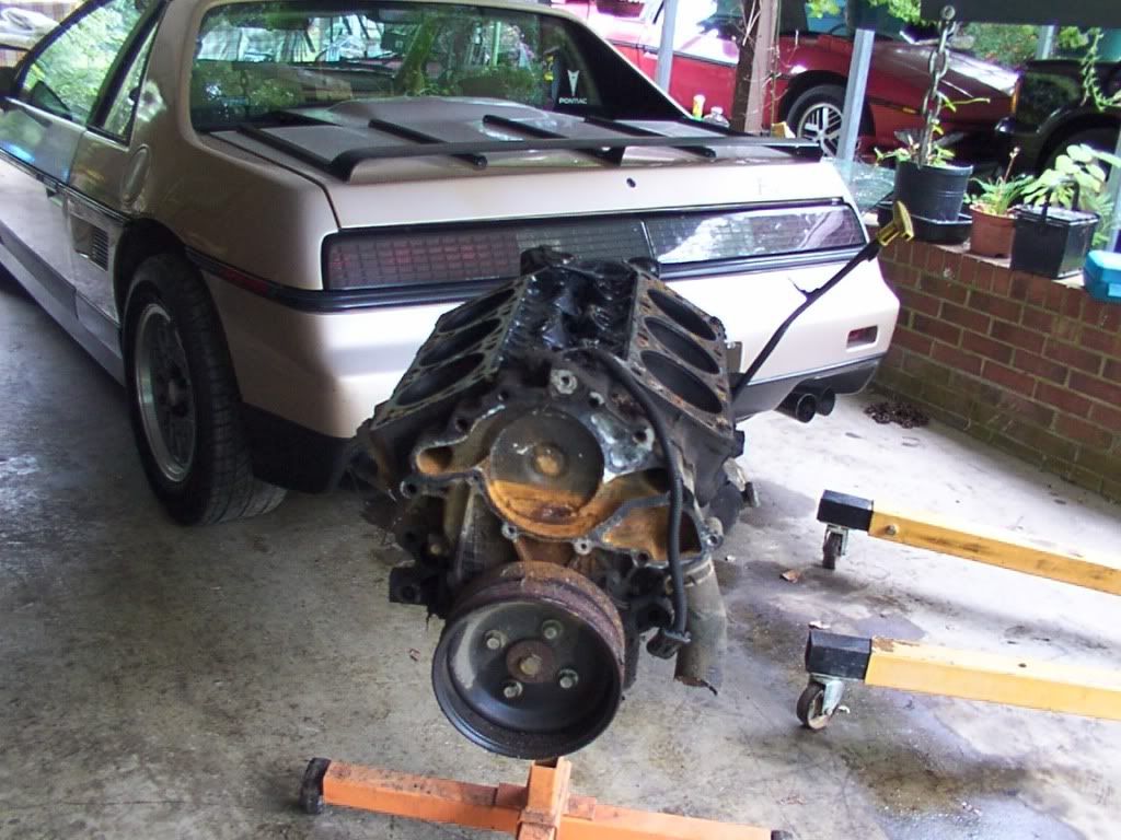

Today I got the 3.4 on the stand(Thanks John) Got the heads pulled off and the cylinder walls look pretty good.

Report this Post07-12-2010 05:46 PM Click Here to See the Profile for RWDPLZSend a Private Message to RWDPLZDirect Link to This Post
Sure got it torn apart pretty quick, let's see how fast you can get it in and running
Swapping over all the 2.8 parts, or converting it to use a 7730 ECM and DIS? I vote for the latter

Report this Post07-12-2010 06:04 PM Click Here to See the Profile for Fiero reduxSend a Private Message to Fiero reduxDirect Link to This Post
I think he's planning to swap over the 2.8 stuff.

Report this Post07-12-2010 06:06 PM Click Here to See the Profile for L67Send a Private Message to L67Direct Link to This Post
7730 would be better.

Report this Post07-12-2010 06:18 PM Click Here to See the Profile for NCTyphoonKidSend a Private Message to NCTyphoonKidDirect Link to This Post
I'm using pretty much all of my 2.8 parts.I thought about doing 7730 but wanted to keep my new distributor parts I've put on and I don't want to do any serious wiring.

Report this Post07-12-2010 06:30 PM Click Here to See the Profile for L67Send a Private Message to L67Direct Link to This Post
The 7730 upgrade is minimal wiring if anything. If you're not comfortable with it, pay me to build you something. I've heard that with only the addition of the newer computer, the car felt a decade newer. I'd seriously consider this if I was you, now's the time to do it.

Got the front cradle bolts ready to come out (Thanks Galen) Hoping to have the motor out either today or tomorrow
NCTyphoonKid
Posts: 1278
Report this Post07-19-2010 02:24 PM Click Here to See the Profile for NCTyphoonKidSend a Private Message to NCTyphoonKidDirect Link to This Post
Today is the day I hope almost have the engine ready to come out pics soon
NCTyphoonKid
Posts: 1278
Report this Post07-19-2010 04:06 PM Click Here to See the Profile for NCTyphoonKidSend a Private Message to NCTyphoonKidDirect Link to This Post
NCTyphoonKid
1278 posts
Member since Jun 2008
the motor is out
[This message has been edited by NCTyphoonKid (edited 07-19-2010).]
