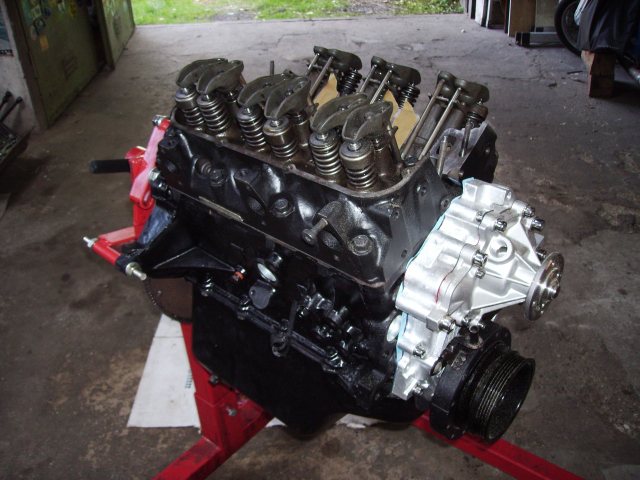

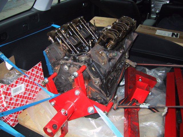

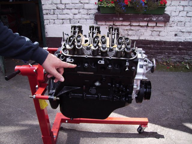

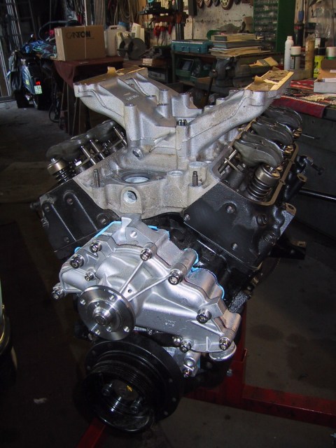

This weekend I finally got the engine back after many delays.
Before:
After:
Done:
- New cam installed
- New heads installed
- New pistons installed
- New bearings installed
- Crankshaft polished
- New seals installed
- Polished SS screws whereever visible
- New waterpump
- New timing chain
- New oil pump
- Underdrive pulley
- Block and everything cleaned and painted black
- and lots of other small stuff...

Originally posted by FIEROPHREK:
Cool ! refresh my memory...did you get any performance parts installed ?
Back On Holiday
Posts: 6238
From: Downingtown, PA
Feedback score:    (17)
Total ratings: 153
Report this Post09-21-2005 09:45 PM Click Here to See the Profile for Back On HolidaySend a Private Message to Back On HolidayDirect Link to This Post
Please Tell me they put a metal impeller waterpump in and not the cheapy plastic impeller that is so common?

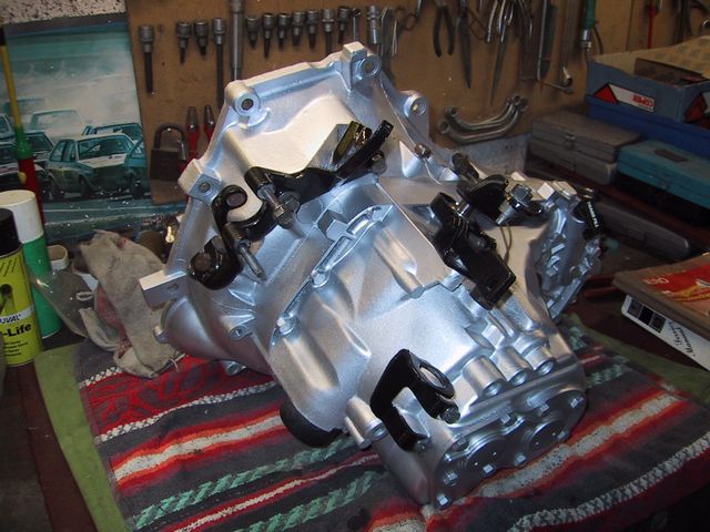

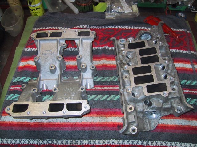

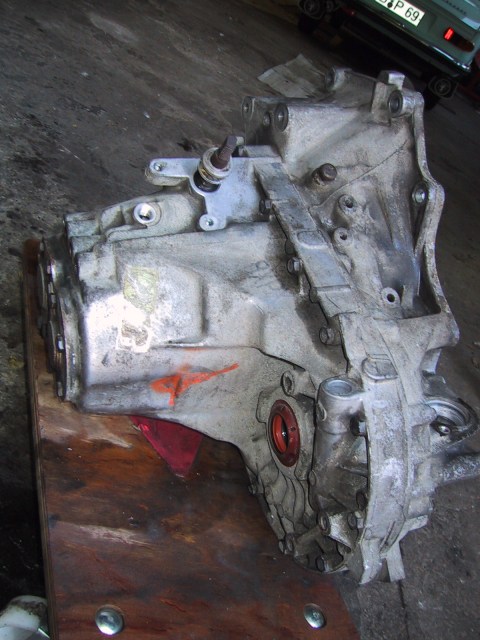

Report this Post10-07-2005 12:50 PM Click Here to See the Profile for yellowstoneSend a Private Message to yellowstoneDirect Link to This Post

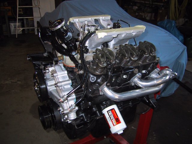

Yesterday I cleaned the lower and middle intake - much nicer:
On the engine:

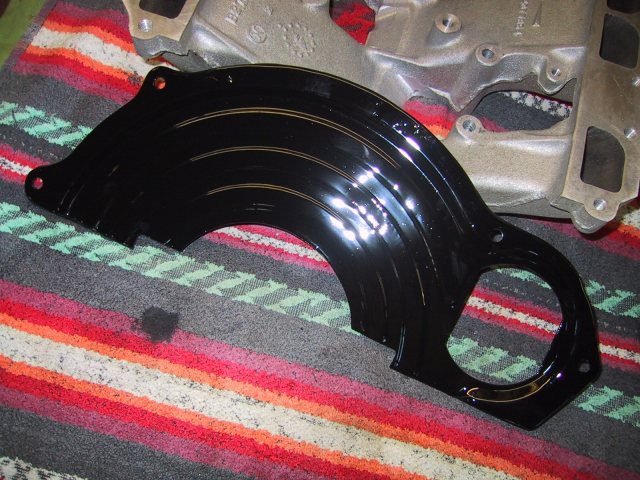

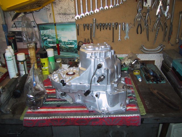

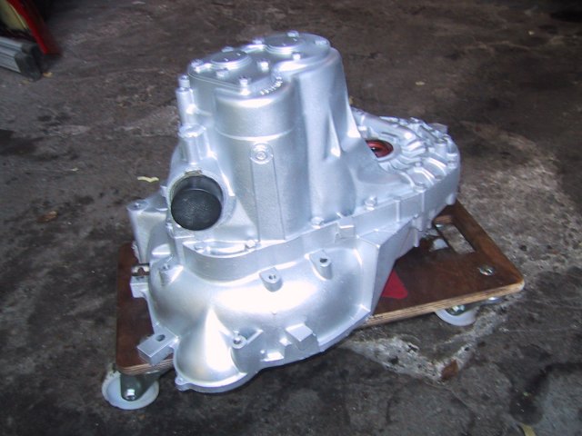

Trying out POR-15 on the tranny splash guard:

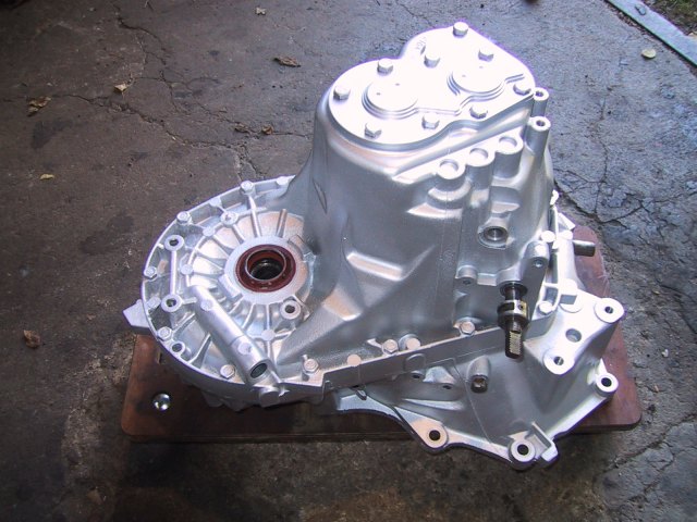

Today: First attempts at cleaning the Getrag:
Stablemate looking on:

did you bother gasket matching and porting your lower and middle intake while you were at it? there's alot to be be desired in the lower intake, and the middle is quite a ways from being gasket matched. It's a relatively easy and straightforward job if you have a dremel.

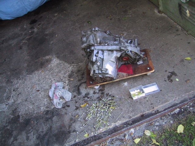

Report this Post10-11-2005 12:05 PM Click Here to See the Profile for yellowstoneSend a Private Message to yellowstoneDirect Link to This Post

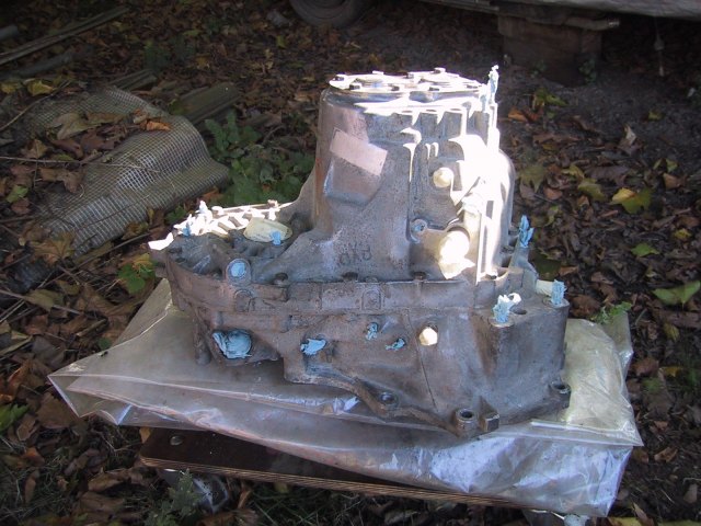

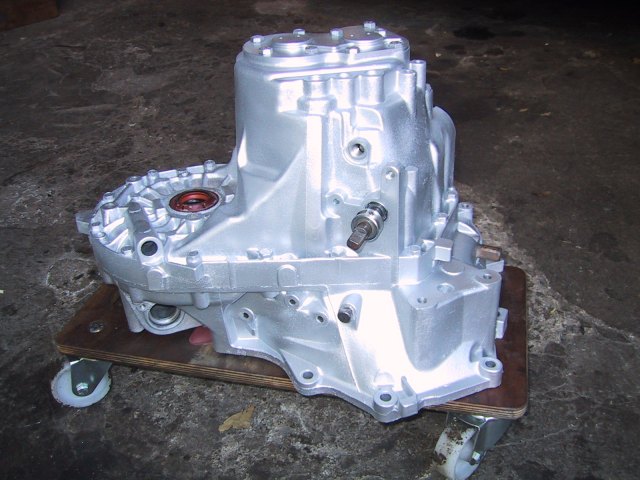

Nothing beats cleaning a tranny with degreaser and cotton swabs:
Paint prepped:
MUCH BETTER!!!!
Ready for further work:

Just that it's not going to last if the prior cleaning wasn't good. I tell you that my hands are f***** up right now from the brake cleaner and the scrubbing...
I know why I got mine media blasted before paint now.
But mine was apart. WOuldn't do it to a trans that is together. For the small cost of a rebuild kit it might have been worth doing while it was out. Well if it is in your budget anyway. I know they can blowout fast.

Report this Post10-14-2005 02:09 PM Click Here to See the Profile for yellowstoneSend a Private Message to yellowstoneDirect Link to This Post

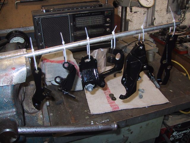

POR15-ing tranny parts.
Result:

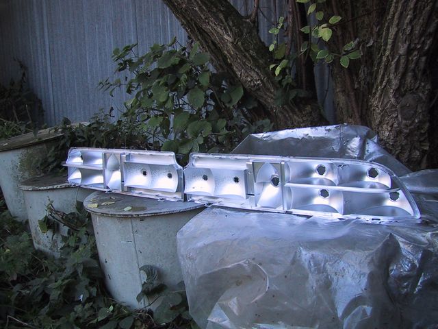

Report this Post10-14-2005 02:13 PM Click Here to See the Profile for yellowstoneSend a Private Message to yellowstoneDirect Link to This Post
yellowstone
9299 posts
Member since Jun 2003

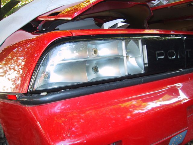

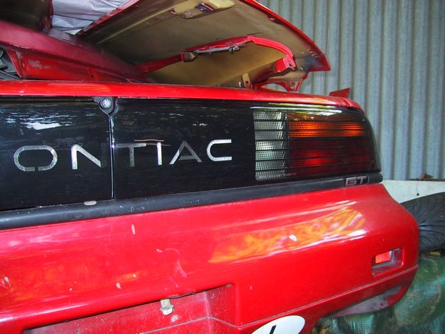

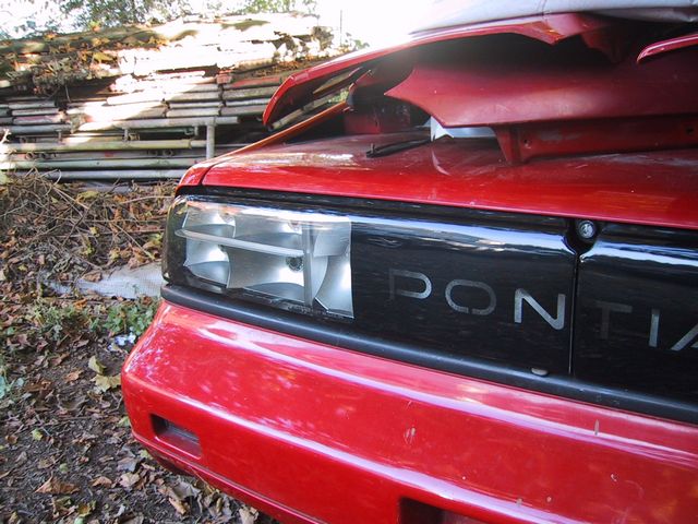

Also working on those:
Result (mocked up on the parts car):

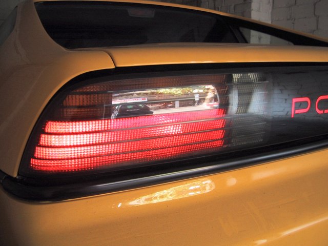

One thought about the taillight without the colored inserts: How about making some clear taillights using colored bulbs? Any thoughts?
[This message has been edited by yellowstone (edited 10-14-2005).]
Custom2M4
Posts: 4414
From: Winnipeg, Manitoba Canada
Registered: Sep 2004
Total ratings: 114
Report this Post10-14-2005 02:48 PM Click Here to See the Profile for Custom2M4Send a Private Message to Custom2M4Direct Link to This Post
I put trailer light inserts in the sockets of my notchie taillights at one point before I did the trans am tails... Its been done a few times on notchbacks, I havne't really seen many fastback tails like that... Maybe they are just too valuable !
Custom Fiero Fiberglass
Fie Ro
Posts: 3735
From: Soest, The Netherlands
Total ratings: 132
Report this Post10-14-2005 03:29 PM Click Here to See the Profile for Fie RoSend a Private Message to Fie RoDirect Link to This Post
I bet youre having fun now . With this setup you could use colored bulbs, you want the colored glass bulbs, avoid the painted bulbs because theyre worse. and then some grill mesh behind the lense, I think black mesh in your case. There should be a few examples on the forum.....but, I also think two round corvette lights behind each stock lense would be really cool. Its what I would have done if I didnt change the rear for other lightunits.

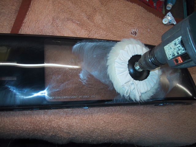

Report this Post10-29-2005 05:31 AM Click Here to See the Profile for yellowstoneSend a Private Message to yellowstoneDirect Link to This Post
With the newly polished taillights, the stock look got some of its appeal back...
[This message has been edited by yellowstone (edited 10-29-2005).]

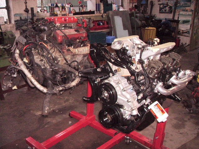

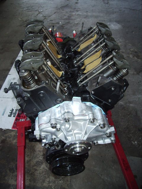

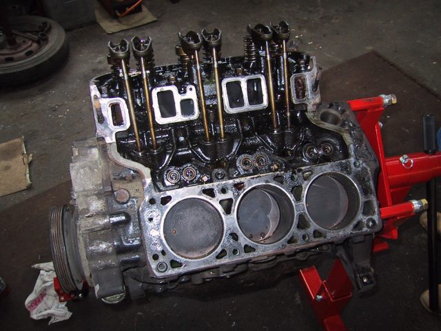

Report this Post11-06-2005 10:37 AM Click Here to See the Profile for yellowstoneSend a Private Message to yellowstoneDirect Link to This Post

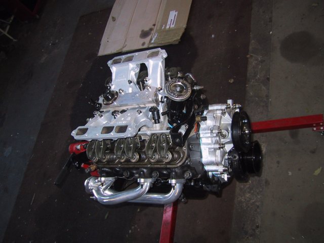

Progress on the 88 GT engine, the engine of the yellow 87 GT is coming our next week after I move the Austin Healey out of the workshop.

Report this Post11-09-2005 11:17 AM Click Here to See the Profile for m0sh_manSend a Private Message to m0sh_manDirect Link to This Post
i noticed you already bolted down the middle plenum, thats going to make it tough to get the valve covers on/off.

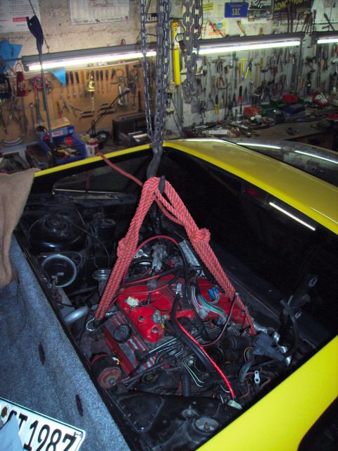

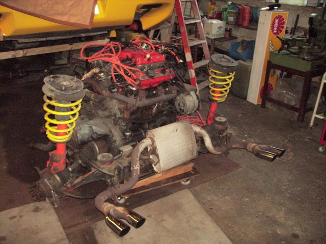

Report this Post11-11-2005 05:37 AM Click Here to See the Profile for yellowstoneSend a Private Message to yellowstoneDirect Link to This Post

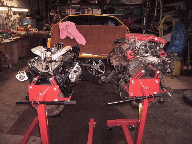

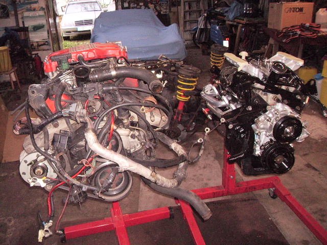

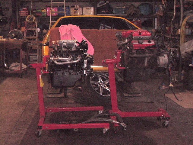

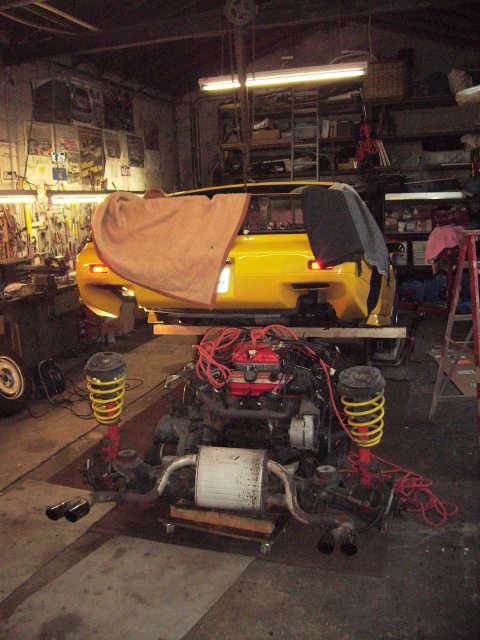

OK, the engine is coming out of the yellow 87 GT today.
Progress pix from yesterday:
Fie Ro
Posts: 3735
Total ratings: 132
Report this Post11-11-2005 12:12 PM Click Here to See the Profile for Fie RoSend a Private Message to Fie RoDirect Link to This Post
blankets, a wrench and a new suit.....nice progress

Report this Post11-11-2005 01:56 PM Click Here to See the Profile for yellowstoneSend a Private Message to yellowstoneDirect Link to This Post
It worked! First time I took out an engine by myself :-)

One question, Why does every one paint the block Black? Not just you but GM does it. You cant see oil leaks if its a black block. Know what I am saying.
That motor and tranny you have is looking good.
BobadooFunk
Posts: 5436
From: Pittsburgh PA
Total ratings: 128
Report this Post11-11-2005 04:47 PM Click Here to See the Profile for BobadooFunkClick Here to visit BobadooFunk's HomePageSend a Private Message to BobadooFunkDirect Link to This Post
Originally posted by magot:
Good job.
exactly!
if you cant SEE problem, youre more likely to take it in. economics old chap!
FieroWannaBe
Posts: 2301
Registered: Oct 2004
Report this Post11-11-2005 08:11 PM Click Here to See the Profile for FieroWannaBeSend a Private Message to FieroWannaBeDirect Link to This Post
other colors than black seem dirty much quicker, thats the reason id do it, red looks cheasy over done, and other colros jsut dont seem "tastefull" usualy. Blakc is sudtle and easy to make clean looking
isnt that a good feeling! wait till you get it back in and start it up!!!!

Progress today:
All as planned :-)

Report this Post11-12-2005 07:05 PM Click Here to See the Profile for avengador1Send a Private Message to avengador1Direct Link to This Post
You might want to get the valve covers on now, before you install the engine, it will be much harder later. Try putting them on with the intake in the way and see how hard it is. The new engine looks great BTW.
