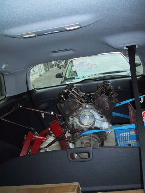

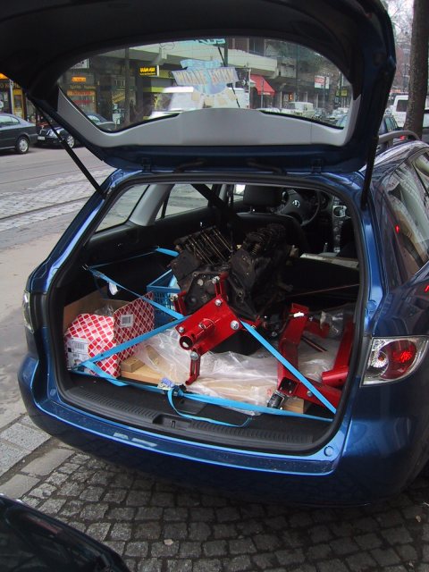

Through personal connections I got the German high-performance tuning company BRABUS to rebuild my V6 for me. Check out http://www.brabus.com. This must be the first Fiero "powered by Brabus" in the world ;-)
Yeah!

This is the Mazda station wagon with the 2 engines... my V6 on the way to Brabus today.
Fie Ro
Posts: 3735
From: Soest, The Netherlands
Total ratings: 132
Report this Post03-19-2005 04:26 PM Click Here to See the Profile for Fie RoSend a Private Message to Fie RoDirect Link to This Post
.....imagine a Brabus tuned midengine Mazda Stationwagon...!
..You look pretty busy for an 'outsourcing' guy nowadays.. ..I hope those Brabus guys secretly put some magic tricks into your engine..
