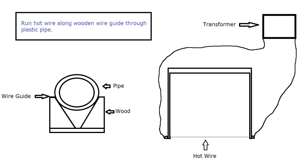

Boondawg
Posts: 38235
From: Displaced Alaskan
Total ratings: 342
Report this Post07-14-2017 08:27 PM Click Here to See the Profile for BoondawgSend a Private Message to BoondawgEdit/Delete MessageReply w/QuoteDirect Link to This Post

Report this Post07-14-2017 09:03 PM Click Here to See the Profile for blackramsSend a Private Message to blackramsEdit/Delete MessageReply w/QuoteDirect Link to This Post
I thought about suggesting a "hot wire" but didn't for some unknown reason.
If one was to do that, I'd suggest using the "hot wire" as a suspension cable so it would be straight (cutting one side at a time) and as it split/melted the pipe, the pipe would drop to the ground.
But, similar to the "plasma cutter" idea, not sure how good of an edge it would leave.

Originally posted by Zeb:
Thermal cutters (hot knife) might work, but on that wall thickness material would probably be slow.
That was along the lines of what I was thinking except... I was thinking aside from the generating enough heat for the wall thickness, there is also the short length rigidity of PVC to overcome. Otherwise the melted plastic would just fuse itself back together. While it won't be as strong of a bond, it could still be enough to make separating the cut pieces difficult.

[suggested hot-wire cutting]
Cutting PVC with a hot wire, hot knife, plasma cutter, etc. is a very bad idea. Heating PVC to the melting/smoke point releases carbon monoxide and chlorine gases (among other things), which can then react to form poisonous dioxins and/or phosgene gas. The production of phosgene is accelerated (i.e. catalyzed) by the presence of heated copper, iron, or carbon.
Urethane plastics are even worse, evolving poisonous hydrogen cyanide gas when heated above their melting points.
