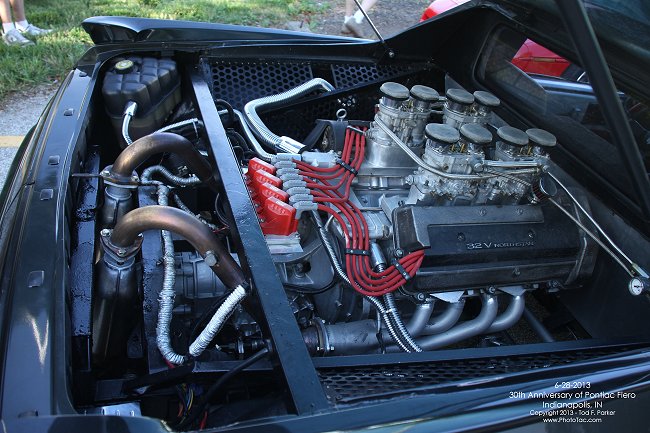

Reminds me of this Fiero seen at the 30th anniversary

That Fiero.... Kinda wondering what that rear glass came from, or if it was a custom made window... Also think if there were a way to make the quarter windows clear and functional (think 80's truck quarter windows that popped out) it would make for an interesting, seamless look.

Third Gen Camarobird. If I remember correctly Bubbajoe (sp?) had a build thread on it. I'll see if I can find it. I remember it was stretched for the engine orientation, you can see this most noticeable between the door and rear wheel.
Edit: I found the thread. I didn't narrow down the exact point where he starts the install of it but this link will get you right into the area the install is being done out of the 76 page thread.
https://www.fiero.nl/forum/F.../HTML/000007-16.html
Oh and the stretch was 12" to get the engine and the glass to fit like that.

Looks like excellent access for tune ups, beautifully done! Wonder what the 0 to 100 time is?

Forgive me for my laziness and unwillingness to go through 76 pages to find the answer to this question, but how does the transmission turn the axles on a longitudinally mounted, rear engine? Thanks to anyone polite enough to answer.

By transmitting it's rotational output through a differential obviously .
Now in all seriousness, it works just like any rear wheel drive front engined vehicle, just the rear axle differential is part of the transmission. Since the transmission uses gears to spin the output shaft at different ratios, it doesn't matter where along that shaft you put the differential so long as it doesn't interfere with the transmissions gears. Here's a cutaway view of a Porsche transmission to give you an idea. I am not sure what transmission was used in the Fiero above, but I beleive Porsche was one that was talked about and possibly used.

The Fiero should have been stretched like that from the factory.. Nothing else so you can work on the damned back 3 ( or 4 if you are fancy ) plugs. ( grrr )

Yeah the Torornado transmission has been used in some longitudinal swapped Fieros. I've seen it mentioned and I recall at least one Fiero for sure but I think there have been others. However, for that particular Fiero, the first post contains this:
12 inch stretch wagon concept with N* / Porsche transaxle / Webber fuel system
So assuming nothing changed, it should be a Porsche transaxle in that one. BubbaJoexxx has since sold it so I have no idea what's been done to it since then.
