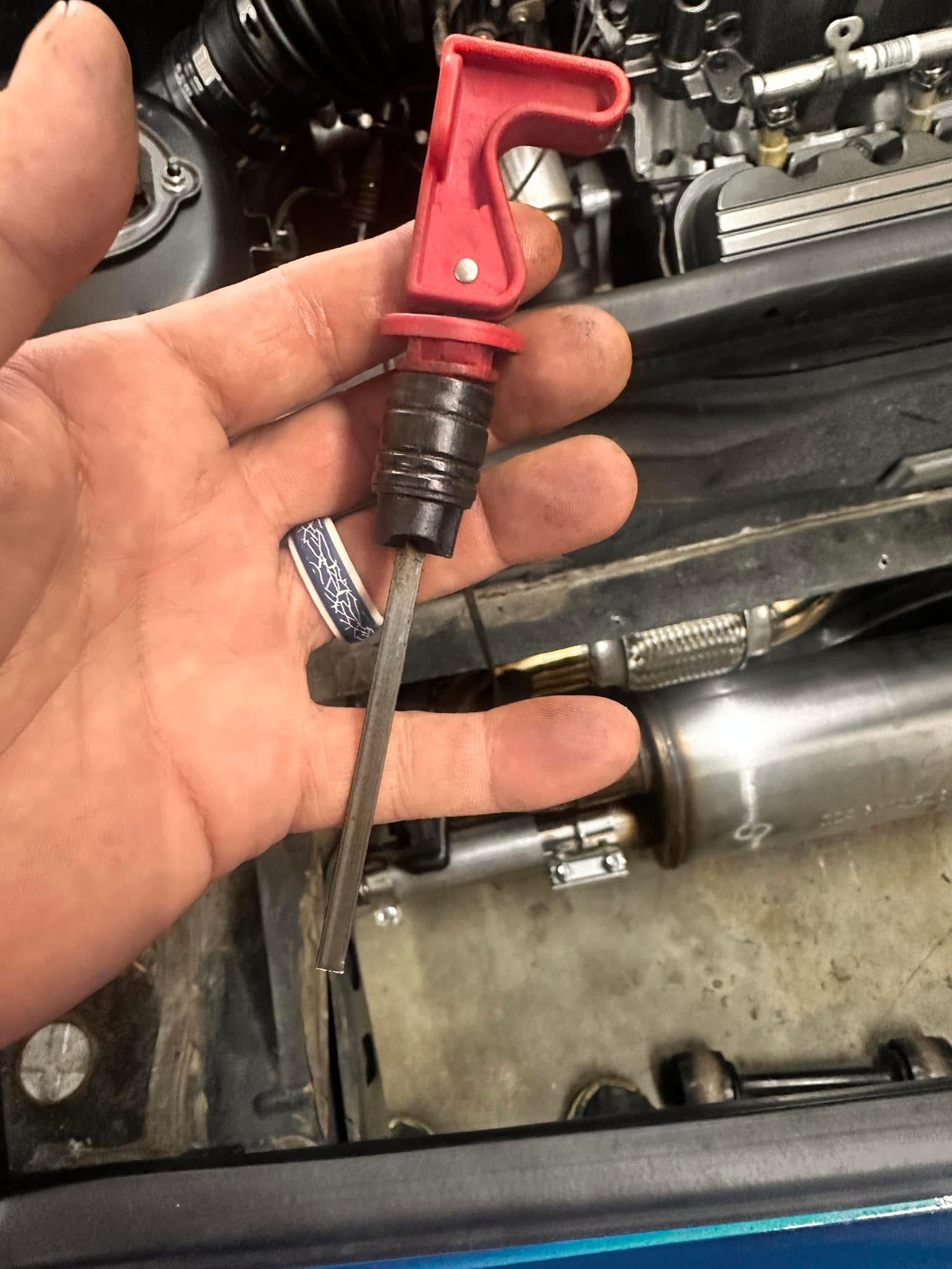

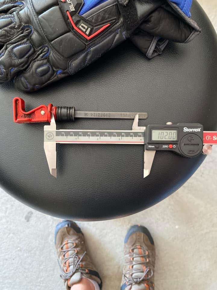

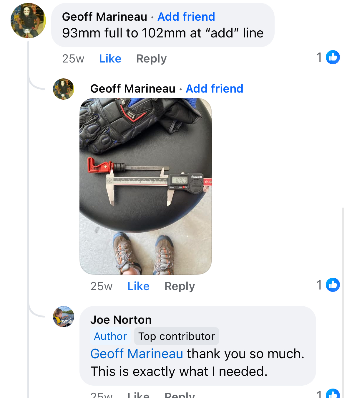

If you can't find one, you can use any folding GM Transmission dipstick and cut it down. I had to do this. I notched marks for full and low based off a measurement I got from someone.
I'll try to add pictures later.

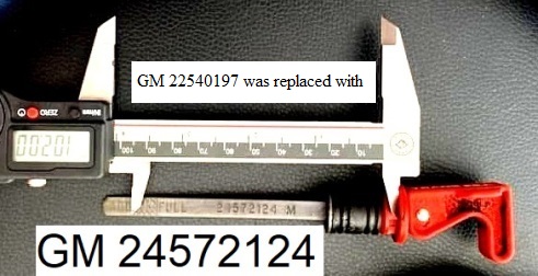

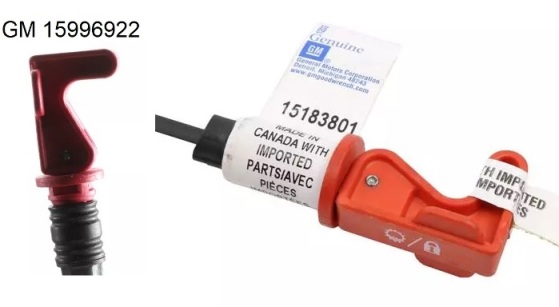

Transaxle dipstick (revisited) by midengineracer
https://www.fiero.nl/forum/...090219-2-079994.html
GM Replacement: 24572124 BUT it has been discontinued too...
Perhaps these can be cut down......?
