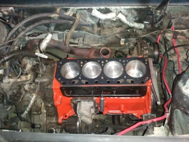

Started pulling apart the bone stock duke in my 88 today.
Shes been burning oil and smoking sense I bought her. I have finally got to a point at my job where I can
afford to give my sad little fiero the proper care it needs.
While I was pulling the intake and exhaust off, I found the the stock head gasket was in
good shape. The stock exhaust header had the normal cracks on both sides. What I did not expect was was for one side to fall off in my hand.
The cylinder walls look and feel great. the bad thing is that I could shave in the refection. Got a new glaze braker for that.
Heres the other pics before I start cleaning. Still need to pull the rest of the block, but I'm trying to take my time. This is not my first engine, but I still want to make sure I take my time and do things right. Going with sealled power pistons and moly rings.
1988 Fiero 2.5

Is that blue stuff cooked oil?
[This message has been edited by Gall757 (edited 10-26-2014).]
Zeak
Posts: 108
From: Lake of the ozarks MO
Registered: Dec 2013
Report this Post10-26-2014 07:57 PM Click Here to See the Profile for ZeakSend a Private Message to ZeakEdit/Delete MessageReply w/QuoteDirect Link to This Post
Afraid so. Oil was getting into the combustion chamber and there was so much blow-by that I had to install a oil catch can on the valve cover vent.

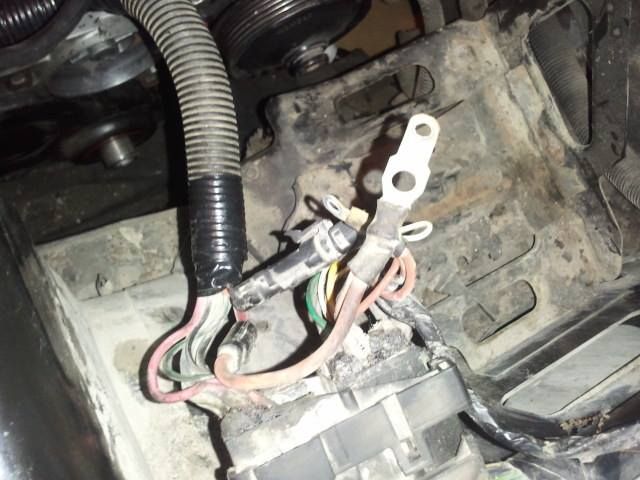

Pulling the 2.5 from the top was not to bad after I removed the intake, exhaust, and the head.
Going to soak her in gunk and then pressure wash everything thats external.

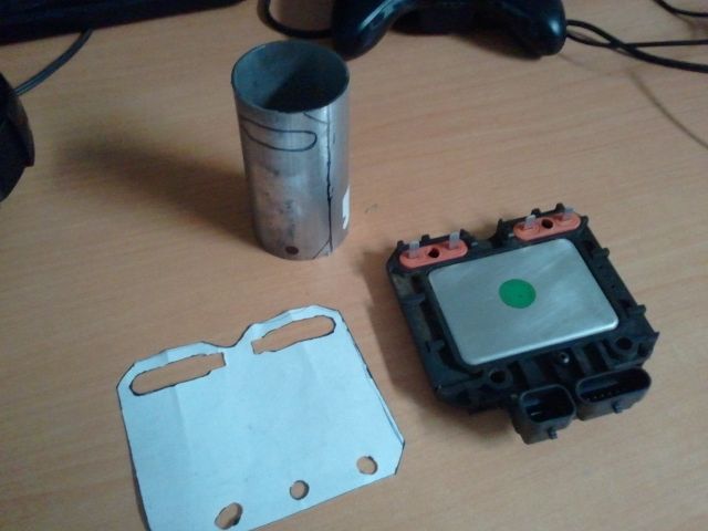

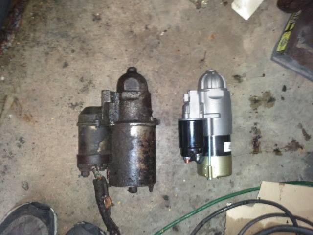

Broke the darn crank sensor on the back of the coil packs. Guess it was time for a new one. My serpentine belt tensioner had a new pulley on it but I guess it was a little loose as it was grinding on the plastic that covers the spring. Can that be rebuilt or do I haft to buy the hole thing?
Did the pressure washing this afternoon after I got off work and am going to take apart the internals and wire-wheel the block and head.

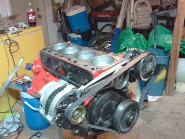

Got some more work done.
Not sure how old the bearings are, but they look good.

Report this Post10-29-2014 08:09 PM Click Here to See the Profile for theogreClick Here to visit theogre's HomePageSend a Private Message to theogreEdit/Delete MessageReply w/QuoteDirect Link to This Post
the belt arm worn then replace tension assm.
RockA etc have them.
Should have metal "spring" and you move it to new tensioner but many are missing. I Think just make noise when pulley/tensioner are bad.
Arm is pointing to where the spring mounting point. Not covered in cave...
See my Cave, Serpent Belt
DIS brick look like missing PIM shield.
See my Cave, DIS Ignition
rebuild an 88 then first carefully check balancer/oil pump assm.
88+ is known for balance assm problem that kills whole engines.
Check Jasper etc rebuilt engine. Likely cheaper and has a warranty.

Your defiantly right about the shield missing. Looking into getting one from my local pick and pull.
As for the pulley, I'm just going to use an adjustment bar and run it like the 84 2.5.
Thanks for all the great info in the cave.

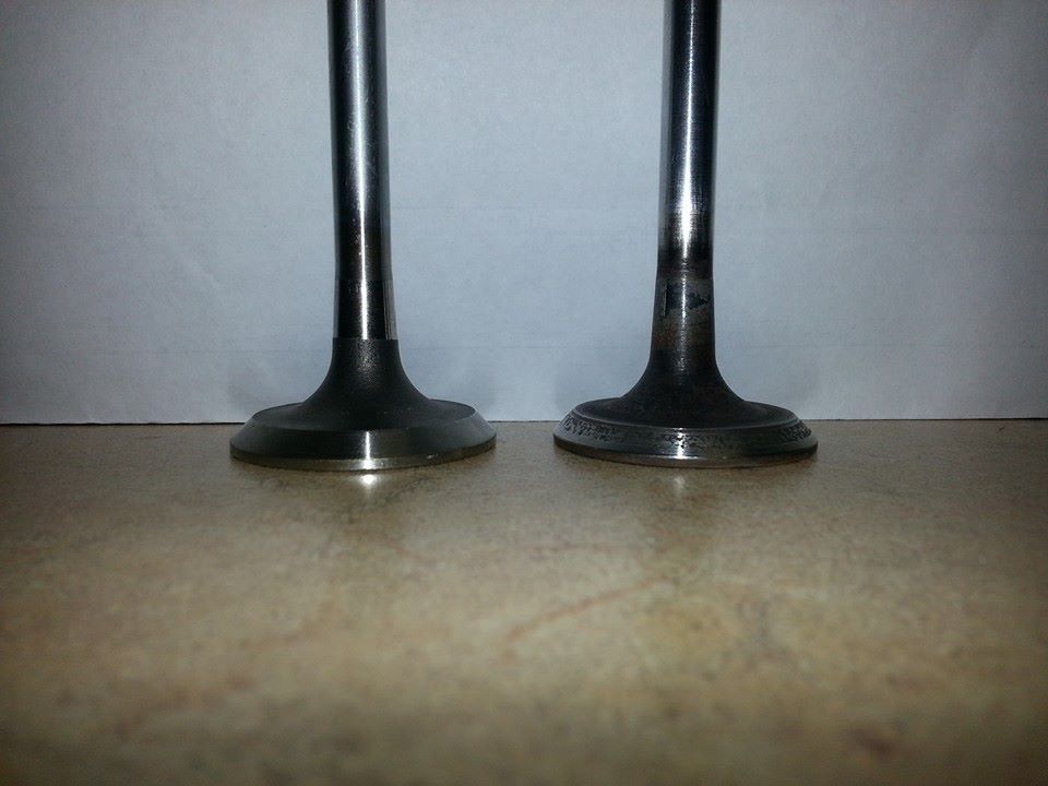

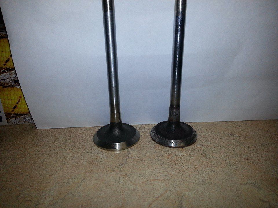

Tried to clean up my old valves. All 4 of the exhaust ones are shot. New ones will be in within 4 days....
The head was checked over and aside from LOTS of carbon buildup. Its in good shape. Still trying to source a proper shield for the coil assembly.

It may be a camera trick...but look at that wear on the shaft. It looks like .010!

I think that's just some sort of coating they put on the valve. The more narrow point measures the same as the top and bottom of where the keepers go on the other end. I'll compare them to the new ones when they come in.

Went to the parts store and paid $2.99 for a small exhaust connector.
It's 18 gauge galvanized steel. Made a paper tracing of the pim and them cleaned it up and traced it onto the connector.
Going to cut it down the back side and unroll it and then cut the holes. (It's hard to find galvanized steel for cheap around here)
On the orange rubbers that seal the coils. I only have one per side. How thick should they be? There only as thick as a nickel at the moment.
Thoughts?

Got the shield cut out, but I'm not happy with it. It looked great until I tryed to do the more detailed cuts for the coils to connect to.
I'm thinking I need a dremel, not a hand drill and chainsaw file. lol

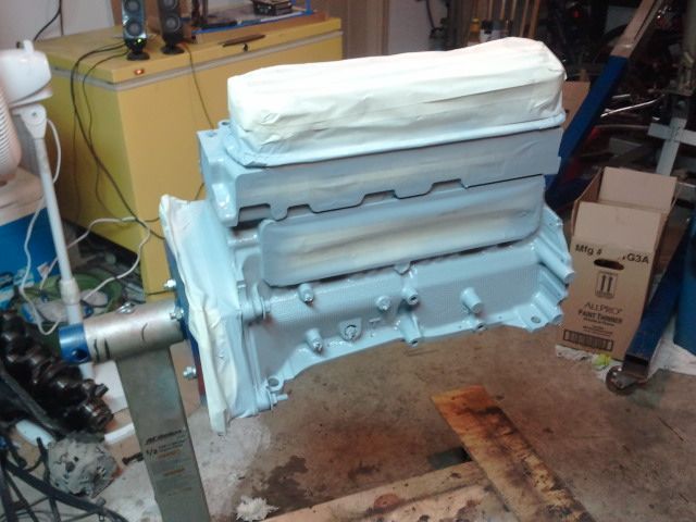

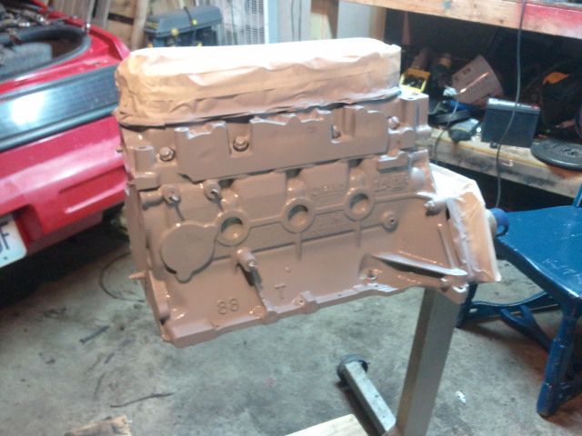

Got everything cleaned up and the first coat of bonding primmer on.
(sat some lug-nuts in the sparkplug holes to keep them clean) lol

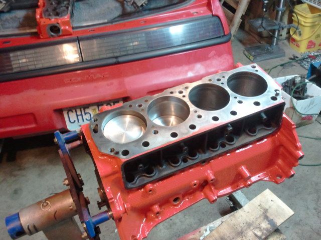

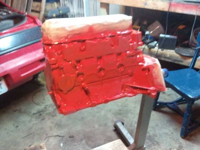

Report this Post11-13-2014 03:21 PM Click Here to See the Profile for ZeakSend a Private Message to ZeakEdit/Delete MessageReply w/QuoteDirect Link to This Post
Got my 2nd coat of chevy orange curing.
(sorry the #2 pic is blurry.)
Dose anyone know if and how the bottom end is vented?

Made a little progress tonight before the wife started yelling about the noise.

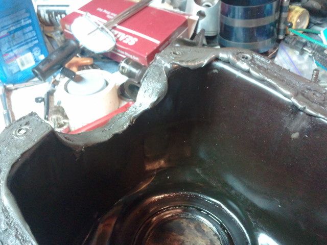

Doing some more cleaning. Wanted to show what the result of putting too thick of a bead of rtv on the oil pan. It did not fully cure and leaked alot.
I was also very surprised at how much dirt, dust, and rocks came out of my alternator. Still produced a charge....
[This message has been edited by Zeak (edited 11-17-2014).]

Getting the last 2 pistons installed and I have been slowly moving the crank assembly to insure nothing was binding. Now that the bottom end is all together. It seems stiff. Nothings grinding that I can tell. I used a plasta gauge on the crank and con rods and all was well within spec. Thoughts?

So this might work.
Got a belt thats just over 48'' long. Made the hole on the tip of the old tensioner wider so It has a bit of adjustment.
If it dose work great. If not then I'm only out the price of the shorter belt and I haft to buy a new tensioner anyway.
Going to install the oil pan in the morning and let the rtv set up for a few days before it sees any oil.

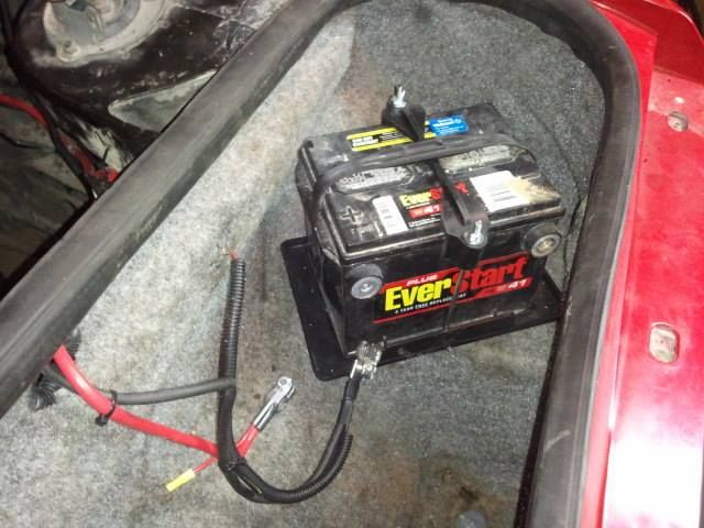

Got my battery tray mounted and the new cables ran.
Edit- not the battery I'm going to use. It's a dead one I used for fitment.

Slow progress.

Motors back in the car, looking good

Heres a side by side of my new gear reduction starter next to what I can only assume is the factory starter. (still worked, certainly had enough lube from my bad oil pan seal.)
Got most of the wiring back on. the dog-bone went on without much hassel and I reran the new battery cables so there not touching anything that gets hot or moves.

Why is your battery in the trunk?
Zeak
Posts: 108
Report this Post12-16-2014 10:26 AM Click Here to See the Profile for ZeakSend a Private Message to ZeakEdit/Delete MessageReply w/QuoteDirect Link to This Post
Why not? It's out from under the deck lid vent, so that will have much better airflow out. (remember that air comes up from the bottom of the car, not in.)
It's also not exposed to the snow and ice during the winter.
I'm not building a track car. A 96hp iron duke will see to that. I'm 6'2'' and 240 pounds. I think the battery in the rear trunk will not make too much of a difference.

Wanted to ask what this connections point is....
The plastic bit with 2 bolt studs needs to be replaced as they both spin when you try to put the nuts on.

Report this Post12-17-2014 08:01 AM Click Here to See the Profile for olejoedadSend a Private Message to olejoedadEdit/Delete MessageReply w/QuoteDirect Link to This Post
That is the Battery Junction Terminal.
The same style is used on several GM models from the 80's and 90's.
