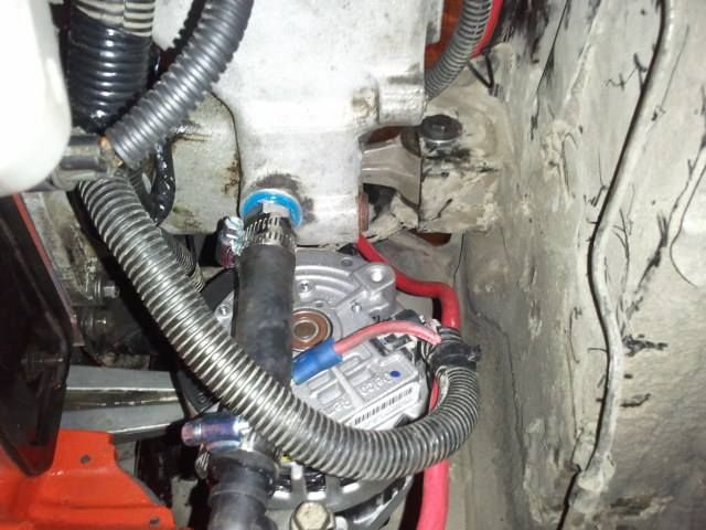

Got some more items installed. I made sure to seal the bolts that hold the DIS brick to the block.
You can still somewhat see the new shield that I made behind the packs (Thanks again ogre!)
This pic is of the bottom of the intake and the back of the alt.

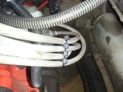

Also tryed the David freiburger (from motortrend) spark plug wire separator.

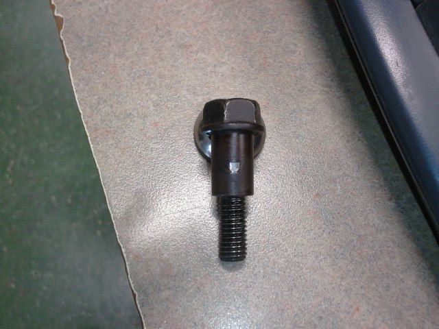

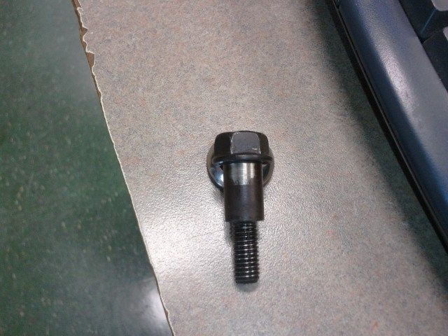

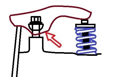

Well crud. Was not able to get shims yet, but as I removed a rocker stud, so I could get the proper size.
I noticed that this bolt has normal wear on one side from the bole shaped washer, But it also had scaring on the other from the rocker making direct contact to it. It dose not look like much, but I don't want it to get any worse and brake the bolt or something.
If I'm not wrong, The shims would only increase the amount of contact. Right?
Should I still do the shims and just file the rockers or is something else wrong here? All 8 bolts have different amounts of the same markings.
Back side, normal wear.
Front side scaring
Doodle to show where it's hitting When the valve is fully open.

Too thick "shim" and you can break things. Washers as shim are too thick many times.
Most engine Exhaust valves grow more then intake side. Is more easy to cause problem by shimming exhaust.
Some wear is normal. The ball often rotates to keep wear even. Many aftermarket balls have oil groove too.
Minor Rocker hits the bolt is common.
see https://www.fiero.nl/forum/Forum2/HTML/103494.html
