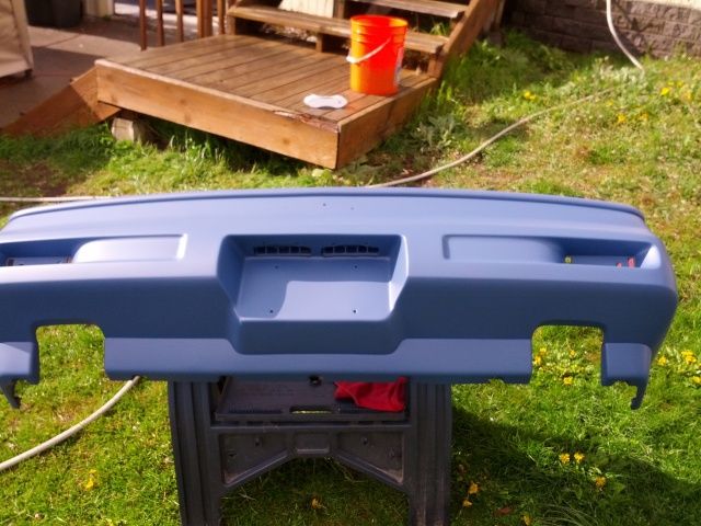

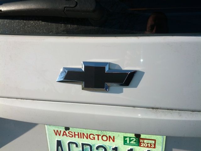

So, since I just ordered a sprayer and 3 gallons of PlastiDip, I figured I'd better practice a bit. So, I went to the local Walmart and picked up a couple of cans of the black to do the emblems on my 2012 Chevy Sonic DD. This stuff is really pretty awesome.. I also sprayed my spare dot-matrix gauge panel trim as a test of interior pieces..
I think an interior color change is coming too now..
Here's a shot of how the emblem came out:
It used to look like this (ugly on a white/black car):
For those of you who haven't heard of plastidip, check out DipYourCar.com
I'll be a guinnea pig for you all.. Funny though, it looks like quite a few fiero dudes are active on the forums there. Personally, I can't think of anything better for a plastic car, especially since it flexes, and if you don't like it, peel it right off.

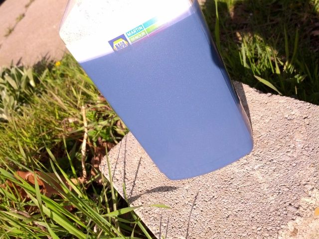

Well, got my color mixed up! Looks awesome. It's almost the exact periwinkle blue I'm looking for. I might have to throw another purple pearl in, and maybe another can of white to lighten it up a shade, but it's really cool looking. Now I just have to finish up the body work, and pull panels to spray.

Color was a bit too dark, and not frou-frou enough, so I spiced it up with 2 more cans of white and 100 gm of violet interference pearl.
Perfect.

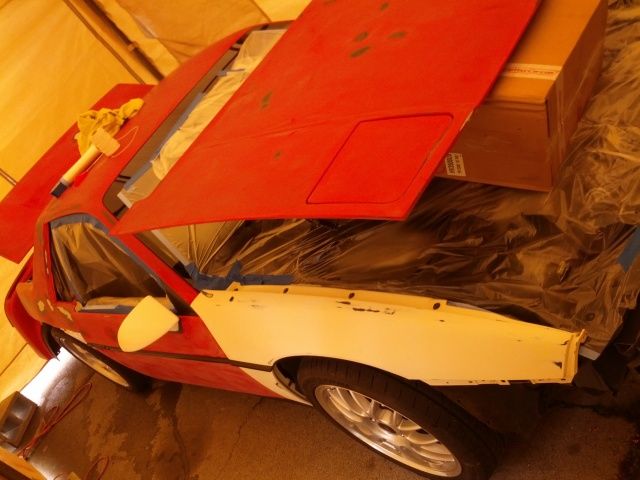

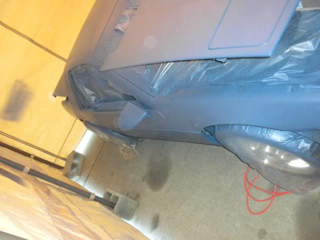

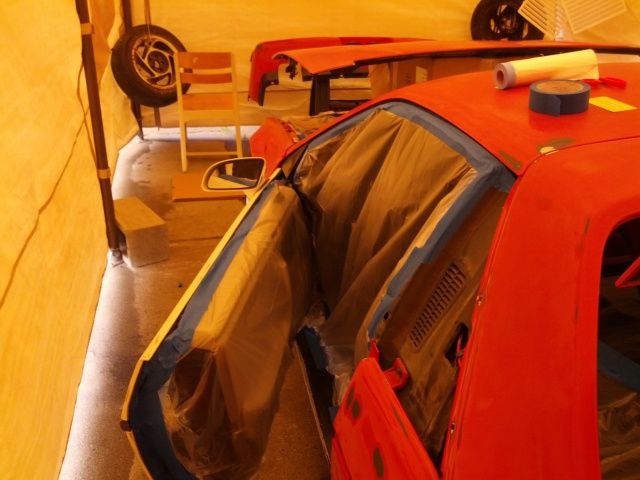

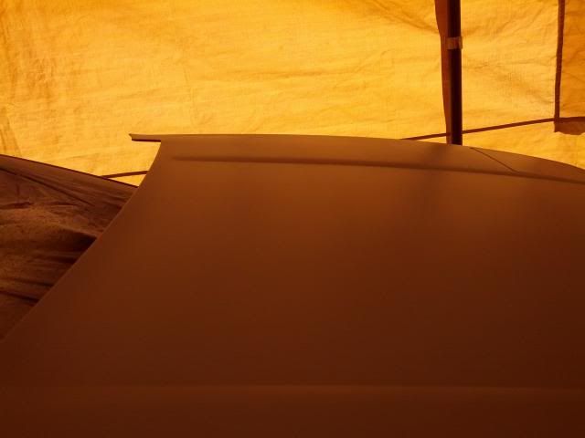

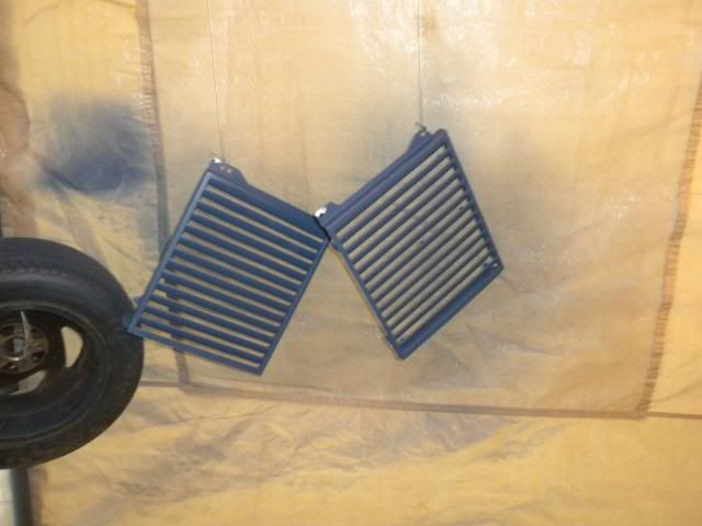

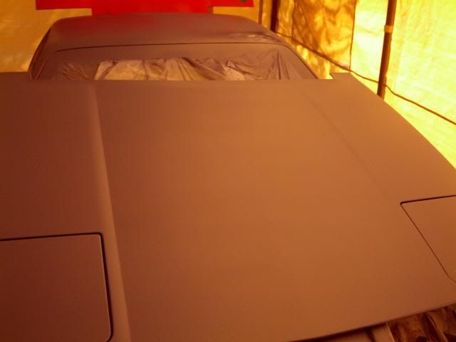

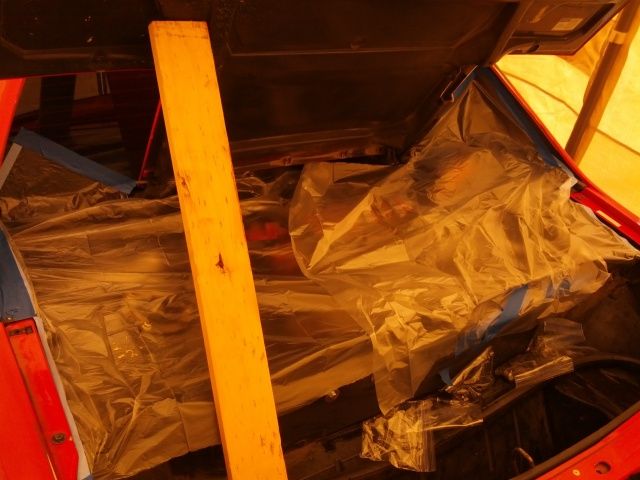

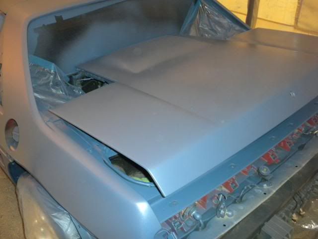

Ok,
So, I put up the super-paint-tent that Joe lent me, and spent yesterday sanding and disassembling the bumpers, tail light, and sail panels.
Today, I cleaned and prepped, and was just about to start spraying when the hugest thunderstorm of the year started rolling through. I didn't want to risk the tent being perfectly waterproof, so I dragged the bumpers in to the garage and painted them. Turned out AWESOME!.
Can't wait to finish the rest of the car..
This Plasti-Dip stuff is really cool, and the gun they send with the kit work really nicely. Easy to adjust.
I'll do the rest of the car as soon as I get a break in the weather..

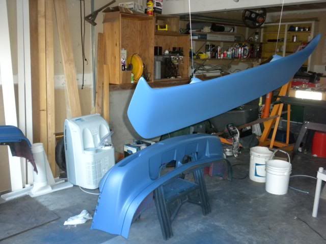

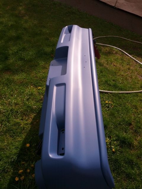

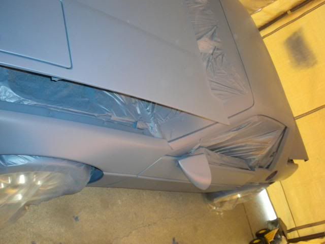

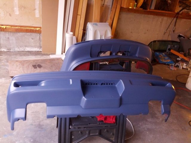

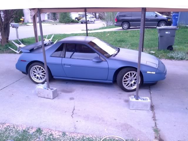

Some more progress. Got about 4 coats on the car, so far so good. I need to go back over it one more time with a nice heavy coat to even out the satin sheen, and I should be done with the blue. Then, I'll wait for a day or two before taping to shoot the black for the kick plates and trim.
Started running out of light, so i had to clean up for the night.

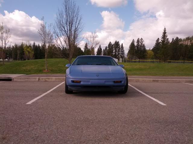

aaronkoch
Posts: 1643
From: Spokane, WA
Report this Post04-27-2013 09:52 PM Click Here to See the Profile for aaronkochClick Here to Email aaronkochSend a Private Message to aaronkochEdit/Delete MessageReply w/QuoteDirect Link to This Post
aaronkoch
1643 posts
Member since Aug 2003

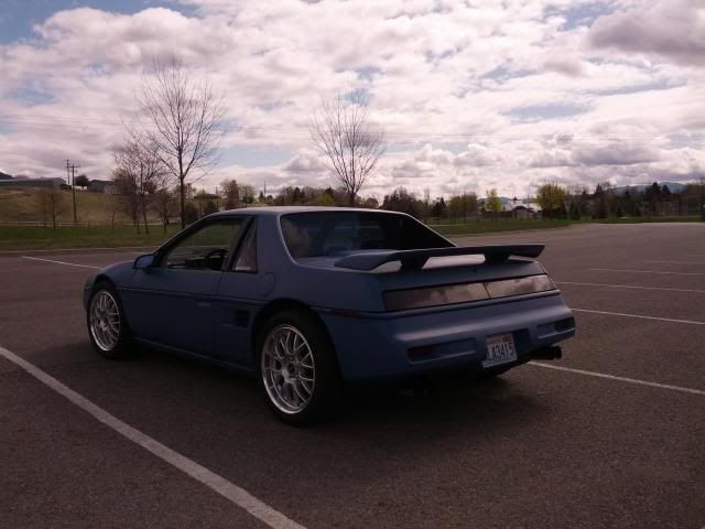

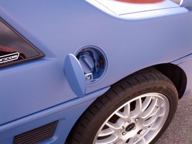

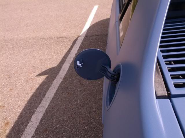

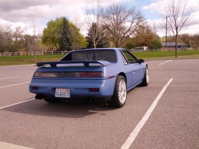

Just got the car put back together.. I'll take some better pics once I've cleaned it up. Really happy with it.

I love the finish plasti-dip gives you but I admit I wasn't sure about the blue. looks really good man, nicely done

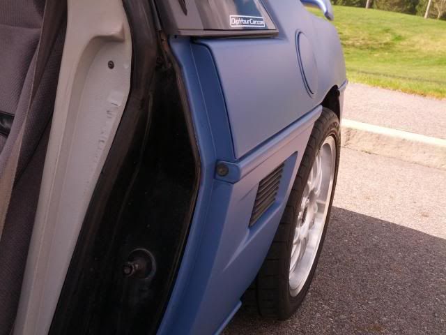

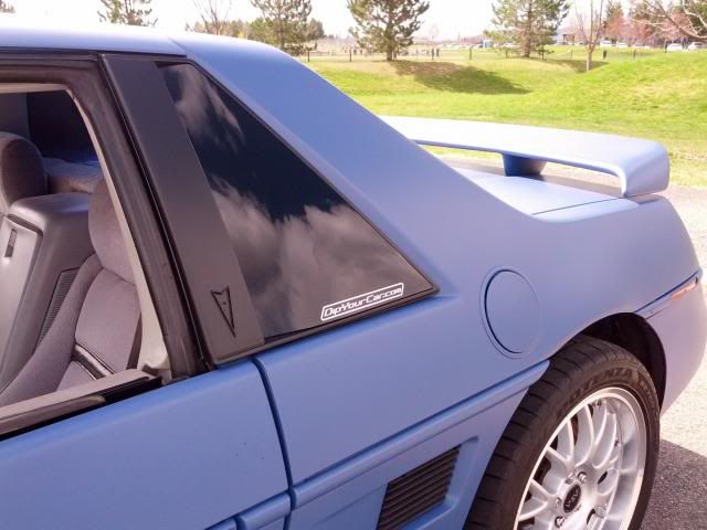

I wasn't sure either, but that's what's fun about the plastidip. If you don't like it, or you mess up, you peel it off and shoot another color.
As it is, I already had to redo the roof panel, the air hose popped off the earlex spray gun, and dribbled dip on the roof. I waited about 20 minutes, peeled it off, and shot another couple coats on.
It's pretty forgiving stuff. I've never really painted anything before, and with $200 of dip and pearl can get this kind of result, that's neat.
There are some small flaws which I'll touch up, and note to you all, If you plan on doing this LEAVE THE PANELS ON the car:
This stuff is not as durable as paint, and until you get a coat of spray wax on it is pretty susceptible to scuffing and scratching, so when you go to put the pieces back on the car, you are likely to scuff the pieces on install.

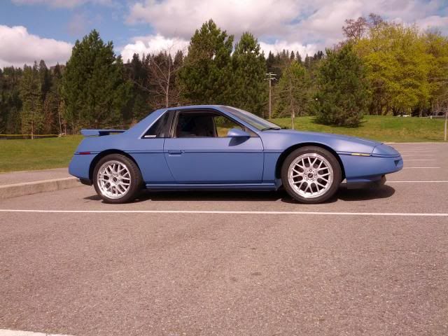

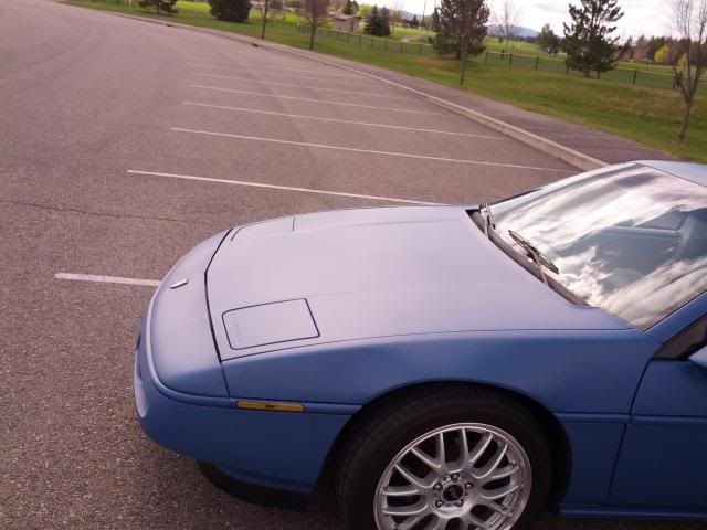

Report this Post04-28-2013 01:46 PM Click Here to See the Profile for aaronkochClick Here to Email aaronkochSend a Private Message to aaronkochEdit/Delete MessageReply w/QuoteDirect Link to This Post

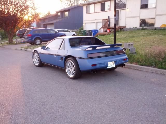

aaronkoch
1643 posts

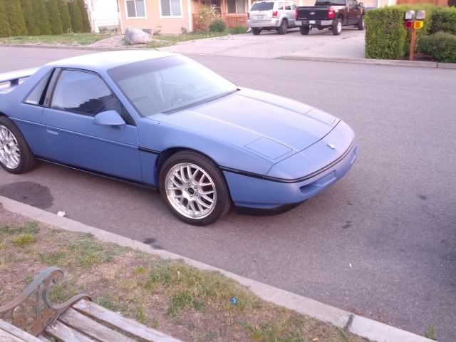

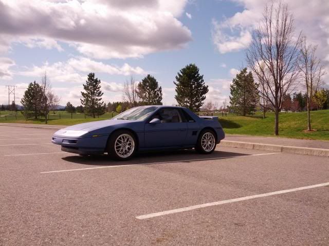

Almost done, but close enough to post pics.
Still need to spray the kick plates, but the wind is insane lately, and I don't wanna mess up the rest by spraying them.

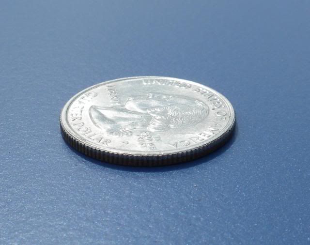

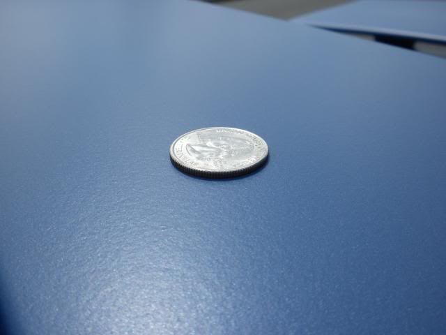

aaronkoch
Posts: 1643
From: Spokane, WA
Report this Post04-28-2013 04:54 PM Click Here to See the Profile for aaronkochClick Here to Email aaronkochSend a Private Message to aaronkochEdit/Delete MessageReply w/QuoteDirect Link to This Post
The best description of the texture by feel is the rubbery back of those older motorola phones, or the silicone handle of a cooking utensil.
Here are a couple of close-ups:
thanks, looks good.
You can see the pearl flecks in these shots. I bet the photos don't do it justice. There is a blue I was testing that photos can't even show how it looks in the sunlight.

I decided I wanted black rockers and belt trim, so this weekend I pulled off the rockers and swapped them for the unbroken ones off the old white parts car. Then, tonight, I masked off and plasti dipped the trim. Ran out of daylight, so I'll have to finish later. It takes 5 times longer to mask than it does to spray...

Report this Post05-08-2013 05:01 PM Click Here to See the Profile for qwikgtaClick Here to Email qwikgtaSend a Private Message to qwikgtaEdit/Delete MessageReply w/QuoteDirect Link to This Post
WOW!! That puts my Krylon "spray paint" job to shame. Great job, love the color, thats almost the exact color I was thinking about doing my other Fiero, only I was going to do it with a wrap instead of paint. Now that I see the color on a Fiero, I really love it.

aaronkoch
Posts: 1643
From: Spokane, WA
Report this Post05-08-2013 10:47 PM Click Here to See the Profile for aaronkochClick Here to Email aaronkochSend a Private Message to aaronkochEdit/Delete MessageReply w/QuoteDirect Link to This Post
Got the belt line finished. As soon as I have time, I'll put on my new dew wipes and touch up my goofs. Other than that, the exterior is done.
On to the interior!
a question: why did you spray the trim, couldn't you just peel off the dip?
i was thinking of doing the same, painting the trim and just peeling it but if there is a reason why it shouldn't be done that way please explain.
thanks
aaronkoch
Posts: 1643
From: Spokane, WA
Report this Post05-09-2013 08:11 PM Click Here to See the Profile for aaronkochClick Here to Email aaronkochSend a Private Message to aaronkochEdit/Delete MessageReply w/QuoteDirect Link to This Post
That would've worked, but I had to sand down the trim to address peeling paint from the previous owner/paint job. It would've looked pretty bad..

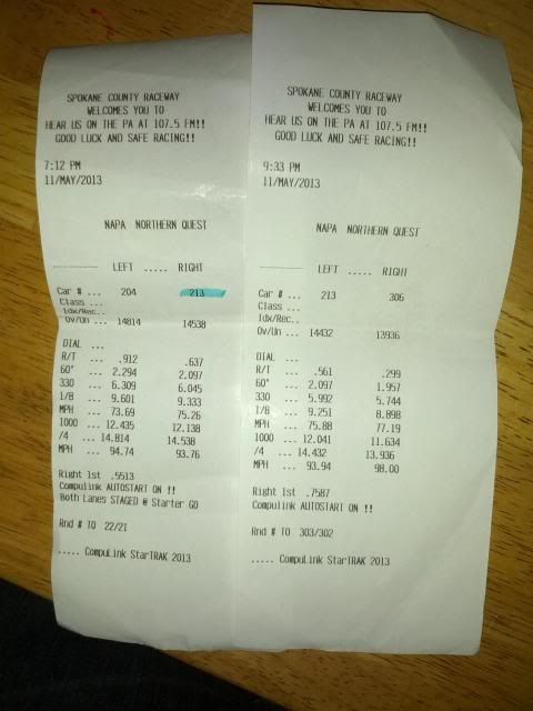

(copied from my 1/4 mile post here for reference)
Did my first runs in the car, found it surprisingly hard to launch just right on a really sticky track.
In any case, my '88 coupe with a 3800 series II NA / 4 speed muncie ran a 14.432 @ 93.94 best for the night.
The good thing, I guess, is I'm pretty consistent.. all my runs were within 15 hundredths.
Spokane county raceway is at 2600', and last night were at a density altitude of >3200 feet.
