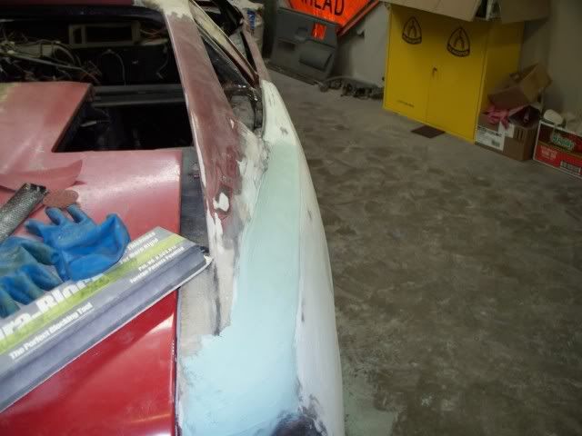

[snip]...we are working the rear hips to get them the way they need to be abd we are close on them once we get that part done we will be able to take molds...[snip]
Originally posted by Amida:Before final sanding a design review with silver vinyl wrap was done on one side to better see how the contours & lines are shaping up...
It's DONE! it is in primer and will be boxed up to send to Fiero Fiberglass for the parts to be made and sold. [snip]
Add 'em all together with more personal touches and what do you get? I'll let you try to figure it out.
[This message has been edited by ALLTRBO (edited 03-08-2011).]

I also specified that I did not want the decklid to be notched. On the turbo side we had both decided that there was no other way, but now both sides are notched and I didn't get any say in the matter.
He did take off the cost of the failed low-mount alternator bracket attempts.
Here are the issues that I need to address with the alternator having been mounted up high:
* I will need to reinforce the decklid as simply filling in the space in the notches won't provide additional strength, but it's been done. Struts would help, as when the decklid is closed they push rearward on the decklid and not upward like the factory torsion rods. It's when it is closed and thermally cycling that I'm concerned with, not when it's open.

Here are the rest of the pics that I took this weekend...
Some are random, some show issues, none in a particular order. I'm too tired to try to sort through them.
