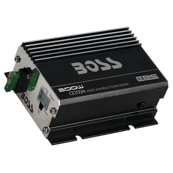

Would this one be any good to use with the Parts-Express Sub or would it be too much? That kicker is non-existant now days.
200W Class A/B CHAOS EPIC Series Mini Monoblock MOSFET Power Amplifier
Should be OK. Tang-band sub is rated 40 watts RMS (80 max). This amp is 100 watts RMS (same as Xtant I used).
But I don't see that it has any Gain adjustment, so not sure how you'd adjust it to balance with the rest of the system.
