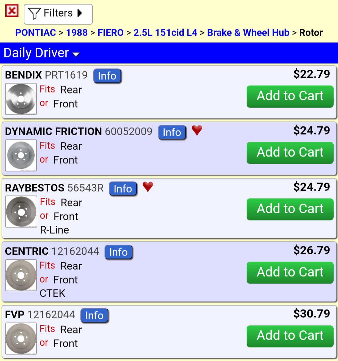

Hey guys, still working on my 88 project. Sorry if this has been asked a million times but I wanted to confirm something real quick. I have some really rusty rotors and I think it might be best to just replace them. (Calipers are another story...lol) I know the 88s have weird brakes and I've heard every part of them are hard to come by. I went to rock auto for shits and giggles and found that they have rotors that say they work for the rear or front. I just wanted to confirm if this was true or not? Should I grab a set or will they not fit? The fiero store has a full set but they're waaaay more expensive than these ones. Thanks for the help as always!
That wouldn't make sense to me. Rock Auto does get a little weird when there's 1-year only stuff.
As far as I know... aren't the front Fiero brakes (1988 only) vented? ... and the rear brakes not? They definitely couldn't be interchanged if that's the case. I've never had an 88.

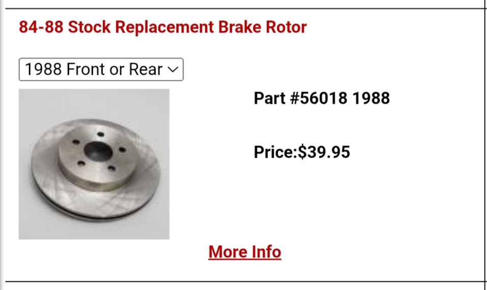

Yeah I and my family have been burned by rock auto before (as much as I love them and their magnets 😂) I need to have a better look at my rotors, I'll check the fronts soon. Currently have the rear in the air to get the tank dropped again to replace the sending unit.
Now that I'm checking, the fiero store does have rotors for "front or rear" maybe I'm in luck! It would be nice if I could pay 100 bucks instead of 190 for all 4 rotors and shipping.

Yes, both front and rear are vented and the same size......
I went for RAYBESTOS 56543R
Brake Rotors, Vented, Four ($108)+($41 Ship)+($15 Tax) = $157
Damn, that's pretty awesome. I don't even think my Crown Victoria has vented rear disc brakes, and it's like a 5,000 pound car.
If they're just rusted (not gouged, not warped), cleaning up the rotors with a wire wheel would be my preference.
Incorrect. '88 rotors are vented on all four corners.
For anyone who really needs to replace their '88 rotors, This is a very helpful thread with the intriguing option of using '97 Cavalier rotors.
