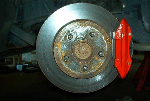

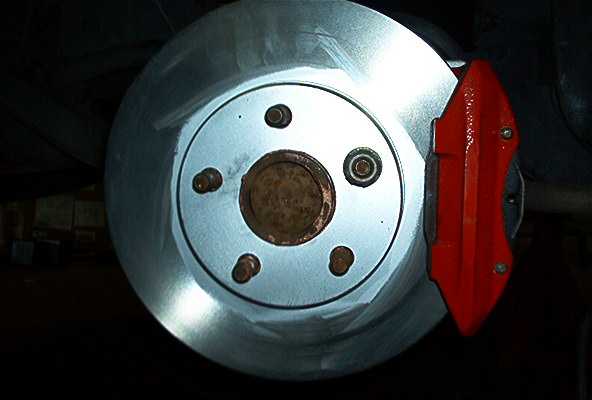

I just finished installing 97 Cavalier rotors at the 4 corners of one of my 88's.

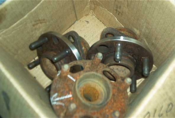

The rear was basically a direct swap, but the front required some machine work to the front hubs.

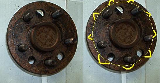

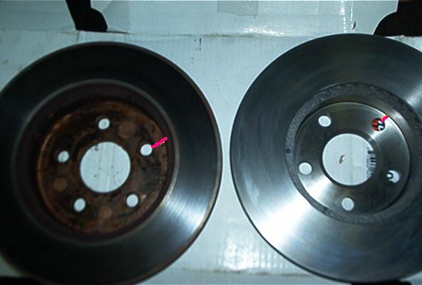

The cavalier rotors won't fit on the front because the diameter of the hat is somewhat narrower than the hat on a Fiero rotor. I didn't take any measurements, but I'd say it's close to 1/2 an inch.
I have a line from the wheel stud hole, to the inner edge of the hats in this picture, you can judge the difference in diameter.

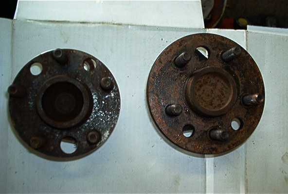

I had a spare set of front hubs so I took them to my machinest, along with a rear wheel bearing and had him machine the edge off the front hub flange so that it matched the diameter of the rear hub flange.
I swapped the original hubs for the machined hubs, and the rotors lined up great.
I did remove the dust shields from the front and back. I believe the rear ones could be bent enough to clear the inner edge of the rotor, but the front dust shields definetly need to be removed as the inner edge of the rotor is quite close to the edges of the steering knuckle.
Eyeballing it up, I would guess there is an 1/8" gap there. I didn't take any pictures of this, maybe tomorrow.
Stock front rotor,
97 Cavalier rotor installed, (I wasn't real fussy when I cleaned the overspray off the rotor face as you can tell....)
Now I can use 20 dollar rotors at every corner of the car instead of 120 dollar rotors.

Neat work Jelly. You answered the age old question of why exactly the rotors would not fit and fixed it.

Drove the car some today, braking is perfect. No problems with the rotors rubbing anywhere.

Just to be clear... You used the Cavalier rotor with the OE calipers. Yes?
Yes, all I changed in the brakes themselves was the rotors.
Kept the stock 88 Fiero calipers and pads on the original mounting brackets.

A quick question...

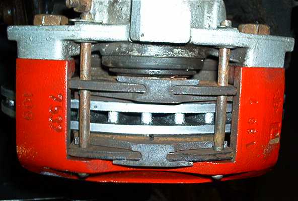

You said you had to remove the dust shields. I've also heard others say that the rotors were a bit closer to the knuckles, too. How much closer?
The only concern I have with that is if the caliper will reach the end of its travel on the sliders before the pads are worn out.
After a point, will the caliper "bottom out" and cause just one pad to try to do all of the stopping?
Perhaps I'm missing something. As you may have surmised, I've never done this myself.
Thanks!

Originally posted by Raydar:
Nice job!
A quick question...
Thanks!
On the rear, I would imagine that the dust shields could be easily bent back to clear, on the front it's just too close for the dust shields.
I will try to find time to get some back side views on the rotor to knuckle clearance, it is close.
I don't think there will be much of an issue with the caliper bottoming before the pads are worn out. I can pull the pads, and slide the caliper to either side and check

I did this swap solely because of the price difference in the rotors, now I can buy all 4 rotors for less than the price of 1 stock rotor.
My machinest charged me 10 dollars to cut my hubs.
I sure hope that if I print this thread and find a machinist, he will be able to figure out what I want him to do cause I'm not real sure what you had machined there.

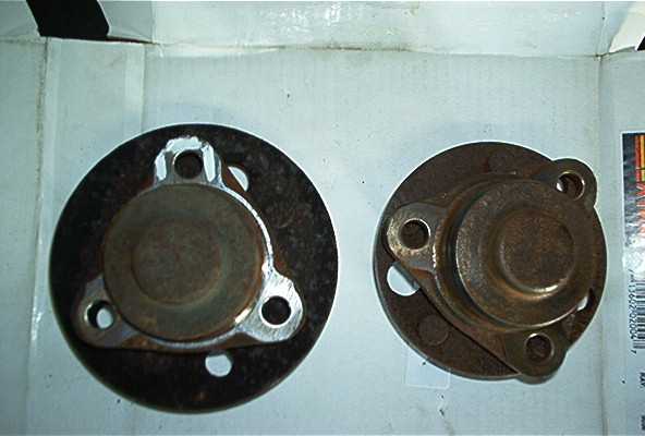

This picture might help you, the outer area I have the yellow arrow thingies on was machined off.
All I did was took the 2 front 88 hubs, and a rear hub to the guy and asked him to make the front hubs have the same diameter flange as the rear hub.

Raydar, I'll check the caliper clearance, gives me a good reason to pull it apart to install the front lowering springs anyway
The only thing that I had machined was a set of front 88 wheel bearings / hubs, that type of wheel bearing is commonly known as a hub assembly in the automotive field.
I had the wheel bearing flange ( the portion that the rotor seats against with the wheel studs in it) cut down in diameter.
The outer edge with the yellow marks on it was removed in a lathe. The wheel bearing itself was not dissasembled, he mounted the whole bearing in his lathe and cut away.
Basically I removed the stock wheel bearings, and bolted the machined ones in place, took a 97 Cavalier rotor out of the box and placed it on the car. No machine work what so ever was done to the rotor.
When rotor replacement time comes, I simply have to remove the old rotor and install a new one.
By machining the wheelbearing flange, I eliminated any future machine work needed.
The machine work I had performed was a one time deal.
I priced 2 different local parts suppliers, and 88 rotors cost $104.99 plus $15.75 tax is $120.74 dollars canadian each.
The 97 Cavalier rotors cost me $16.95 plus $2.54 tax for a total of $19.49 canadian each.
$66.00 us dollars is $89.00 canadian, even before any shipping, I'm still way ahead of the game.

Not being familiar with the two rotors, I have a question. When the diameter of the hub was machined down, that left less material mated to the disk portion. Does this compromise the strength and might possibly allow the disk to shear off the hub under sudden emergency stopping stresses? Machining techniques could also play a part in the integrity. At the point where the outer circumference of the hub meets the surface of the disk, a 90 degree juncture is more likely to develop a stress crack around its perimeter than a radiused juncture of the two planes.
If this works, are there any vented disks to fit the 84-87 that we might use this process on?
[This message has been edited by fierofool (edited 06-26-2003).]

I don't think strength would be too much of an issue. Remember, the Cavalier uses the same bolt circle as the Fiero, and comes with the smaller hubs (obviously, since the rotors are made for smaller hubs). If anything, the Fiero hub is probably over-engineered or larger than it needs to be. Still, if someone knows otherwise, now's the time to let us know.

Anyone out there able to answer the strength question. I bought two rotors today from Autozone appx $14.00 each plus tax. If this is a safe option I'll have the front hubs machined and ready for cavalier rotors all the way around.
jelly2m8
Posts: 6328
From: Nova Scotia, Canada
Total ratings: 242
Report this Post06-27-2003 01:05 AM Click Here to See the Profile for jelly2m8Send a Private Message to jelly2m8Direct Link to This Post
Strength won't be an issue, after machining my front bearings, there was the same amount of material from the stud outwards as there is on the rear bearings.
The rear carries alot more weight and stresses than the front does, and there is no problems with the back bearings in that department.
As Formula88 stated, just about all, if not all other front hub / rotor setups like this don't have that huge bearing flange like the front of the 88's do.
If anything, there is less flex in the Cavalier rotor hat than a stock 88 front rotor.

Any possibility that the heat from machining could affect the bearing grease or temper of the hub metal?
My hubs were cut on a machine lathe, and the guy charged me 10 bux at a 60 dollar an hour shop rate......, I don't imagine it took very long for him to cut the excessive off seeing he had to mount them in the lathe.
I asked about any issues they could forsee by cutting the hubs as this was my only set of spare hubs, and I did not want to chance ruining them, we all know how hard these are to find.
2 guys at the machine shop could see no effects on cutting the hub, whether it being changing the temper, or the strength of it.
I didn't see any signs of excessive heat, or of grease leaking from either the dust cap, or the seal.

Basically a direct swap means that if I did not remove the dust shields on the back, I could have pulled the rotor and slid the new one on.
One can leave the dust shield on there, and just swap the rotor, but you would have to bend the dust shield to clear the rotor.

How much would you need to bend the dust shields on the rear? I really don't want to screw mine up, and I'd like to keep them.

Formula, I installed the rotors on the rear, and they turned very easily, but I could hear them lightly dragging on th edust shields, so I simply removed them.
I would imagine a slight bend in them would make enough clearance.
Most new cars now-a-days do not use dust shields, so if the penny pinchers believe it is safe enough to run without them, I'm fine with that.
I've put hundreds of thousands of miles on Fiero's without brake dust shields without any issues.
