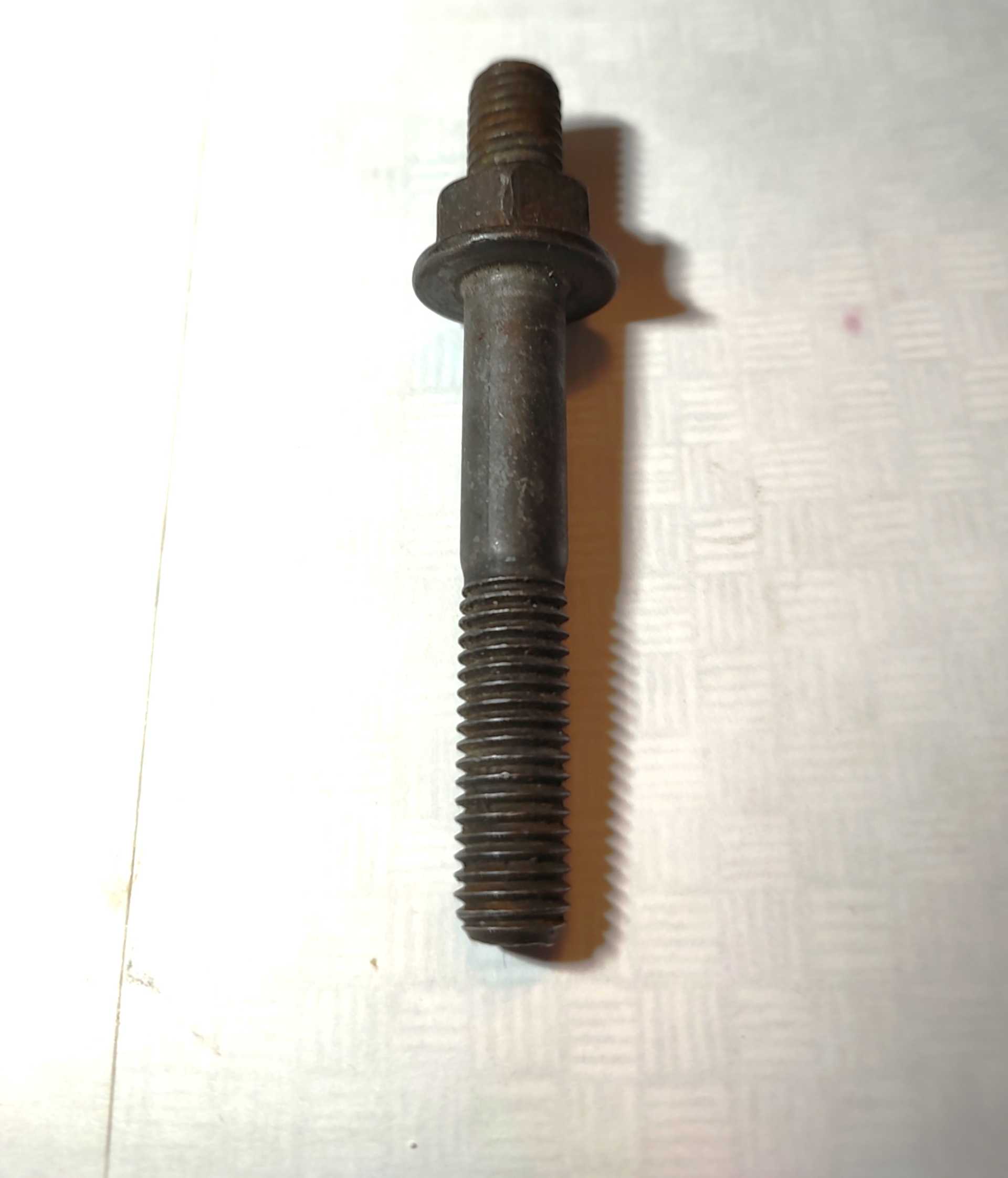

So I got this image from Vintage Nut but still need help. I know people have said that the size is M11x1.5 but I'm missing the depth. That or if anyone knows where to find this single bolt. The only thing I can think of is if I get lucky and find a guy parting out a Fiero online. Some guy on here said that I shouldn't start it unless I get this bolt so I don't ruin my engine. I have also looked online but there is basically nothing.

Report this Post09-10-2025 06:17 AM Click Here to See the Profile for 1985 Fiero GTSend a Private Message to 1985 Fiero GTEdit/Delete MessageReply w/QuoteDirect Link to This Post
It is a head bolt, it is a rare thread size and a special hardness or whatever, so you'll need to get a specific set of head bolts, ask your stores or look up the head bolts, I don't think you'll find them individually. a set will have the one head stud and I think 15 head bolts, then you can look and verify that the other head bolts are in the engine or not (at least the visible ones). All the head bolts are what keeps the top of the combustion chamber (the head) on the engine, no bolts or missing ones, then the explosions in the engine can lift the head up a bit, blow out your head gasket, and start melting things.

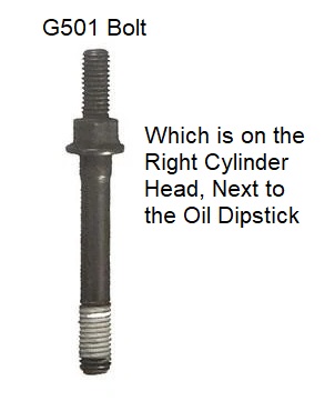

FYI
As mentioned, the G501 image is found in the V6 Cylinder Head Bolt Set...
Normally, both cylinder heads are removed and reinstalled on the engine block as a 'set' when servicing the heads AND these bolts are NOT reusable!
Once the heads are 'torqued' to spec, the bolts have been 'stretched' so "One Use" ONLY.

FYI
Most new vehicle head bolts are torque to yield, however Fieros aren't, the manual specifies only a torque, not a torque and angle for torque to yield bolts (the felt torque decreases as a bolt yields, therefore only a torque spec would either never be reached before the bolt snaps or is before the point where the bolt starts to deform and stretch) and specifies to clean and reuse them. As long as it is torqued to the factory manual spec (66 foot pounds if I remember, definitely not the 90 foot pounds of some of the aftermarket manuals) and a used bolt is clean and in good shape, they'll be fine. I've driven 15000kms total on a set of head bolts that were used twice, then later, a 3rd time on another engine. No issues.

Pontiac Fiero 2.8L V6 cylinder head bolts are not the torque‑to‑yield type
Thanks for the correction...
In rebuilding my engines; I always buy new bolts....

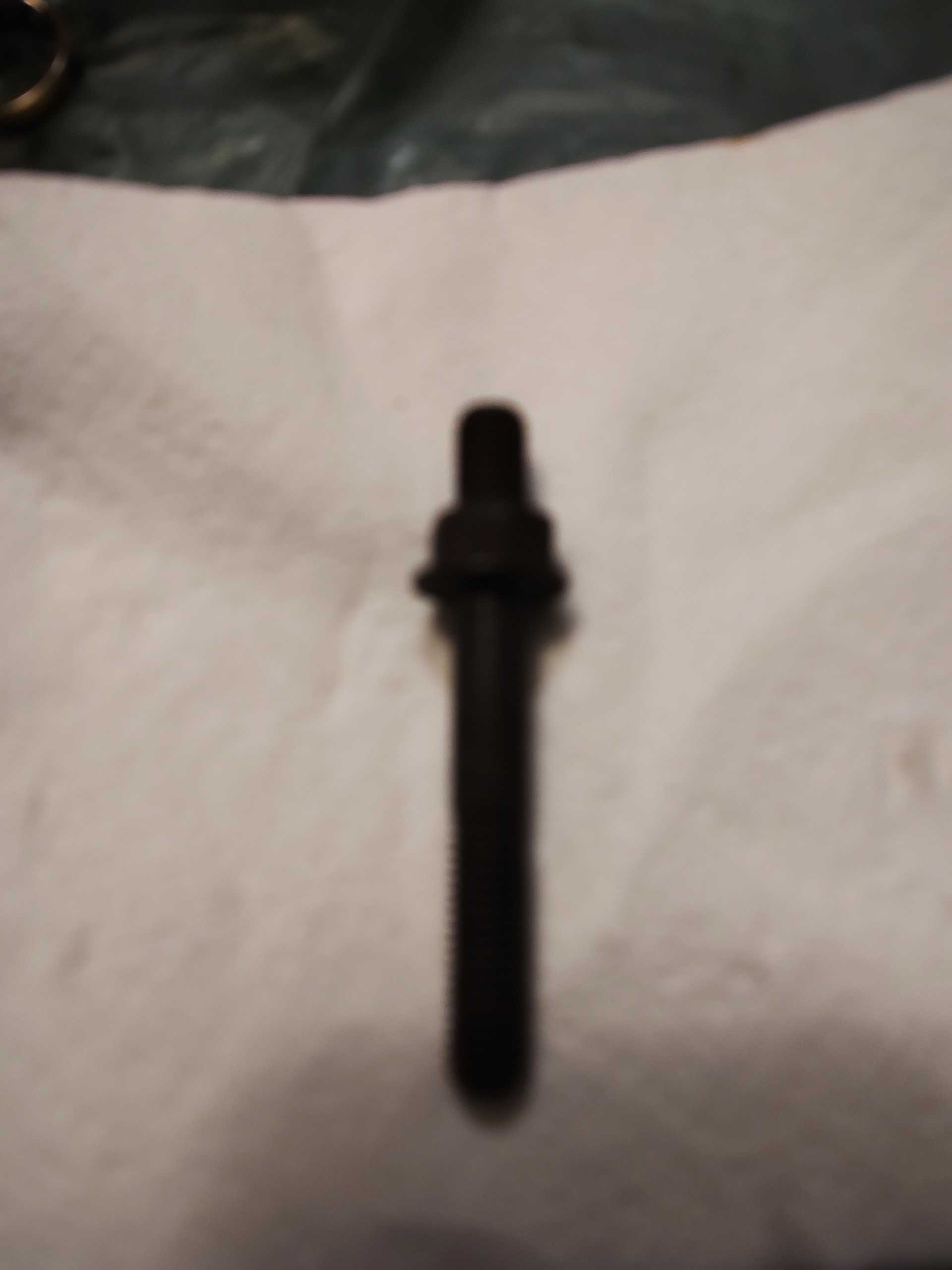

Founds this bolt in the garage. Its about 3 1/2" long. Is this the bolt that you are looking for??
BTW, ten posts in the Technical discussion page is abusing the privilege. I suggest you read the manual thoroughly. Most of the answers are there.
it looks similar but off. the thread seems to be longer then the photo. it might work though

Here is the better picture of the bolt that I have. If you need it let me know and I will send it but try to let up on clogging up the technical section.
if you want to you can so we can see if it even fits. I would appreciate it a lot. is there a way to do private messages though. I ain't doxing my self. btw it ain't starting for awhile. The EMC is gone so I got to buy new one.

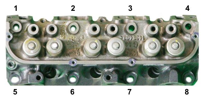

Just to satisfy my own curiosity... which of the eight head bolts is missing? I numbered them for you in order to make it very simple to identify the exact location.
I don't think its any of those. The bolt goes in at a angle. its not straight up like those. it may be the hole above 5. the spot name is G501 and that might be the spot in your photo
[This message has been edited by Carlin (edited 09-11-2025).]
Remember the engine is a V6, each bank of cylinders is at an angle, all those bolts would be pointing towards the rear window/firewall.
Posts: 39463
Total ratings: 464
Report this Post09-11-2025 05:49 PM Click Here to See the Profile for PatrickSend a Private Message to PatrickEdit/Delete MessageReply w/QuoteDirect Link to This Post
Bingo.
It either is or it isn't.
Look, I'm not trying to be an azz, but I think you've bitten off more than you chew with this car. Learning about cars with one that's at least in running condition is a whole lot simpler than starting with a partially disassembled car that also has components missing.
[This message has been edited by Patrick (edited 09-11-2025).]
ah i forgot about that. if it helps i think its the spot above 5. it looks similar
Bingo.
I don't get why you can do a repost of another persons post but cut half of it off. its still in the photo just not the ones you labeled.
I have seen it a few time on here. people just do a quick summary of someone's else post and it now doesn't make much sense because they left some important parts out.
I feel like the way it should work instead is if you have a post from someone else you should be able to get a easy link option from that post. So that way people can see the full original post with no edits.
Posts: 39463
Total ratings: 464
Report this Post09-11-2025 05:58 PM Click Here to See the Profile for PatrickSend a Private Message to PatrickEdit/Delete MessageReply w/QuoteDirect Link to This Post
The ones I labelled are the head bolt locations!
Read the rest of my last post which I edited/added to.
