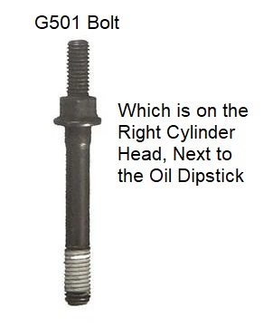

Two of Three
BOLT, M6x1x13: oil dipstick tube to engine block
NUT, M11x1.5: negative battery cable to engine head stud at G501

Two of Three
hello so I do have a problem. we got the bolt today, still need to put it on. But I don't have the nut. NAPA said that nut size doesn't exist. are you sure you measured it correctly. It was M11x1.5

Report this Post09-03-2025 06:13 PM Click Here to See the Profile for 1985 Fiero GTSend a Private Message to 1985 Fiero GTEdit/Delete MessageReply w/QuoteDirect Link to This Post
Originally posted by Carlin:
i don't have the bolt tho. thats the thing. someone took it out
No, my picture is not of the correct point, and I said that the first thread I used it in, you can see the correct point lower down, red circle in my image here. My Fiero cannot use that because the aftermarket head studs aren't long enough to attach the ground cable. I instead put it in a different place that wasn't occupied, over an exhaust port. The correct place must be there, it is a head bolt, if it isn't there, then you need to figure out why and dig deeper. If you are missing head studs, then you need to get a set, can't just go to the hardware store for those. It is really really awkward to get to the head stud, but it certainly should be there, if it is there but you don't use the stud part, or whatever, then you can put the cable where I did, over the exhaust port, in which case I'm not sure if there's supposed to be a bolt there originally or not, I think there was and it holds the bracket that the dipstick bolts to, so if that bolt was missing, then the bracket may be askew, and that would have made the dipstick hard to line up.

Report this Post09-04-2025 10:40 PM Click Here to See the Profile for CarlinSend a Private Message to CarlinEdit/Delete MessageReply w/QuoteDirect Link to This Post
hey bro, so I got lazy and just copied you. the negative and ground are hooked up in your spot by the dip stick. still no power and i know why. theres a few cut wires. I'm going to make a new thread with the photos. if you want to help it should be one of the latest threads. thank you

Report this Post09-05-2025 06:19 AM Click Here to See the Profile for 1985 Fiero GTSend a Private Message to 1985 Fiero GTEdit/Delete MessageReply w/QuoteDirect Link to This Post
As long as you do have a bolt or stud in the proper location, as that's a head bolt, without it, the engine will not run and will have major issues if you try to run it, blown head gasket etc.
