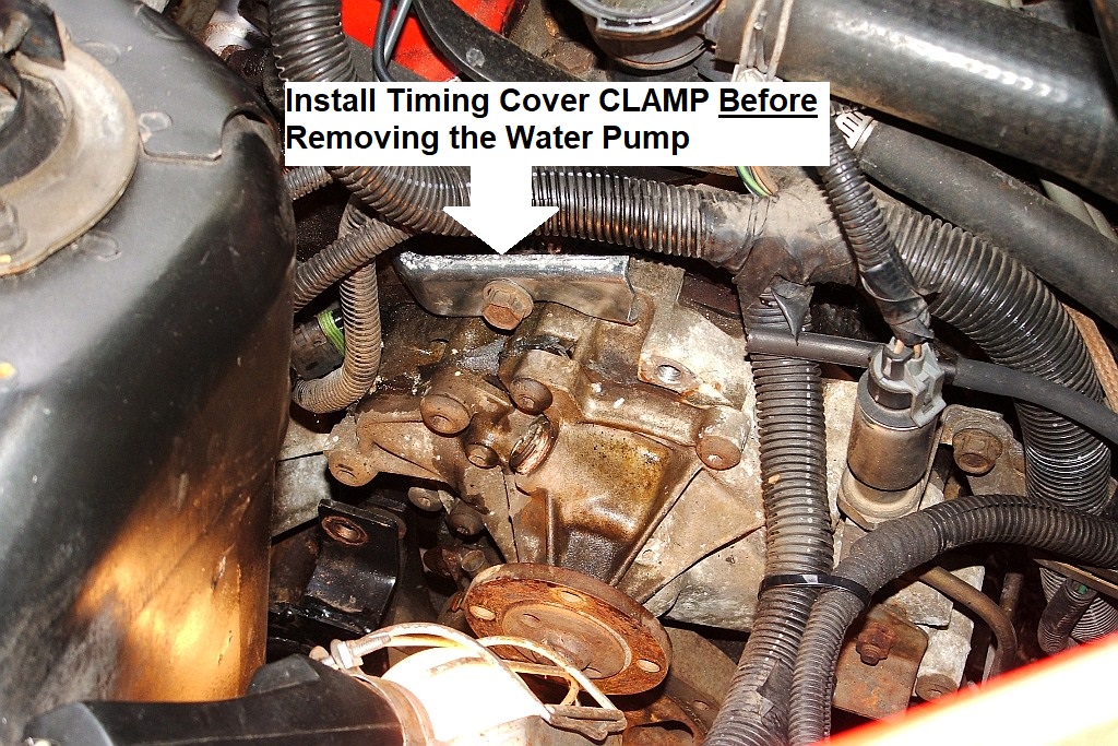

You may as well read my thread about the same situation. Pay special attention to the use of "the clamp".
Where the heck is this coolant leaking from?
Originally posted by Patrick:
Speaking about the clamp, I have never seen an image anywhere on the 'net (including Pennock's) of one actually being used. Behold...this is where it goes!
CLICK FOR FULL SIZE
And yes, you install the clamp before you loosen any water pump bolts!
[QUOTE]Originally posted by Patrick:
CLICK FOR FULL SIZE
[/QUOTE]
Where's the clamp? I can't tell from the picture.
Look through the thread I linked to.
