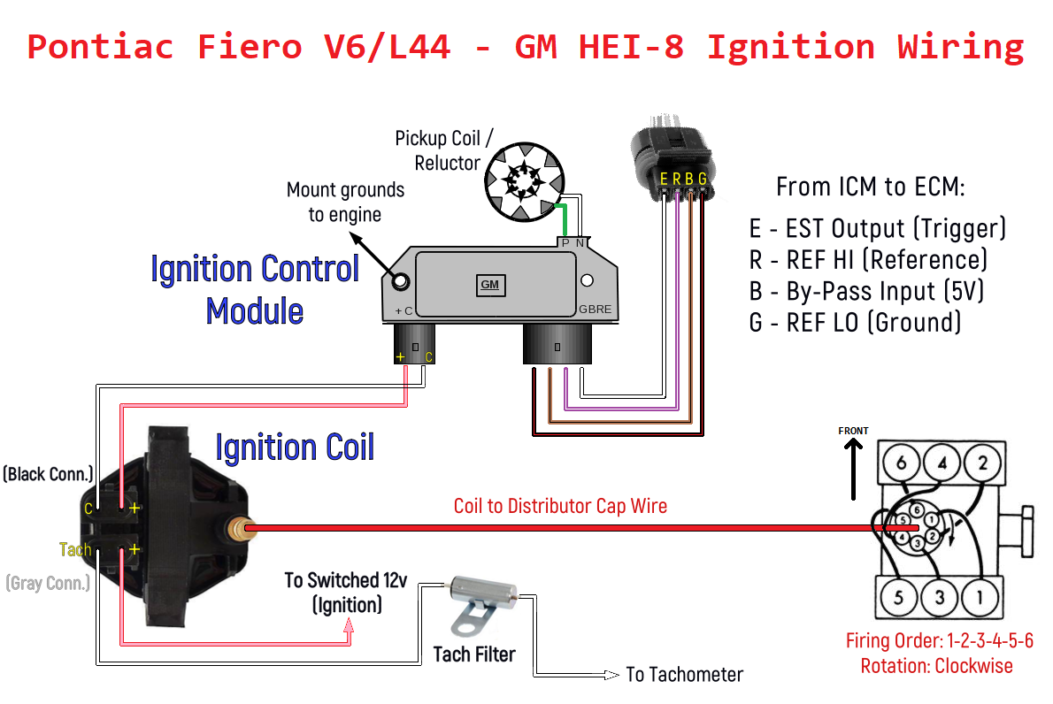

When replacing the ignition module for a 1988 GT, the two male pins on the top of the module are connected to two wires with a separate female connector for each wire coming from behind the distributor. On my 2.8L they are not molded, just wrapped in electrical tape. Does it matter which side they connect to? If they are reversed does it matter? Thanks JRR

Yeah, the pickup-coil-to-module connector is supposed to have a locking tab which is supposed to prevent you from plugging it in "backwards". Like yours, my harness connector was broken off and the wires wrapped with tape..... Changing the module one night in a parking lot, I couldn't remember which wire went to which terminal on the new module.
If you're just trying to plug the two wires into the module temporarily, the white wire from the coil goes to the module plug with the little tab; the green wire goes to the side without the little tab. But like Patrick said, the better fix is to get a new pickup coil.

Report this Post06-30-2025 02:22 PM Click Here to See the Profile for 82-T/A [At Work]Send a Private Message to 82-T/A [At Work]Edit/Delete MessageReply w/QuoteDirect Link to This Post

Thank you for the diagram and ex[planation. I may have it backwards. Will Take apart tonight to look. The Ignition Module came with white silicone for the base. Can I still remove the module to see the wire colors and reinstall it? Do I need to clean it and add silicone again?
