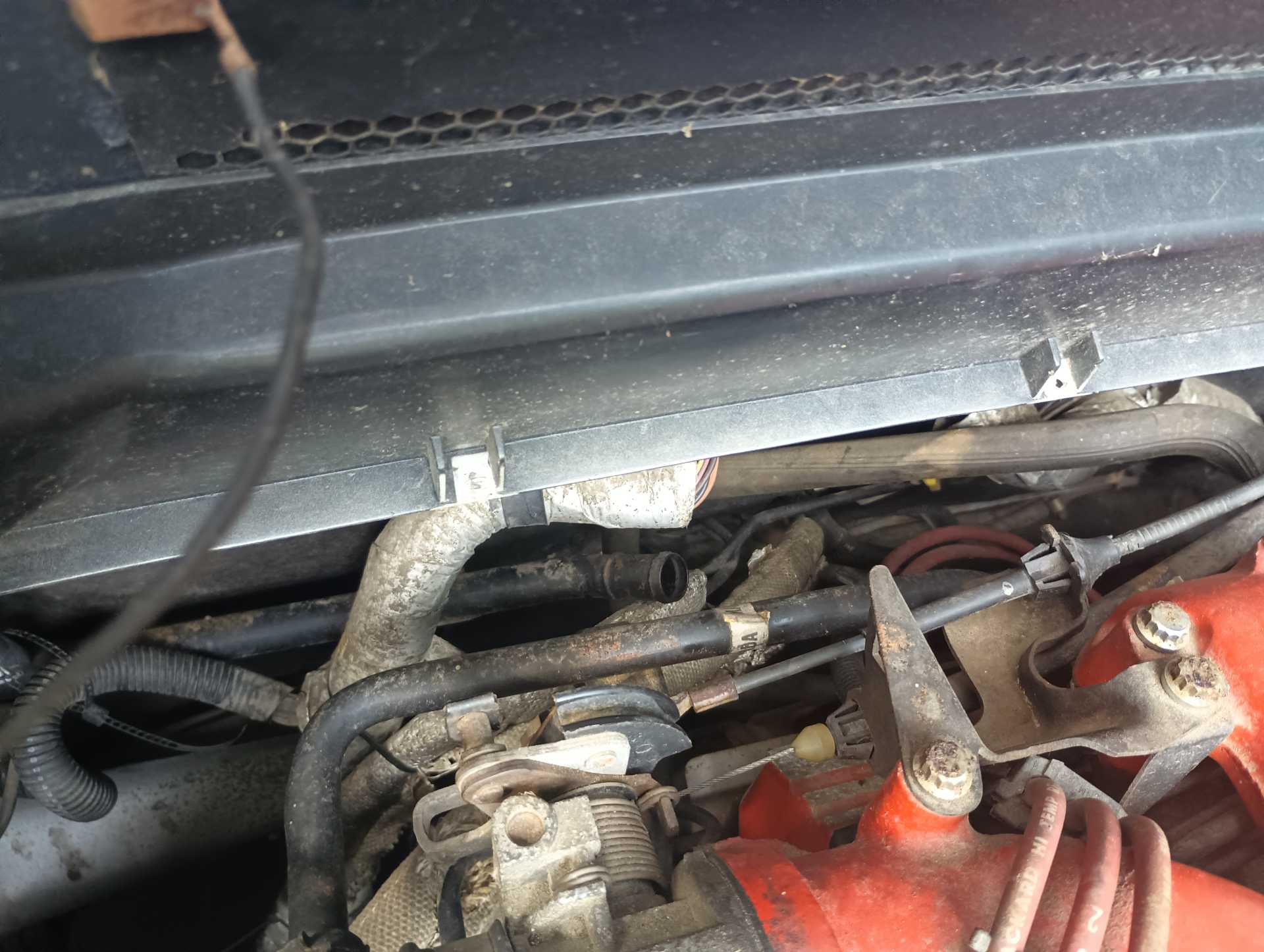

Report this Post08-01-2025 11:56 AM Click Here to See the Profile for 82-T/A [At Work]Send a Private Message to 82-T/A [At Work]Edit/Delete MessageReply w/QuoteDirect Link to This Post
Originally posted by dizzie:
Ahh cool, great to know, thanks. Added some photos and an additional question in the above post. You were too fast for me!
That pipe (that it's open) is part of a recall. I THINK it originally connected the PCV to the front of the air cleaner, or something like that, I can't remember. But regardless... GM did a recall on all Fieros. The first year Fiero was the only one that ever had fire issues (that were because of any specific design flaw). It had something like 1 out of every 5 connecting rods that had imperfections in the casting. It resulted in some 200 engines that blew up with less than 20k miles on them. Blew up as in, a rod broke and sent shrapnel out the oil pan, which inadvertently would then dump oil all over the catalytic converter and cause a fire.
But, it was one of those "we must do something to show we're doing something" that organizations do, so they made several changes to these cars, which included that. That tube is basically bypassed, and it should likely also be open on the other side as well. Some people find a rubber cap and cap it off, while others try to cut it and remove it from the other smaller vacuum line that's attached to it below.
EDIT: Another thing they removed was a weather seal that goes between the trunk lid and the rear window. You see those little square "slots" in the back of the decklid? There was supposed to be a clip in each of those, and it attached a big rubber strip that sealed the decklid against the window. This prevented water from dripping down directly onto the exhaust manifold and rusting out the bolts. There are several cars that didn't get the recall, and these are sought after. People re-install them because it's kind of silly... I don't really know what the logic was, as it doesn't help cool... maybe it was something to the effect that, if there was a fire, it would be more obvious since you'd see flames coming up... or something?
Also, since I was talking about the catalytic converter... if you still have the original (huge flat charcoal pellet canister), it might be worthwhile to replace it with one of the newer aftermarket ones. You'll pass emissions better (if that's a concern), have more horsepower, and drop some weight. Long story, but back in the 70s, some company that made these lobbied the EPA, and they forced car companies to use these instead of the honeycomb style cats that were far more efficient. They rescinded that law back in the late 80s, so all new cars from like 1988+ came with the newer style of cats that all other cars have today.
[This message has been edited by 82-T/A [At Work] (edited 08-01-2025).]

That pipe (that it's open) is part of a recall. I THINK it originally connected the PCV to the front of the air cleaner, or something like that, I can't remember. But regardless... GM did a recall on all Fieros. The first year Fiero was the only one that ever had fire issues (that were because of any specific design flaw). It had something like 1 out of every 5 connecting rods that had imperfections in the casting. It resulted in some 200 engines that blew up with less than 20k miles on them. Blew up as in, a rod..
Wow, truly great info and context, thanks again! I'll be looking into the cat and maybe even putting some of my own weatherstripping in that area since I don't have a garage or carport. Appreciated!

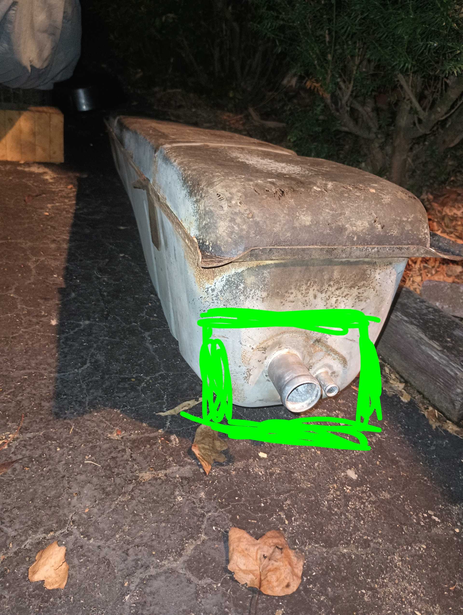

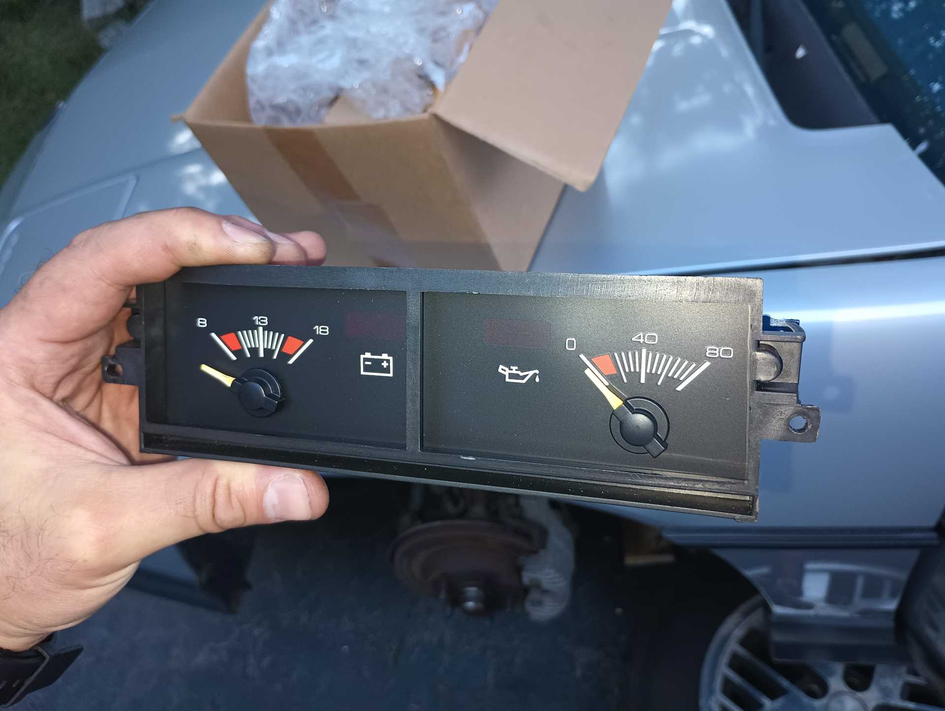

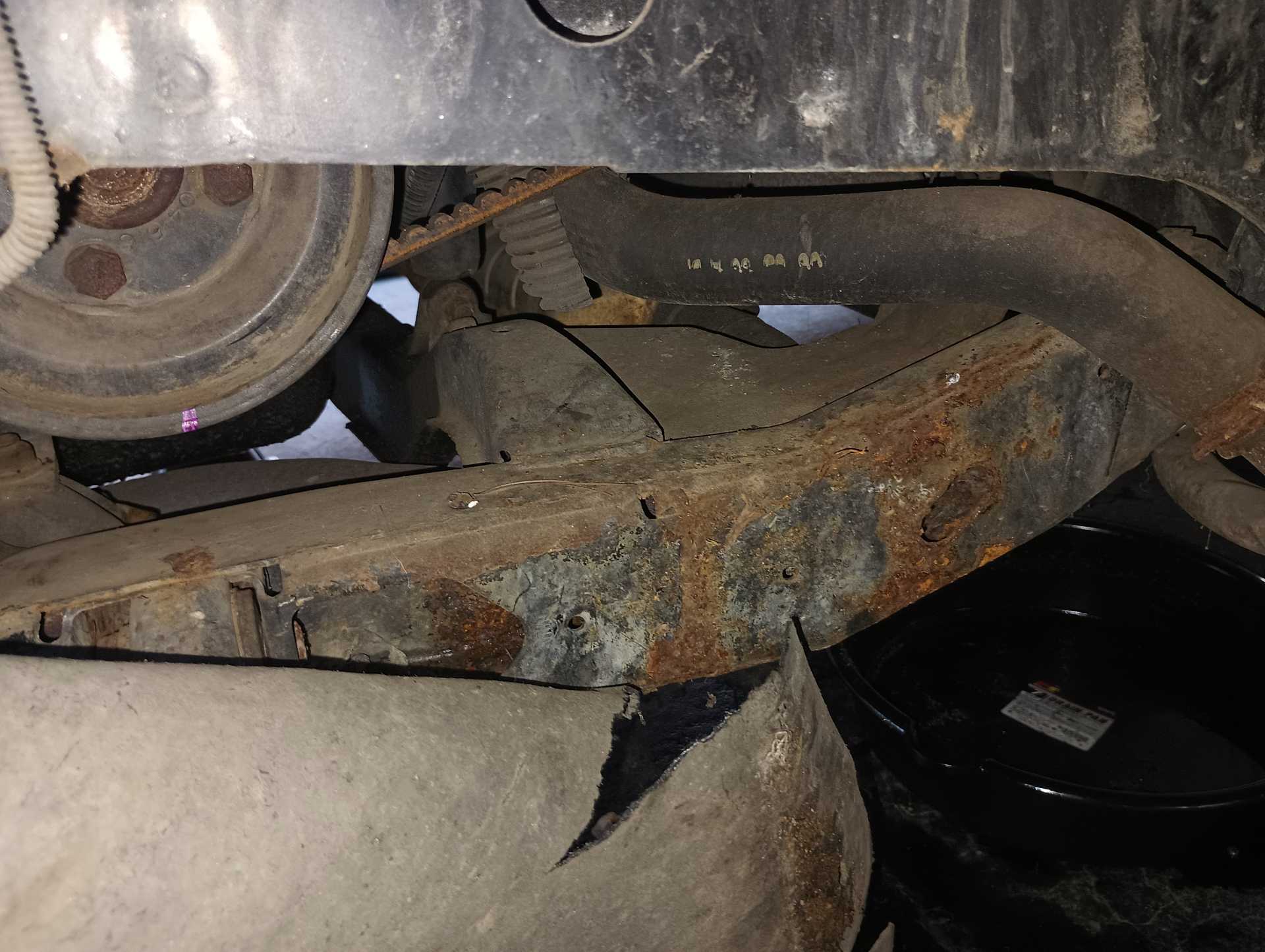

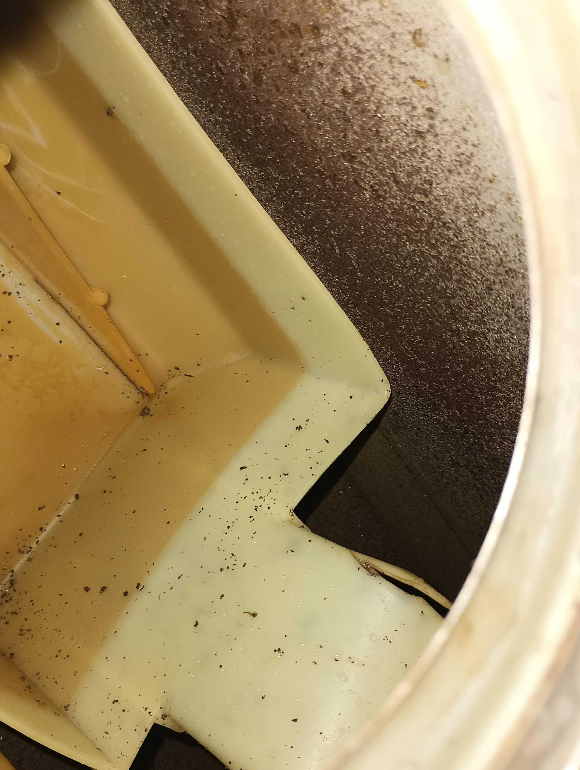

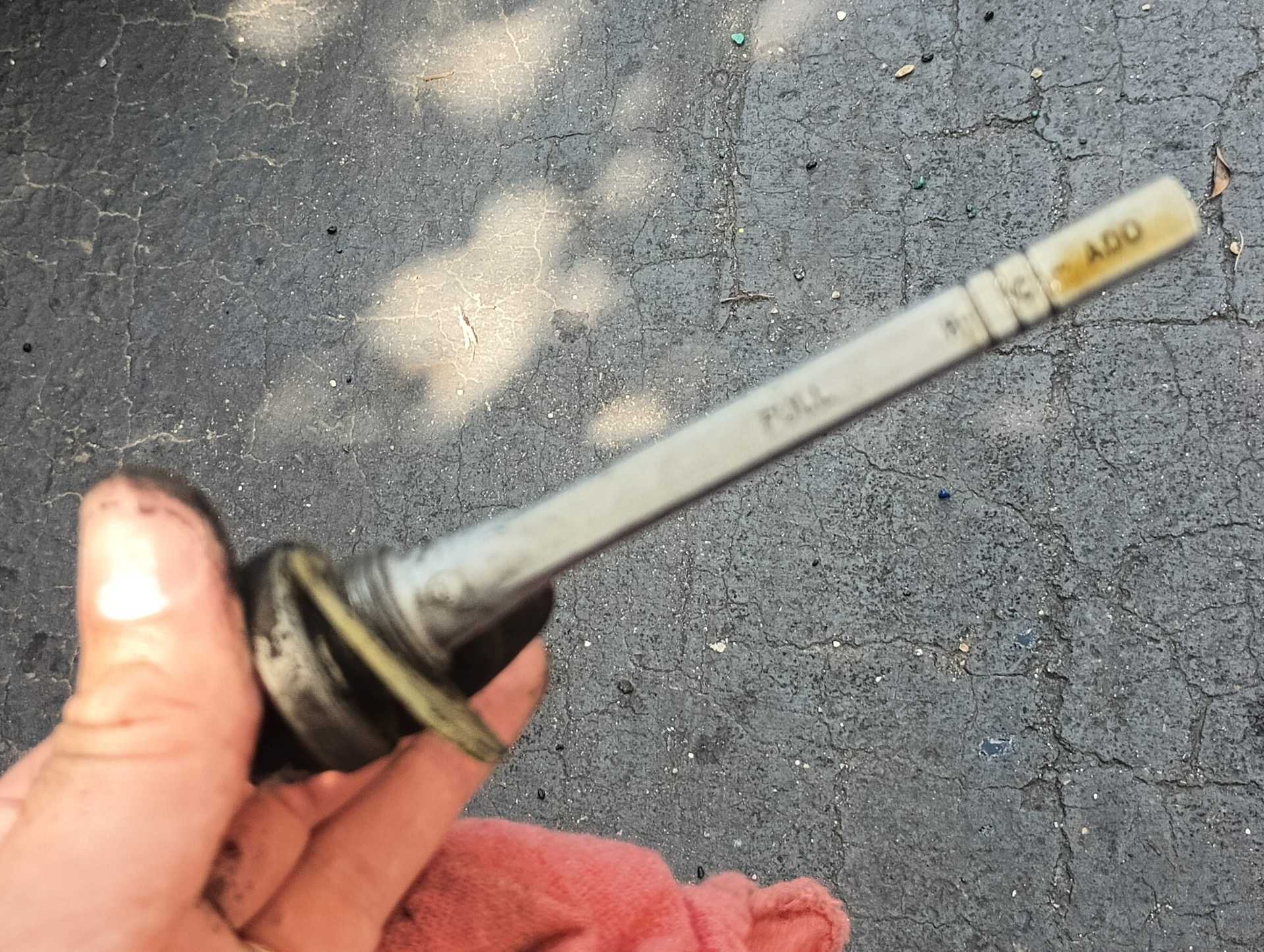

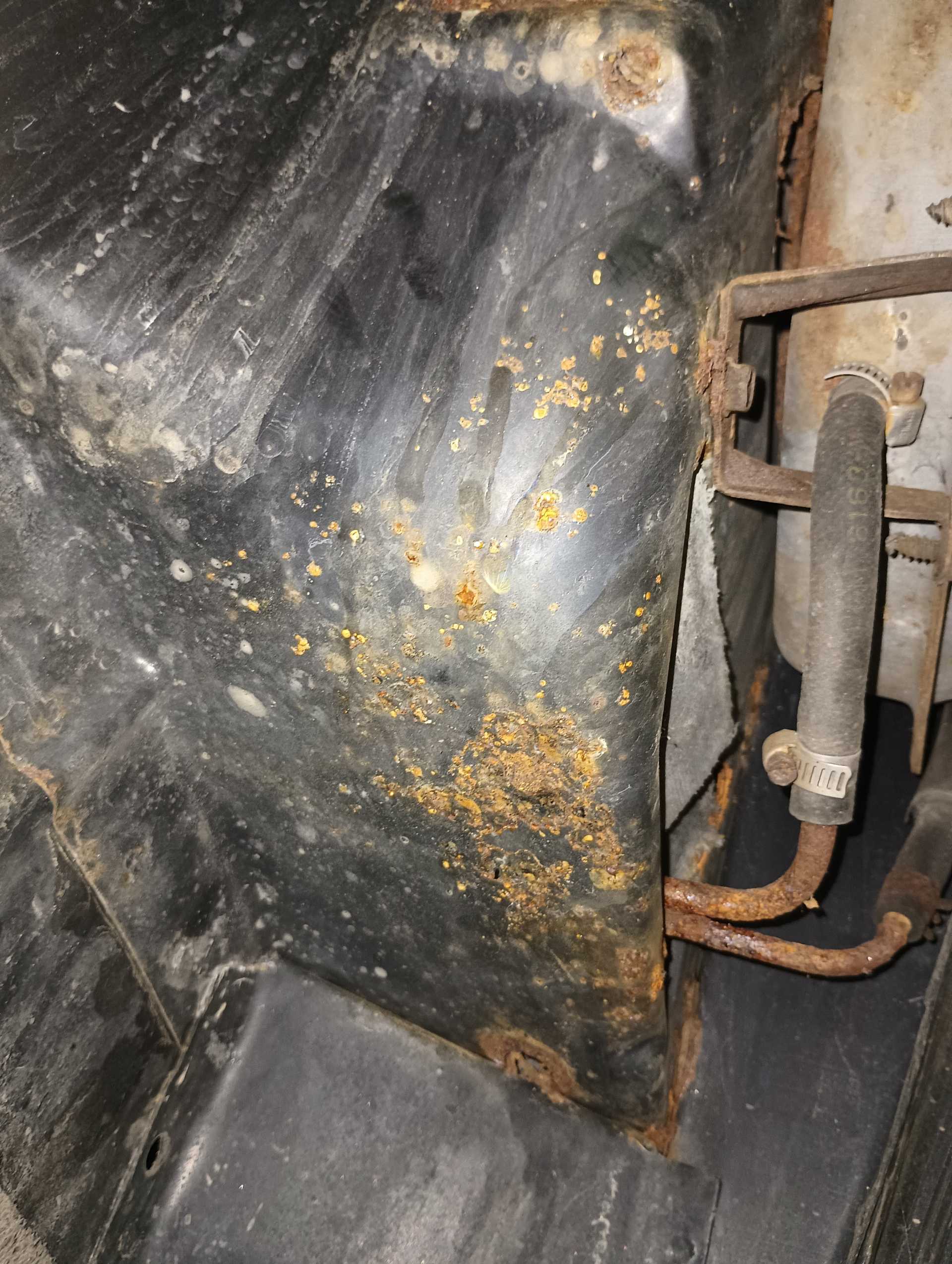

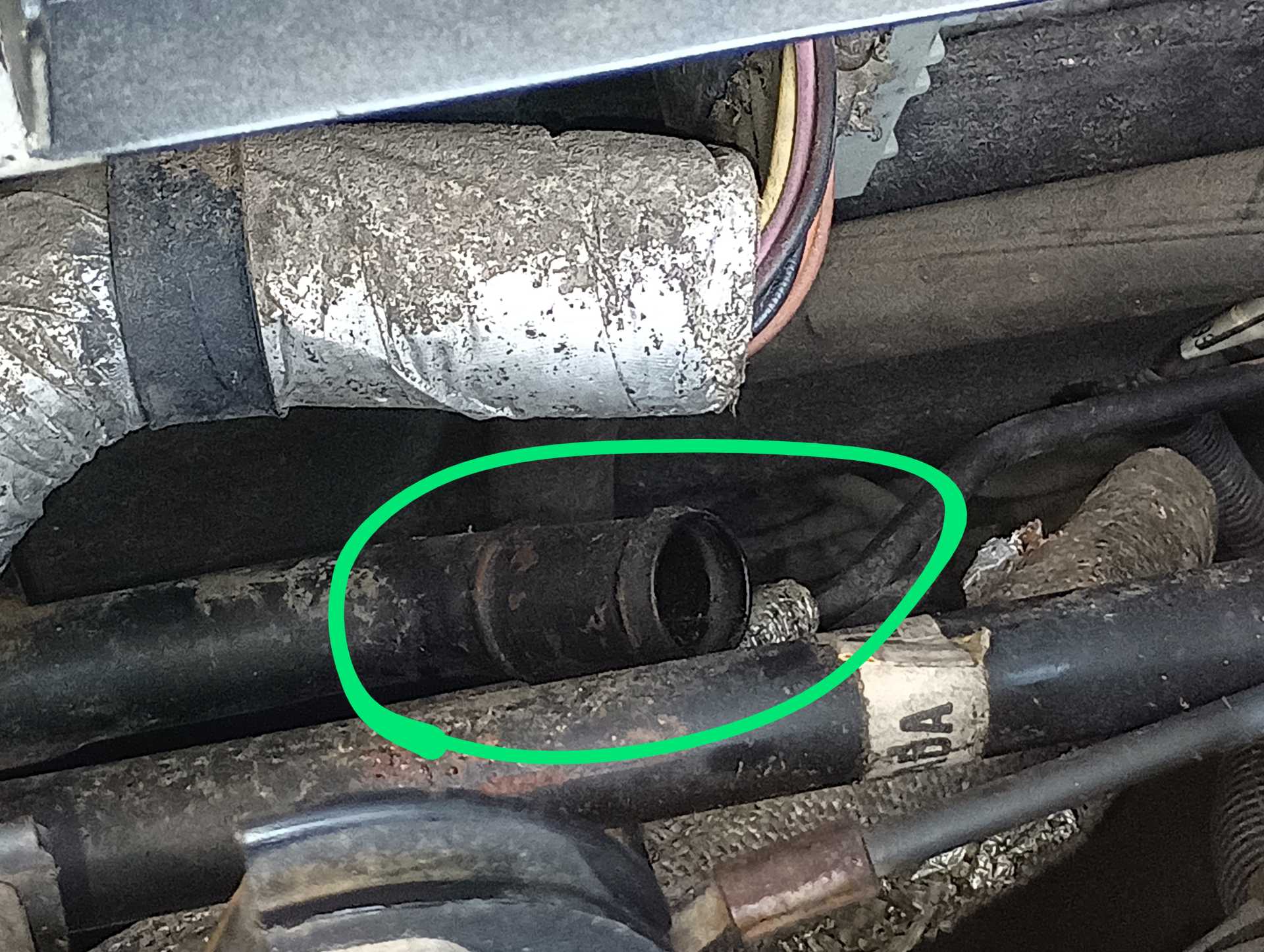

Well, it's been far too long since I updated this thread! Honestly I've lost a bit of momentum. We've done a number of things to it, including dropping the fuel tank since we determined the fuel pump was inop. A test of the old pump proved that correct. We also fixed the fuel sender, put in new plugs and wires, and some other stuff I'm forgetting. Oh - earlier we got it to fire up on starter fluid (see video here) after it had sat for a week with Marvel Mystery Oil in all the cylinders. That was exciting! Changed the engine oil and manual transmission fluid (there was dark oil in the engine, and there was still plenty of trans fluid!) Replaced the oil and battery gauge with a new one that was in the car. The 25 year old tires have actually held air! Oh, that's another thing - the car was last registered in 1999. I really think this thing may have not been driven in the last 25 years, at least not with any regularity.
My biggest question right now is the gas tank. I took it to a radiator guy and he said he'd have to remove the baffle to clean and seal it and that the baffle would get destroyed in the process. It didn't sound like welding in new metal baffles would be a cost-effective option. I called Por-15 and they said that the epoxy would likely slide off the plastic baffle in a sheet at some point down the line, possibly clogging the fuel filter. So I'm not sure whether I should A) destroy and remove the baffle myself and use POR-15 to save a couple hundred bucks, B) Allow the radiator guy to do the same type of destructive procedure, or C) See if I could get him to make his cut on the end as shown in my marked up photo, potentially removing the baffle for reinsertion. I'm leaning towards the latter.
I've got a new temp sensor to replace and have tested it successfully with the new battery. Oh - all the electronics work so far! The headlights even popped up - once. Then the interior little cylinder pieces promptly disintegrated. I have the repair kit from Rodney Dickman waiting to go. I also have rotors, pads, brake hoses, fluid, brake master cylinder, clutch master and slave cylinder to go on after the fuel tank.
When we took the wheels off, I found that the upper rear frame rails are in super shape, hallelujah! There is only one spot with some significant rust - under the battery tray. Not sure if this needs reinforcement or not? There's also some surface rust on the lower frame rail on one side.
I'll post some photos, and be sure to click the above link to see it come to life, ever so briefly. Hoping to get this fuel tank stuff sorted out soon. Also hoping that there won't be loads of vacuum hoses to replace, though I should probably do coolant hoses. Miraculously, the hoses aren't dry rotted - probably becase the garage was relatively cool and temperature controlled, and somewhat humid. It took forever to cut through the hoses attached to the gas tank! I have replacements for them all.
I seem to recall that someone (relatively recently) posted here about how they dealt with a rusted gas tank, and it did not involve removing the baffles. I suggest you hold off doing anything drastic until someone hopefully posts a link to that thread/process.

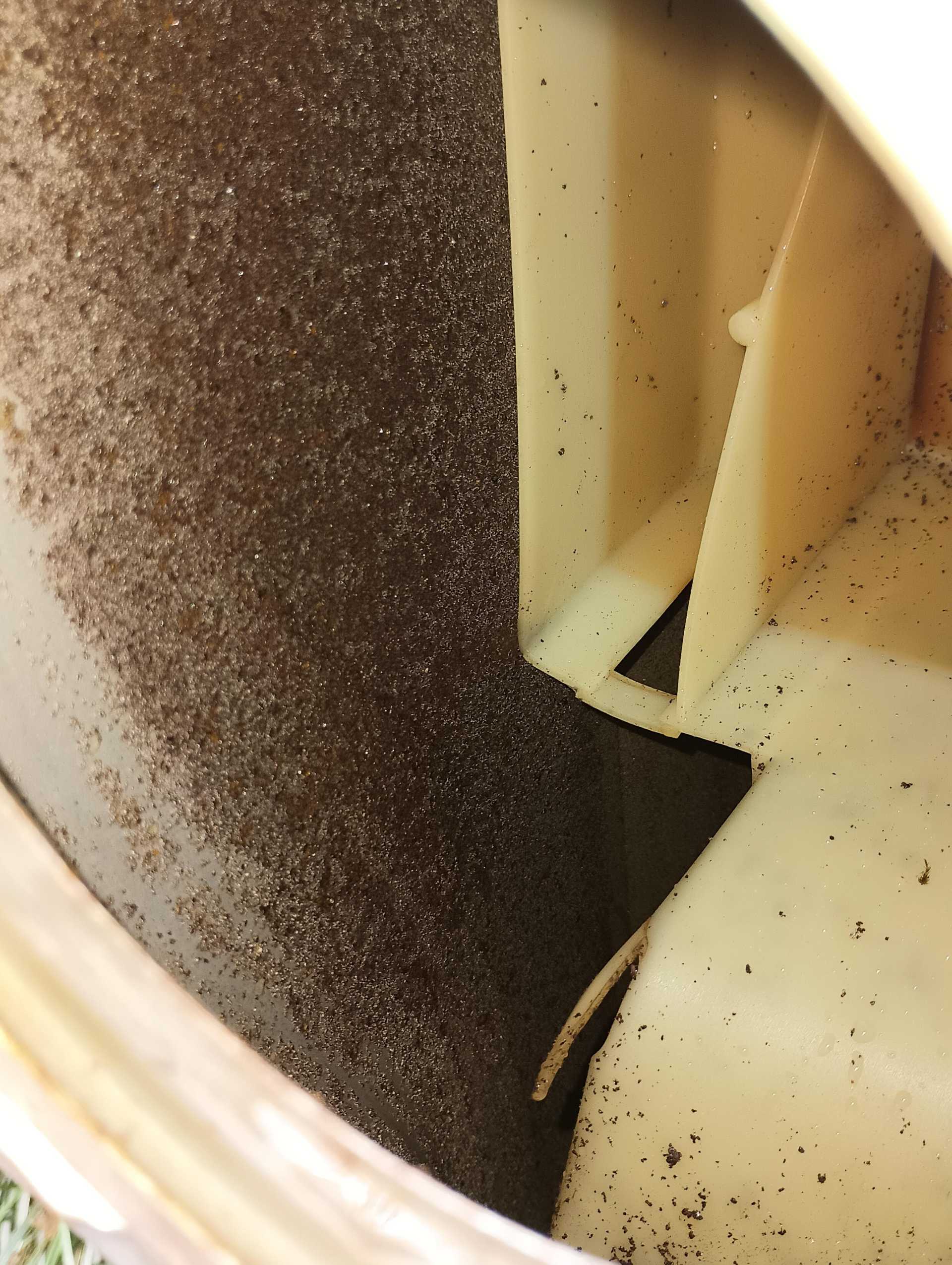

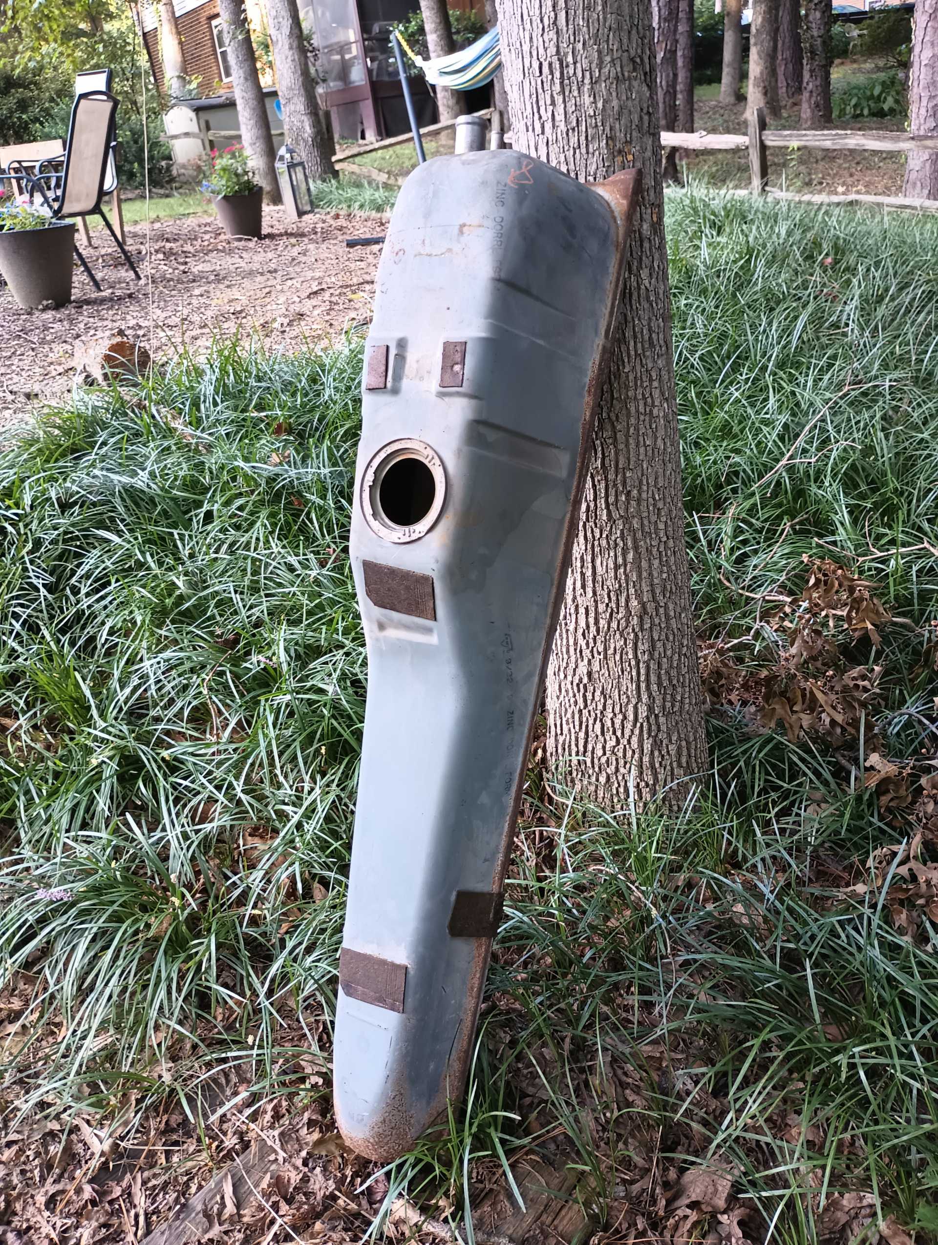

Thanks, Patrick! I had already taken a thorough look through the forum and archives on every entry mentioning the gas tank I could find. I took a fresh look and couldn't find anything new, but maybe I'm just missing the needle in the haystack.
I ended up buying 9 gal of vinegar to sit in the tank for a day or two to see if I can get rid of the bulk of the interior surface rust while keeping the baffle in place.
Added water and was able to get a total of 12.5 gallons filling the tank up to the very brim! I didn't expect to get much over 10. While I don't think this is nearly all usable capacity (more like 9; or 10) I thought it was interesting to know how much liquid the thing would hold.
Going to rinse it out really good in a day or two, put a little baking soda and water in it to neutralize it, and then slosh around a smidgen of diesel fuel in the bottom to coat it and prevent any flash rusting.
Hopefully this will end up saving a few hundred dollars as well as retaining the original baffle that's still in great shape, we'll see.
