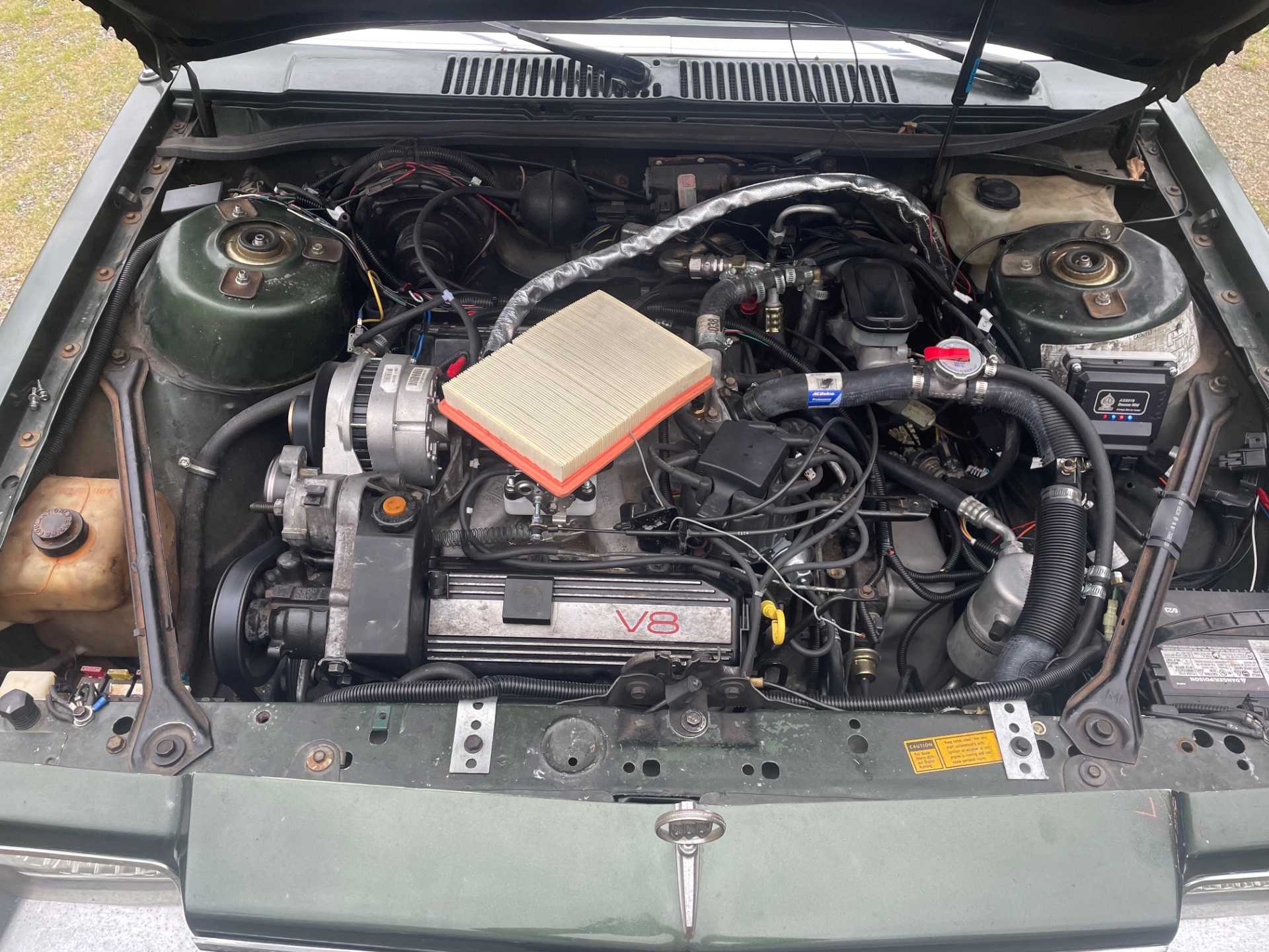

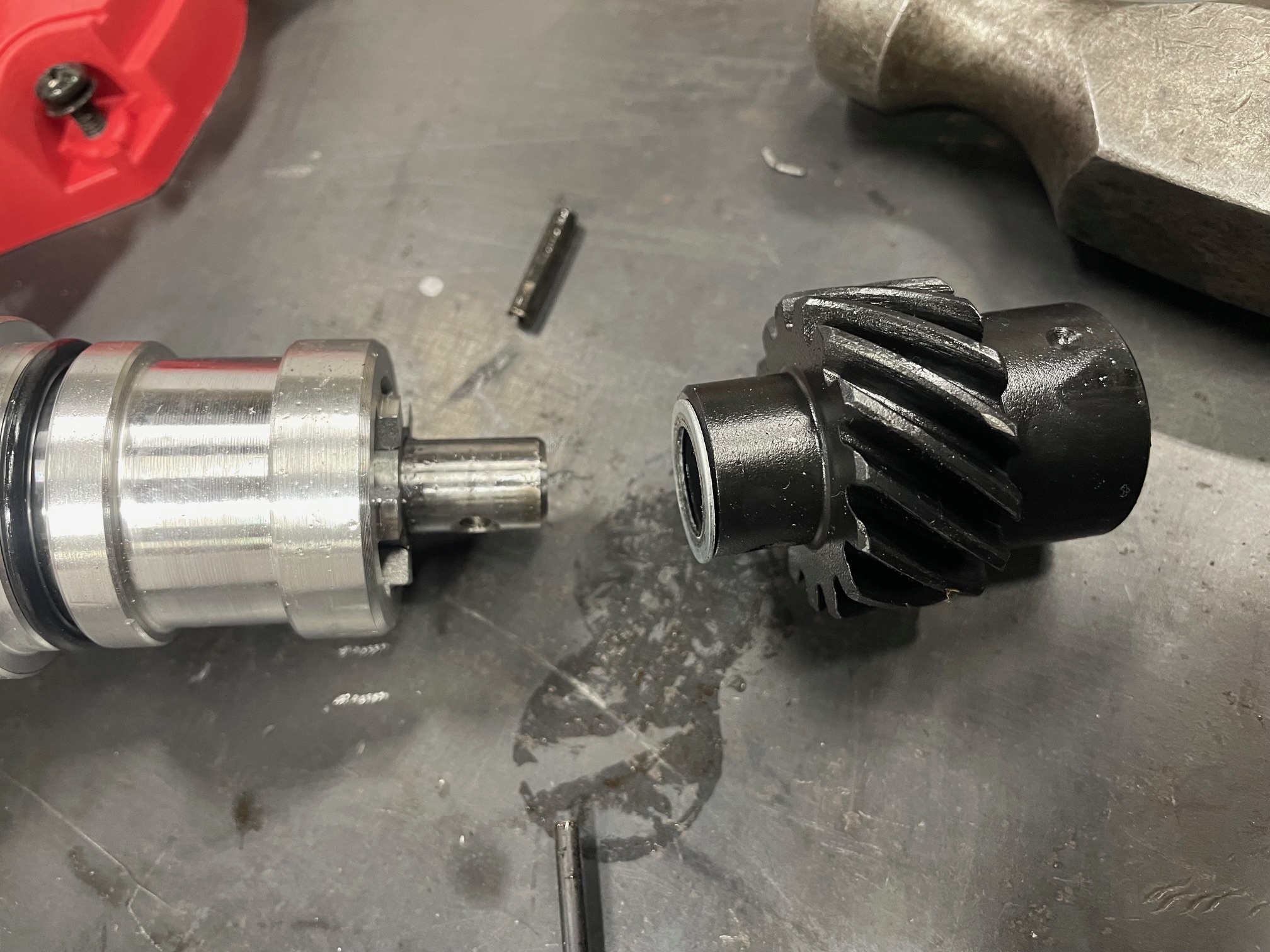

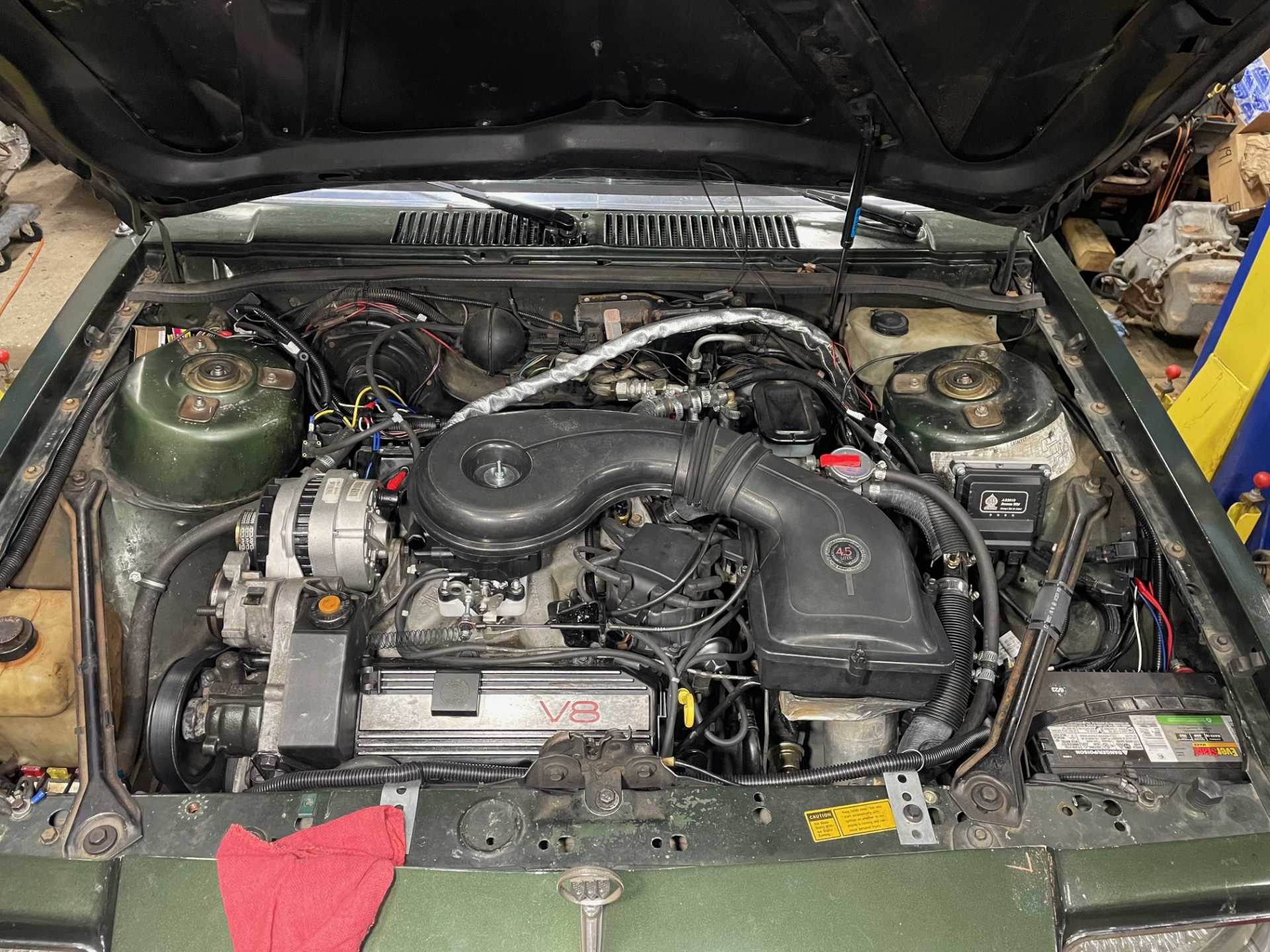

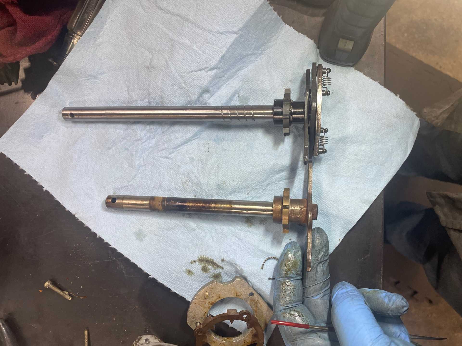

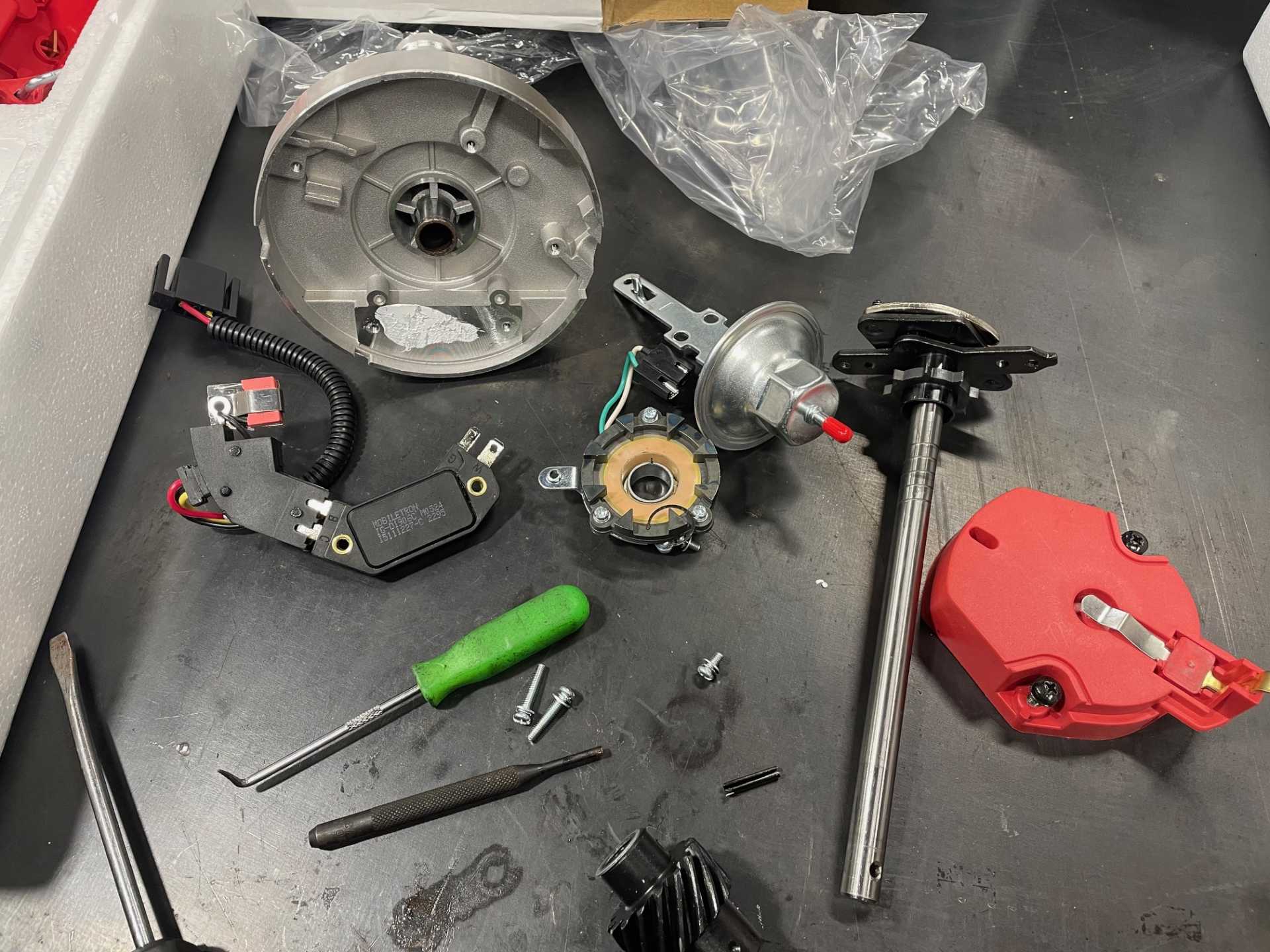

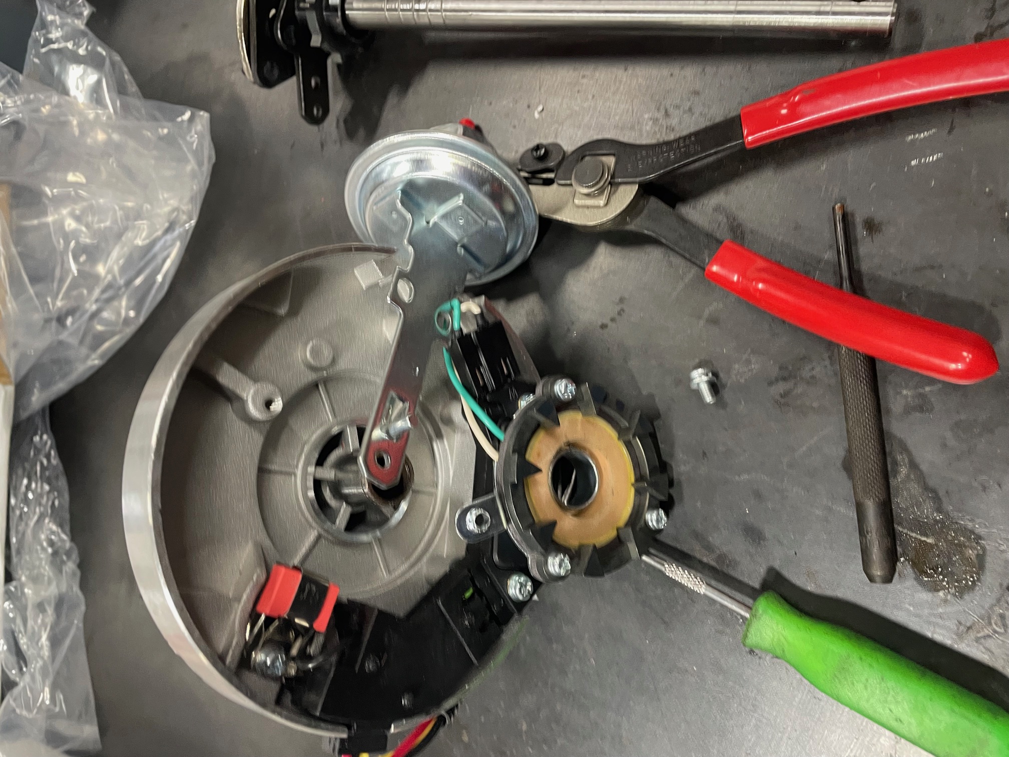

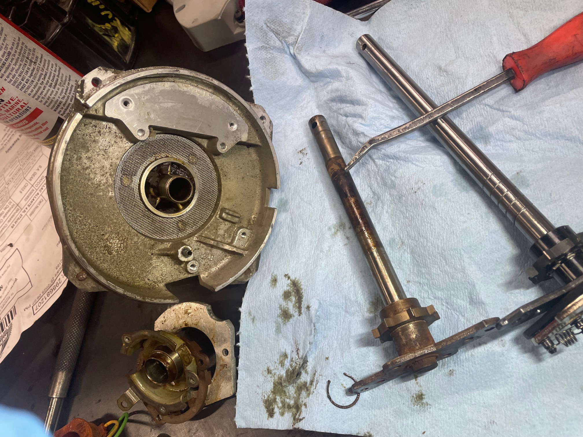

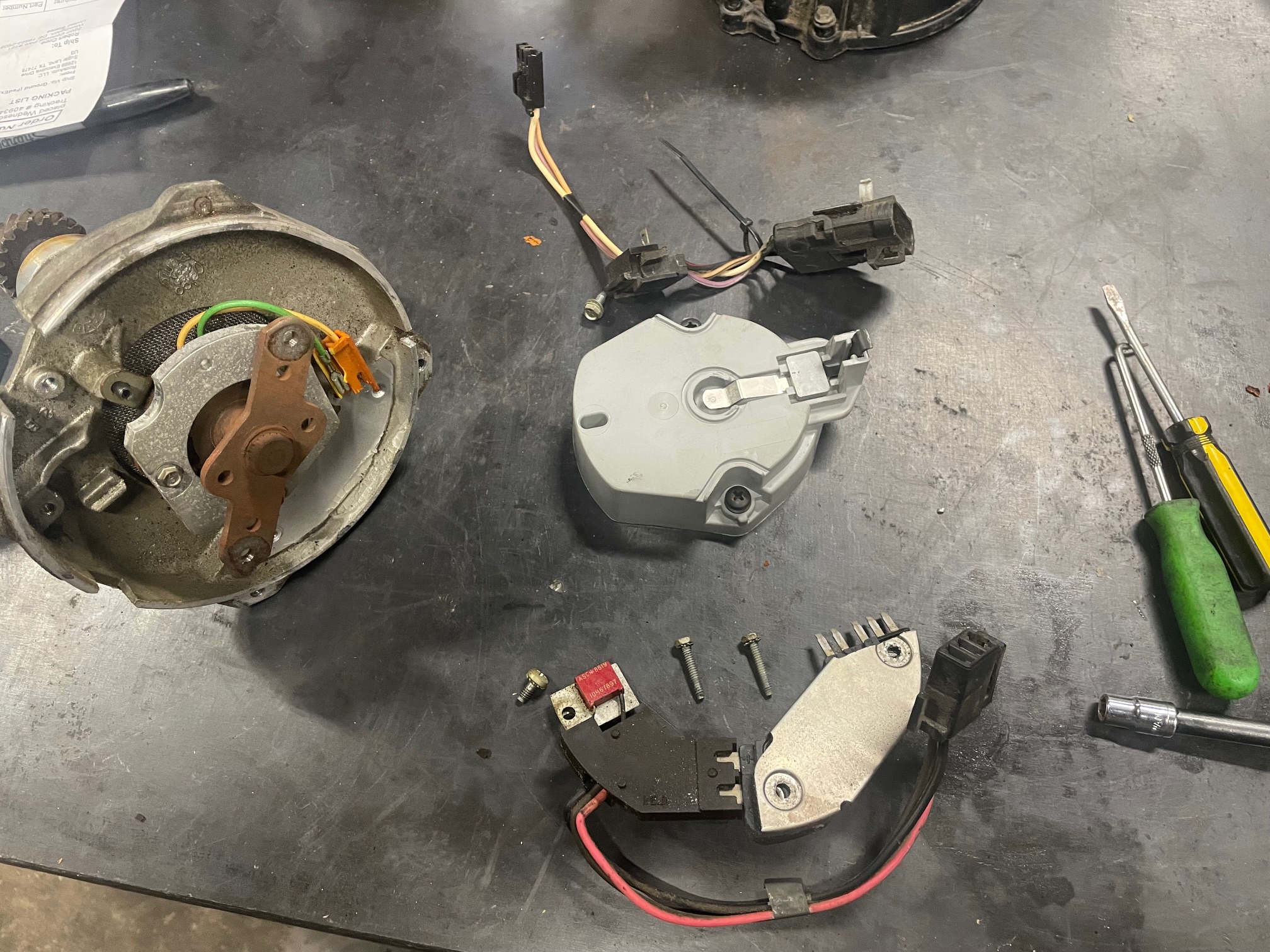

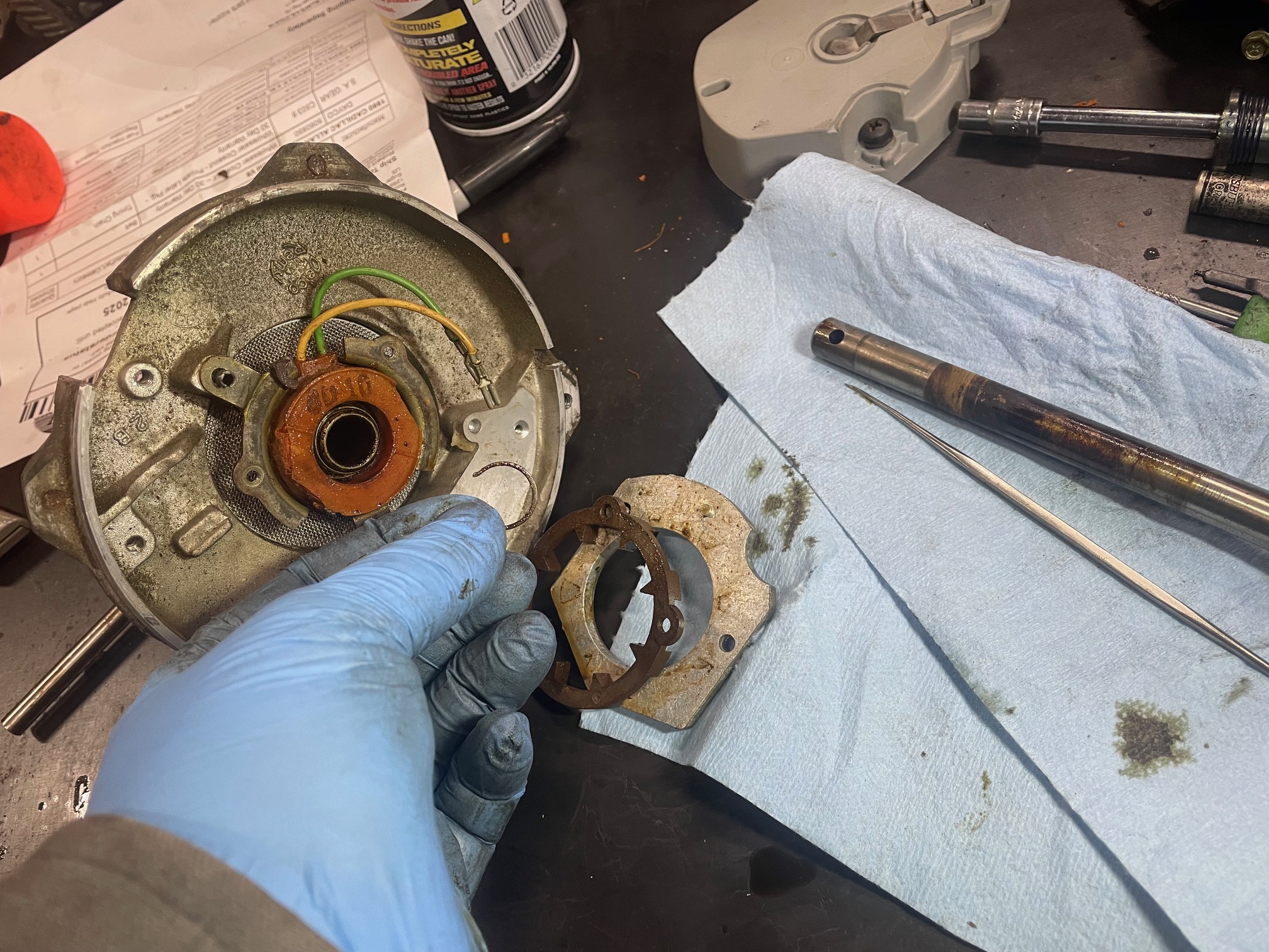

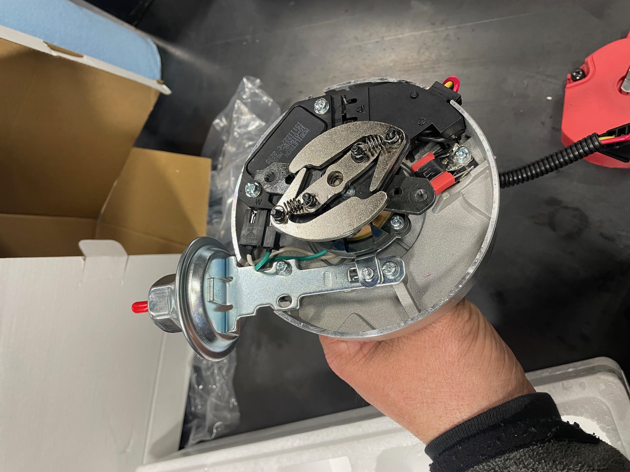

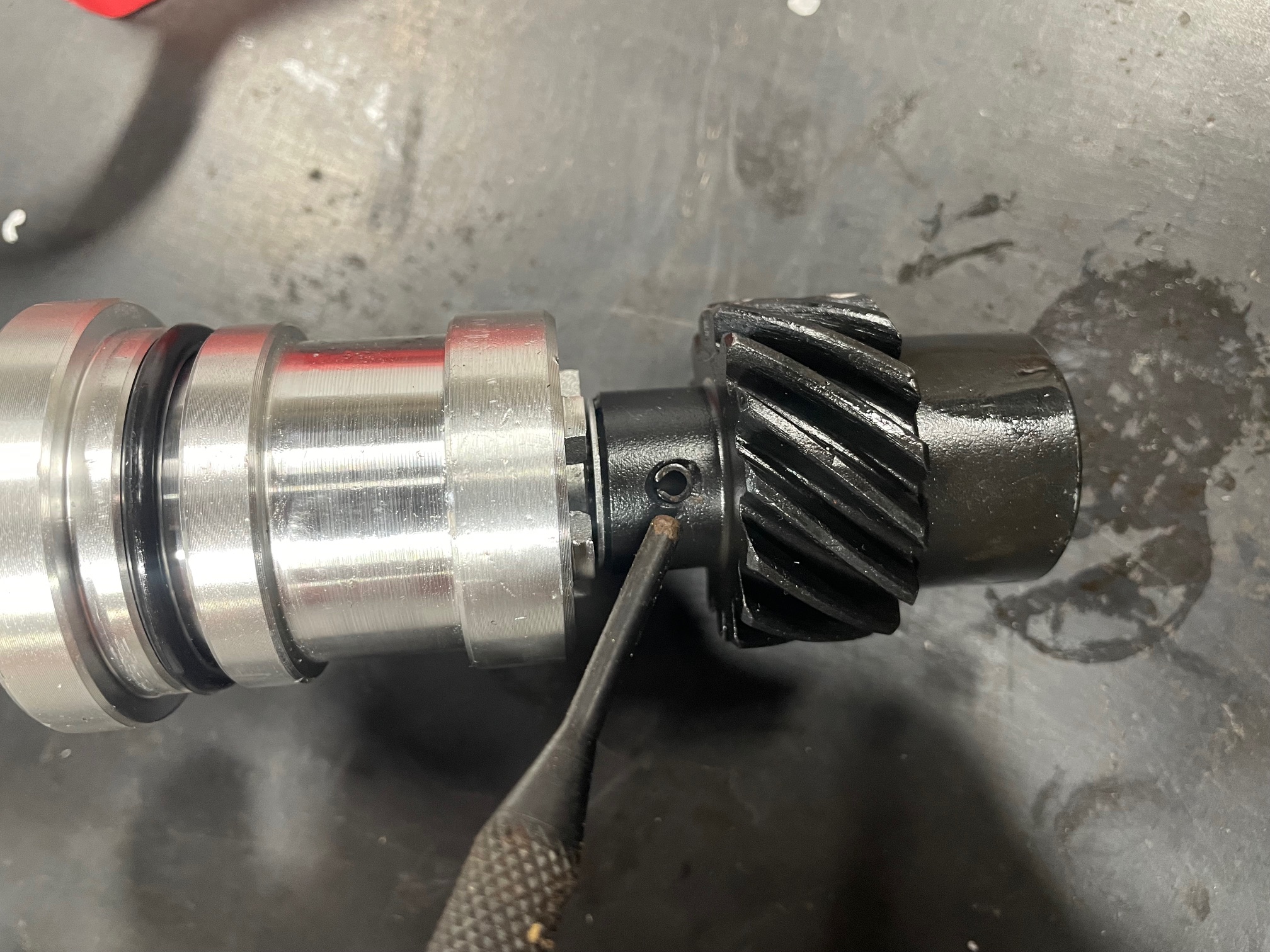

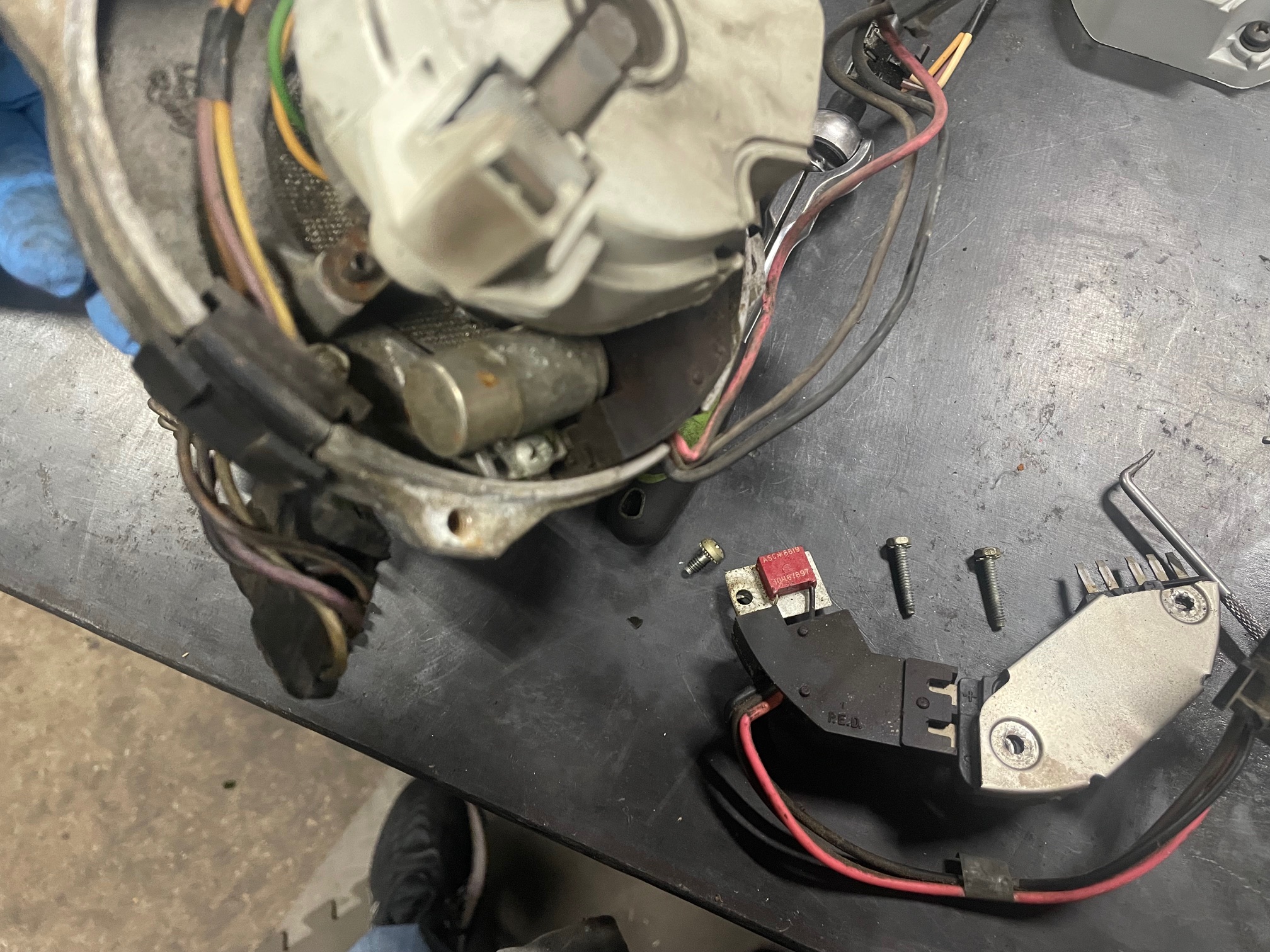

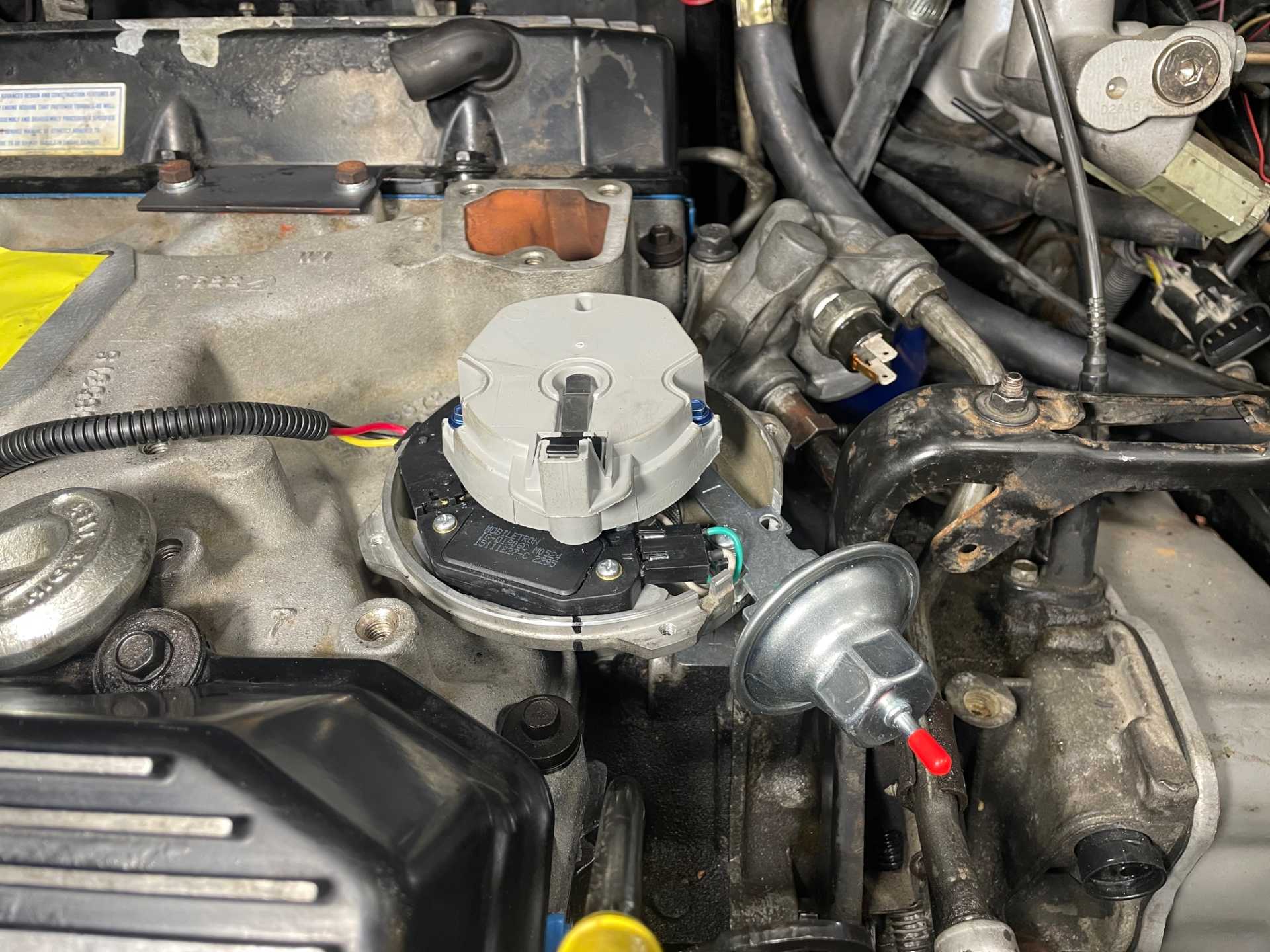

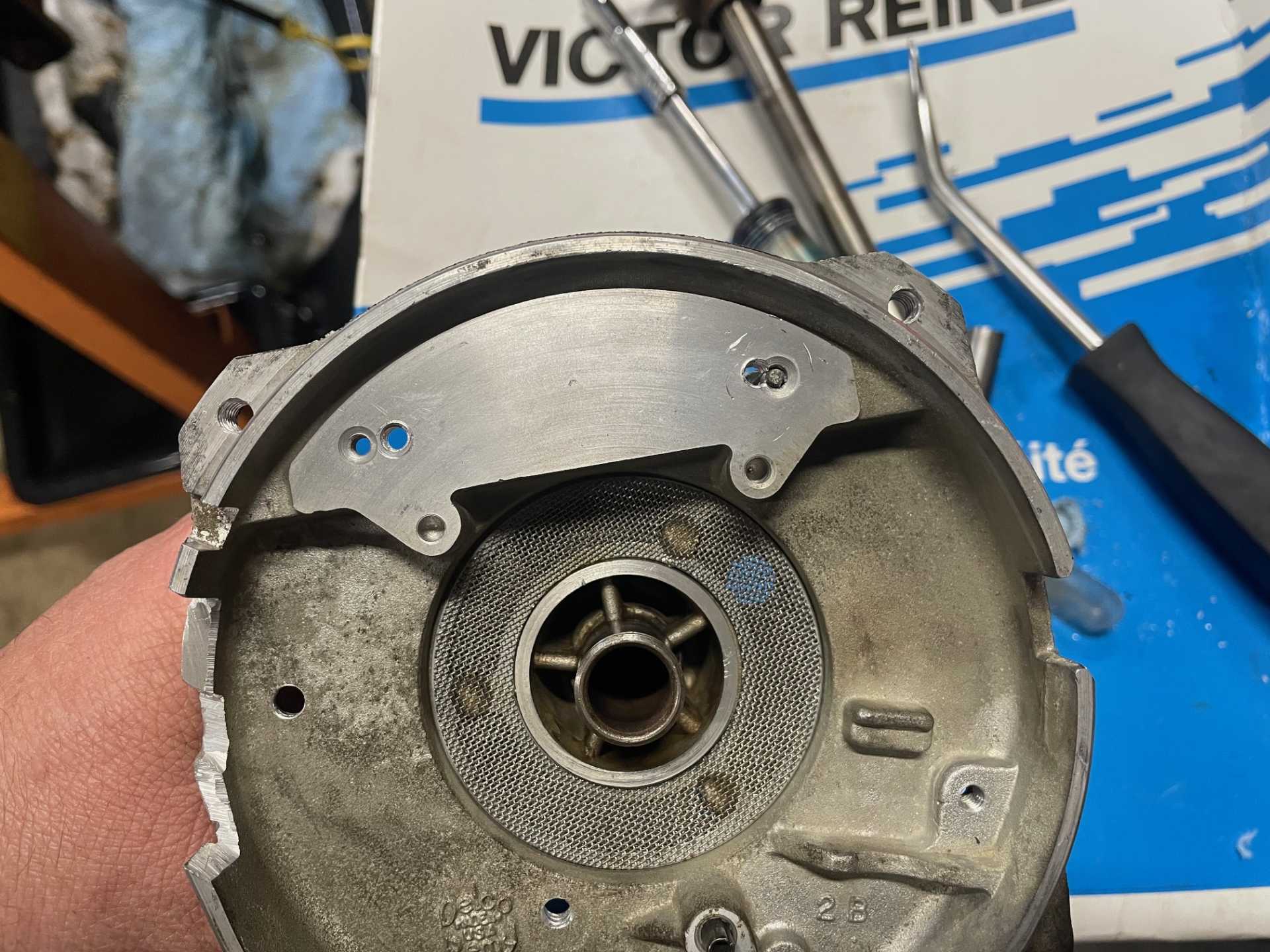

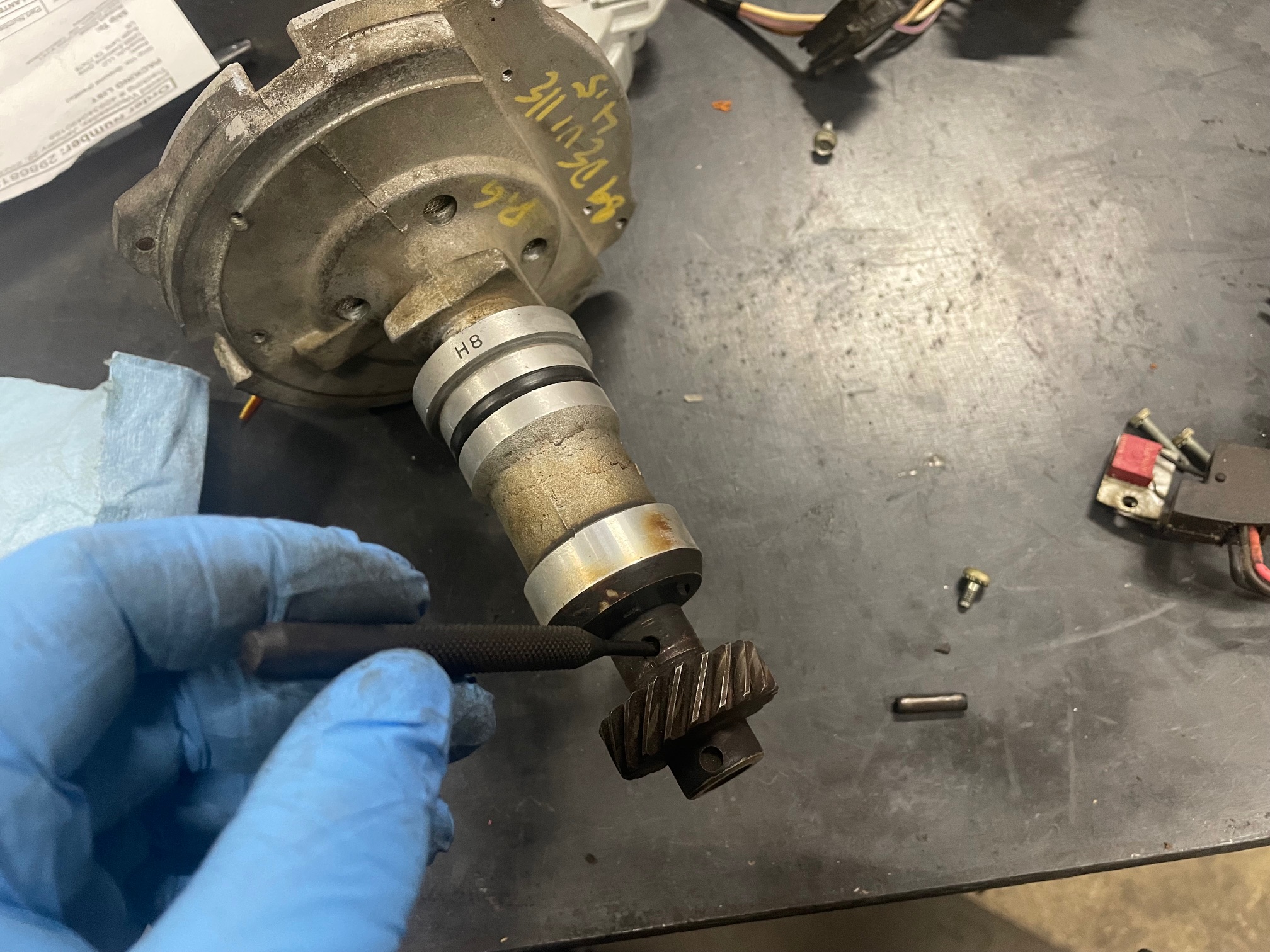

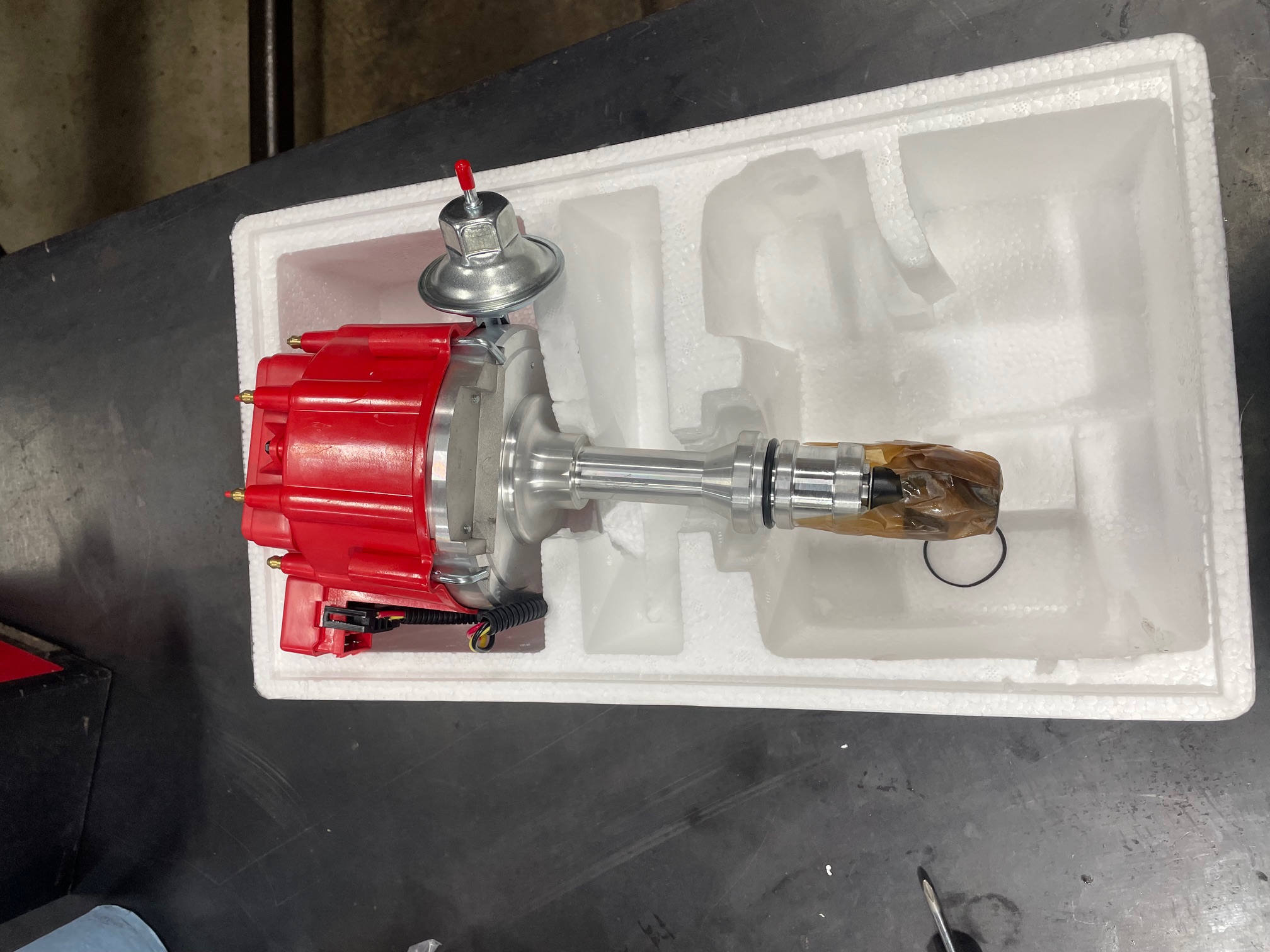

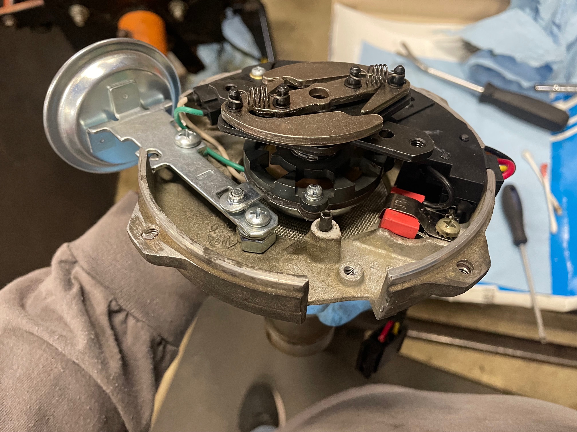

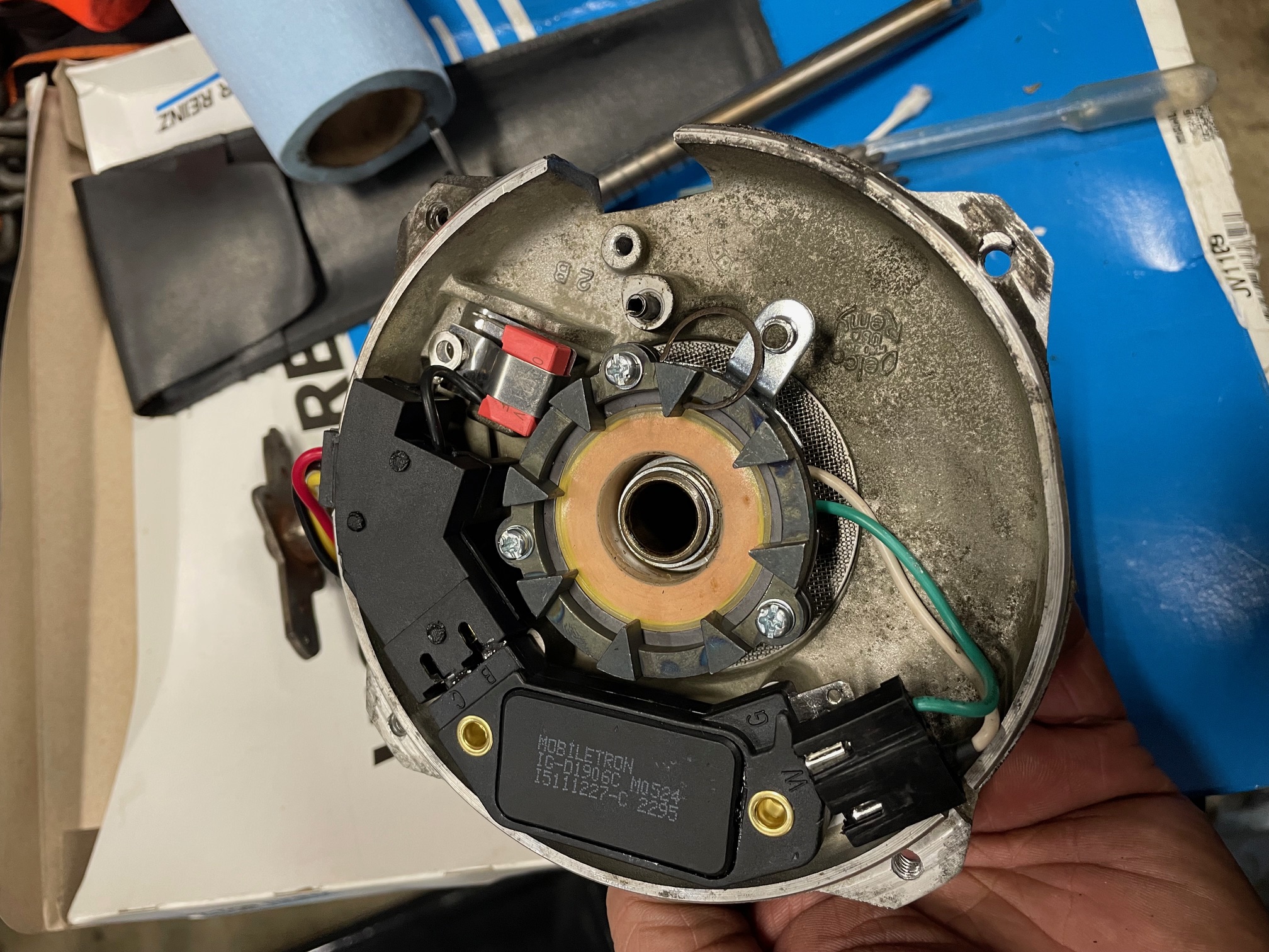

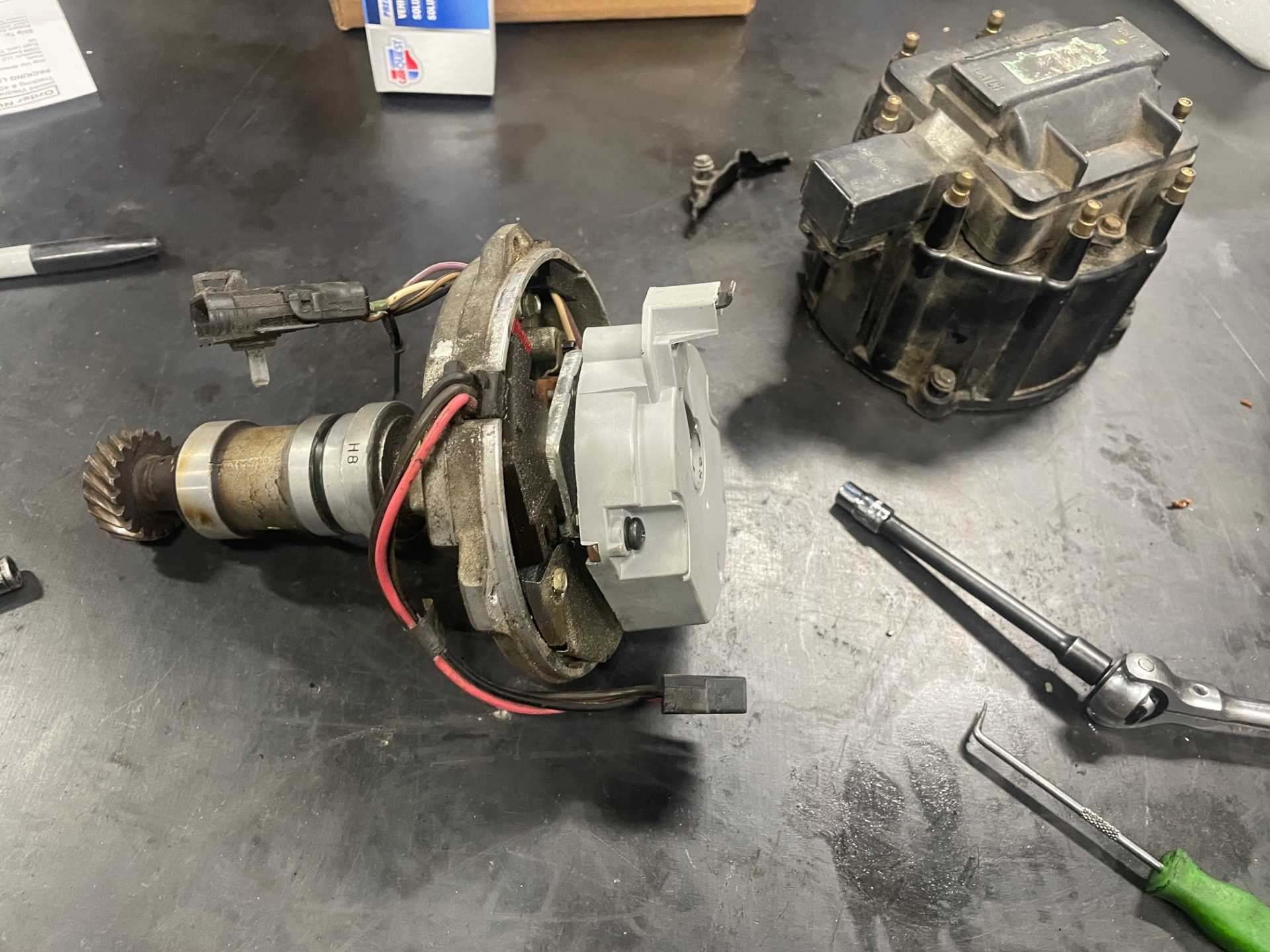

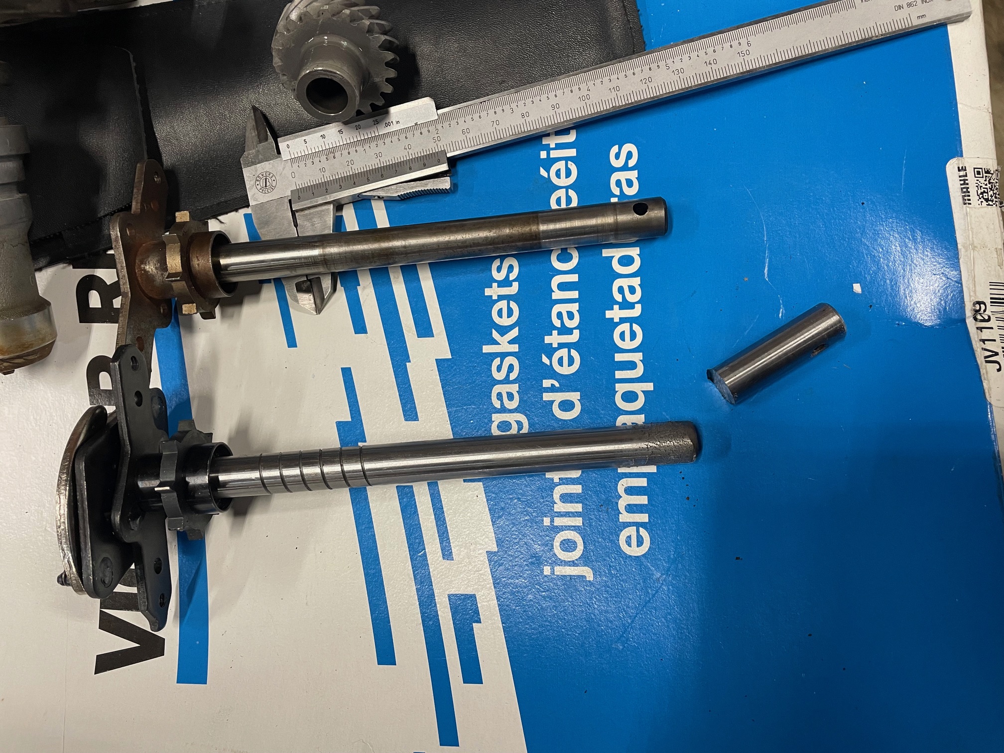

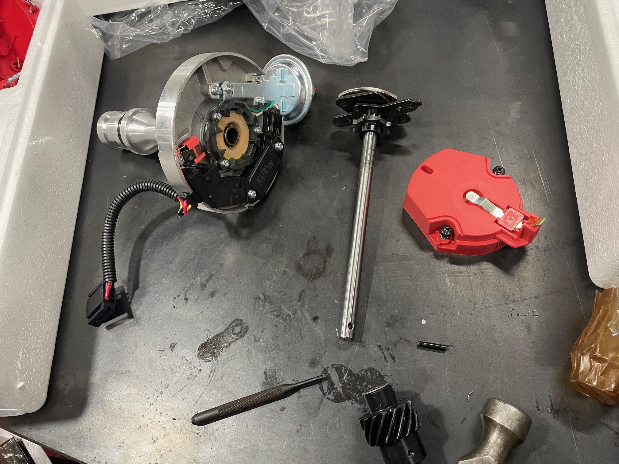

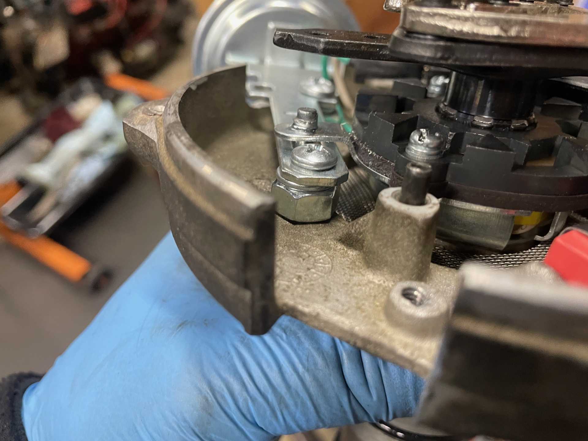

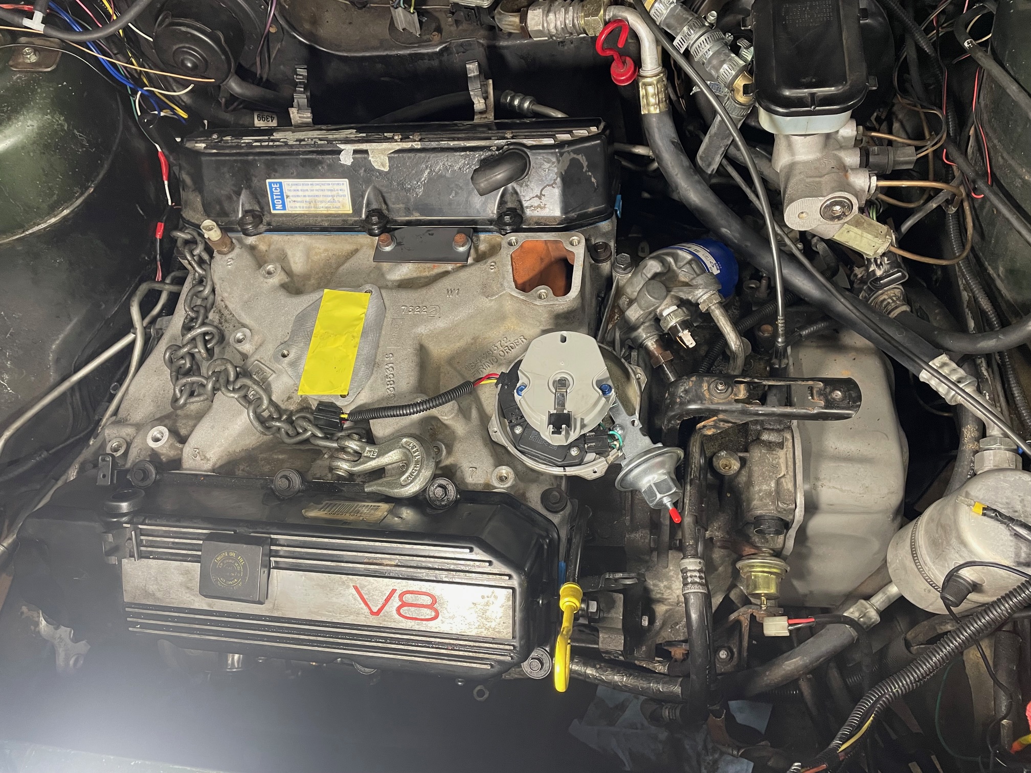

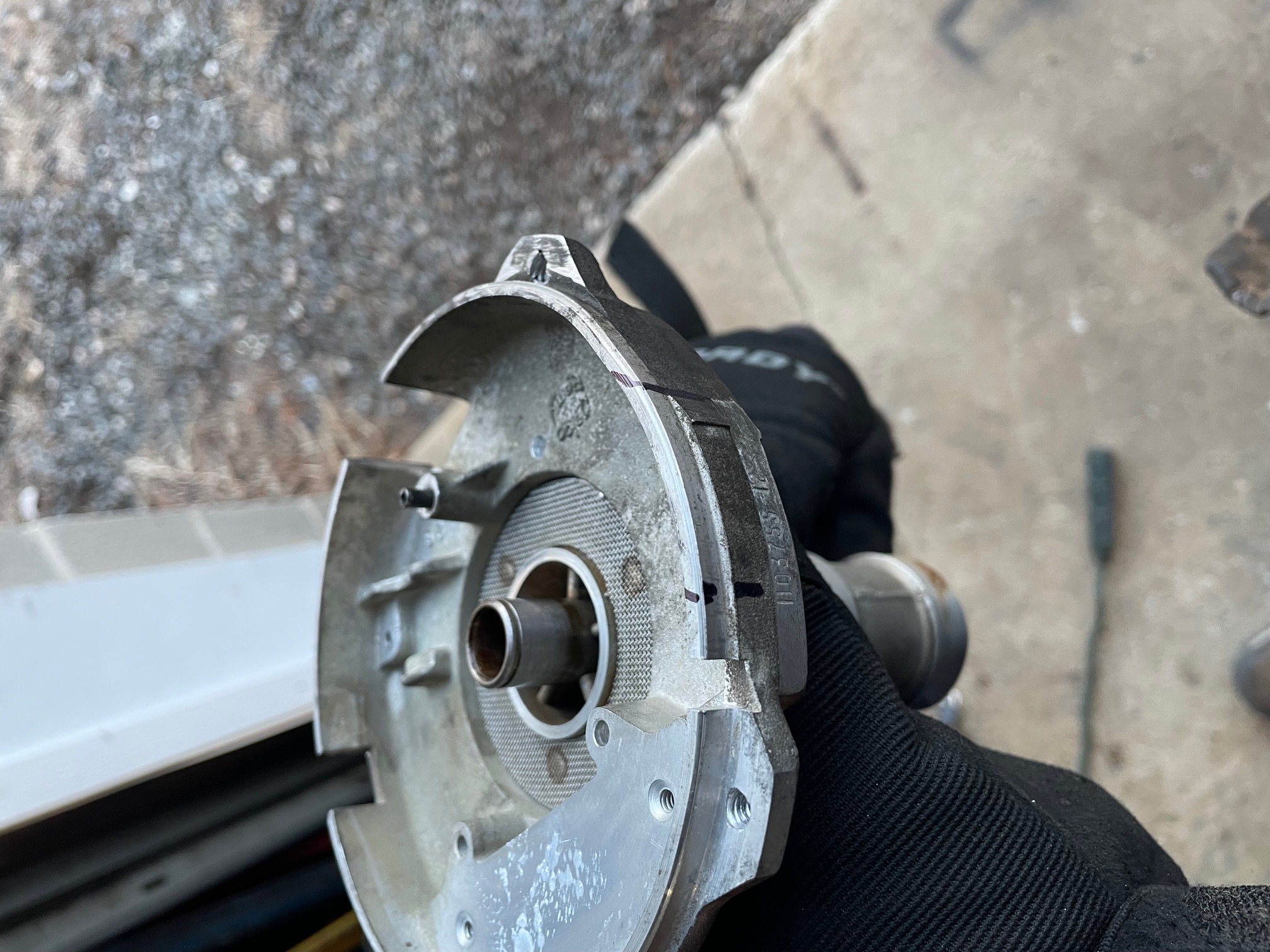

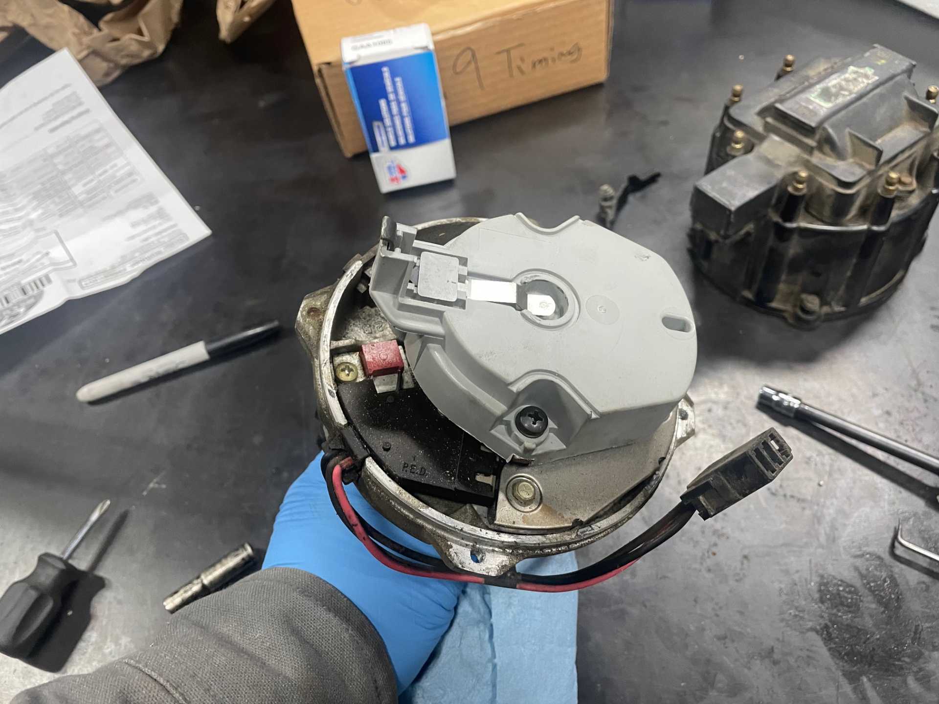

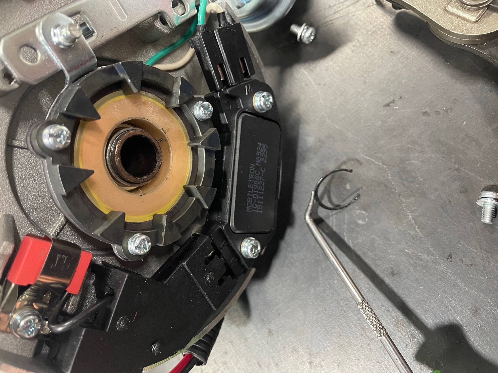

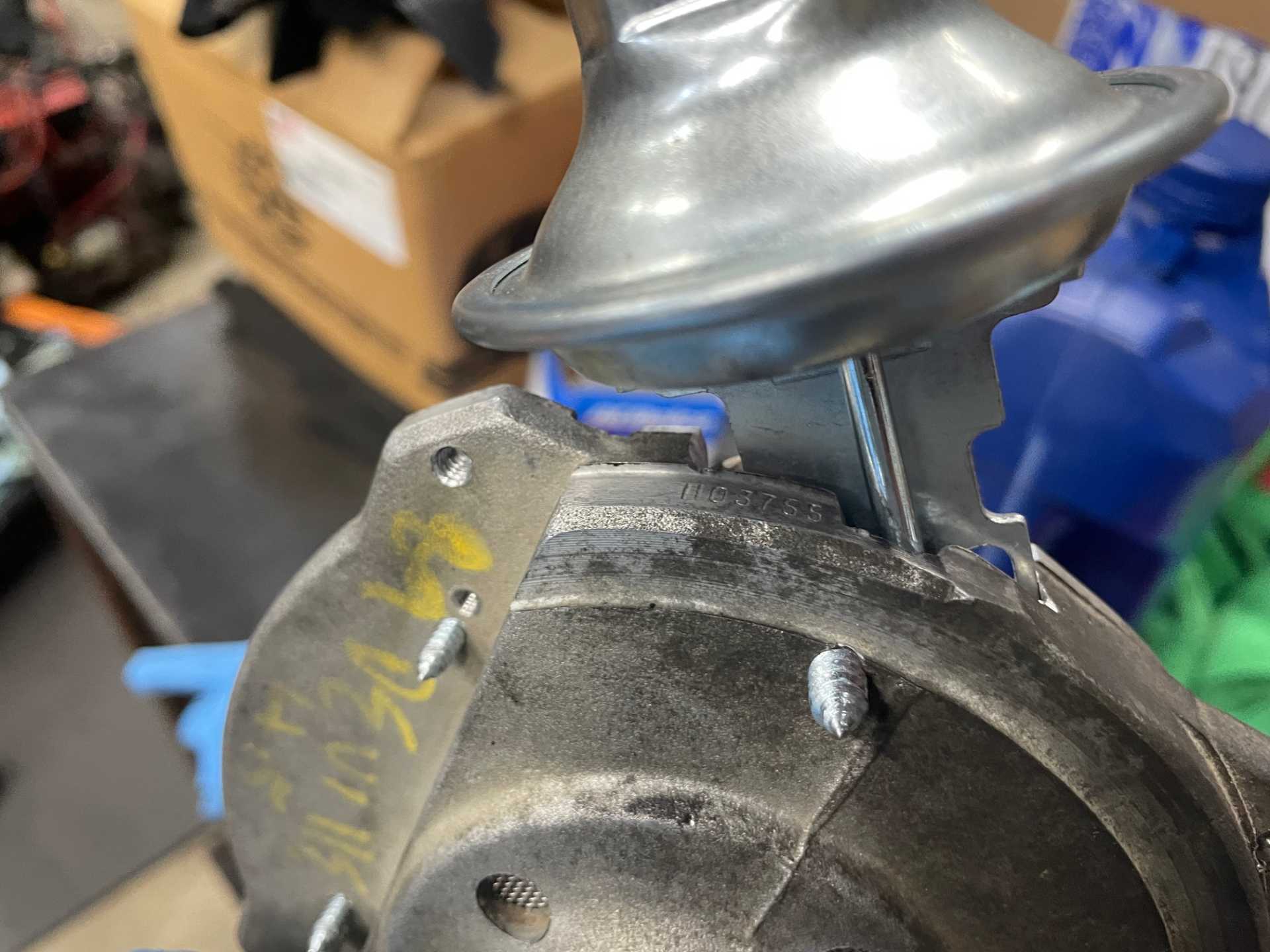

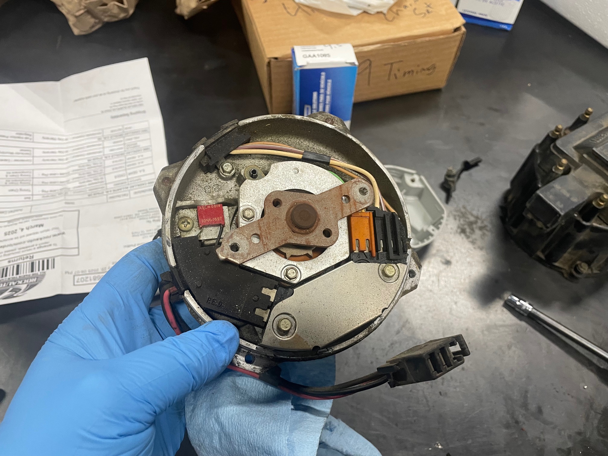

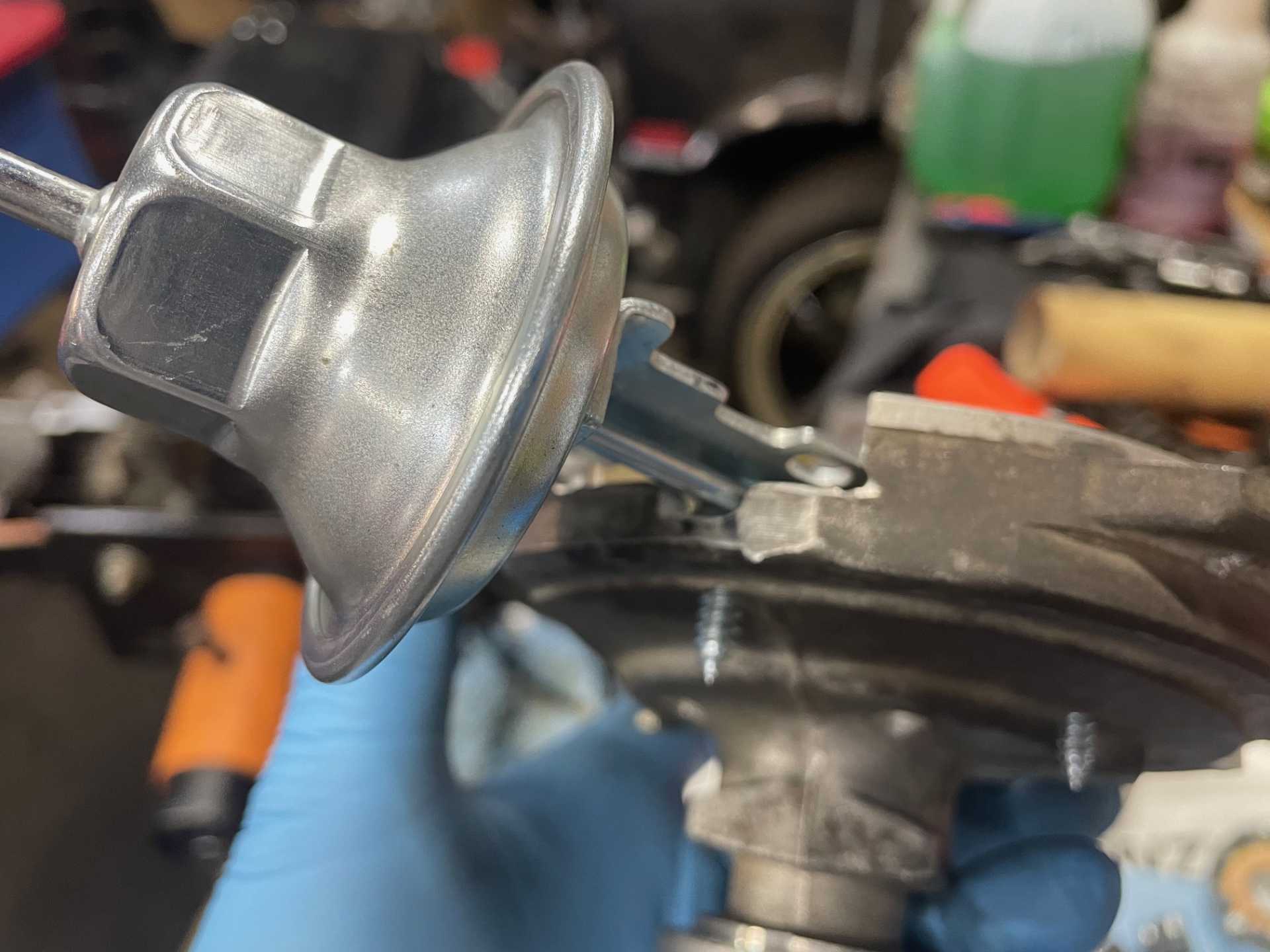

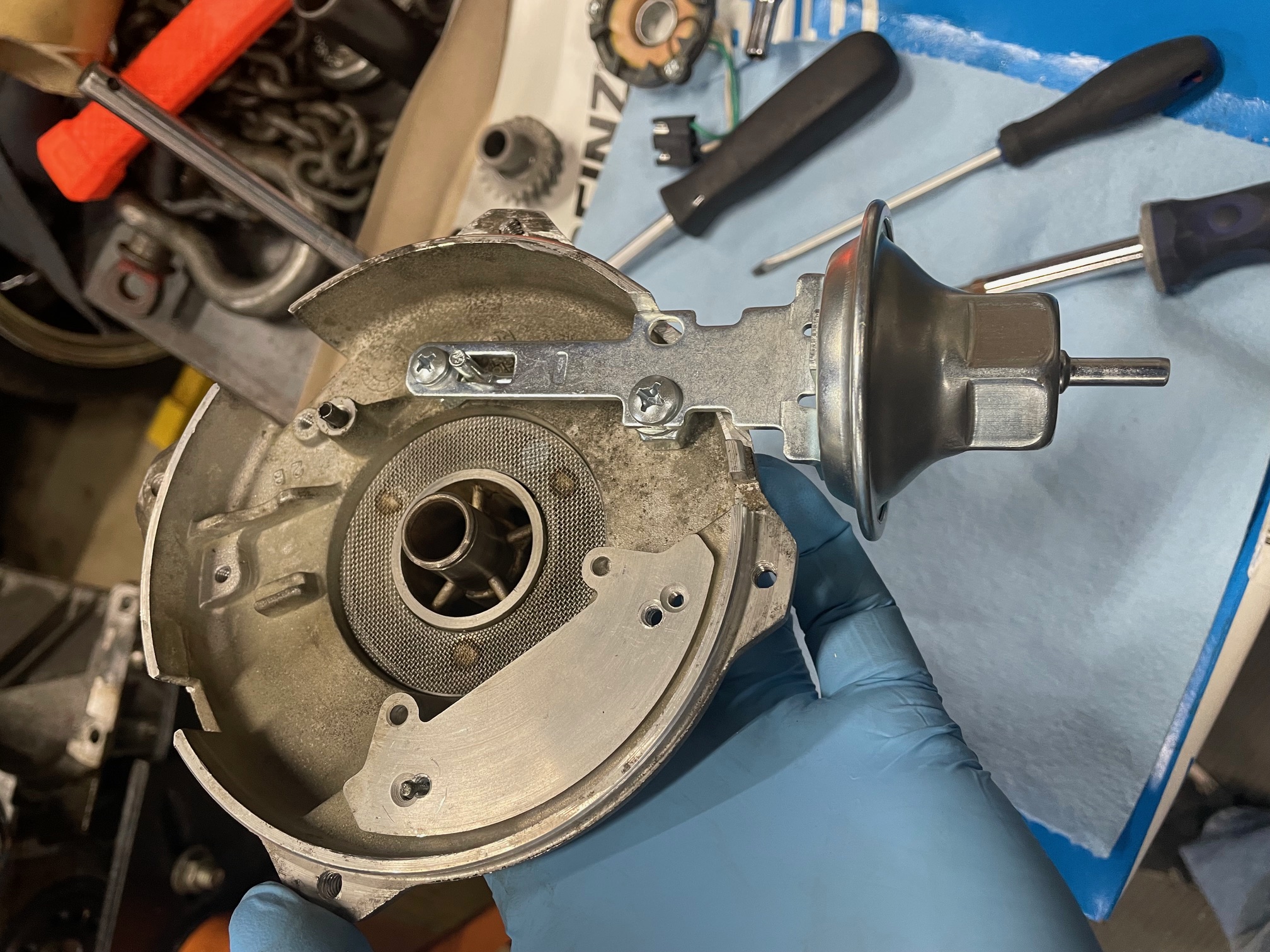

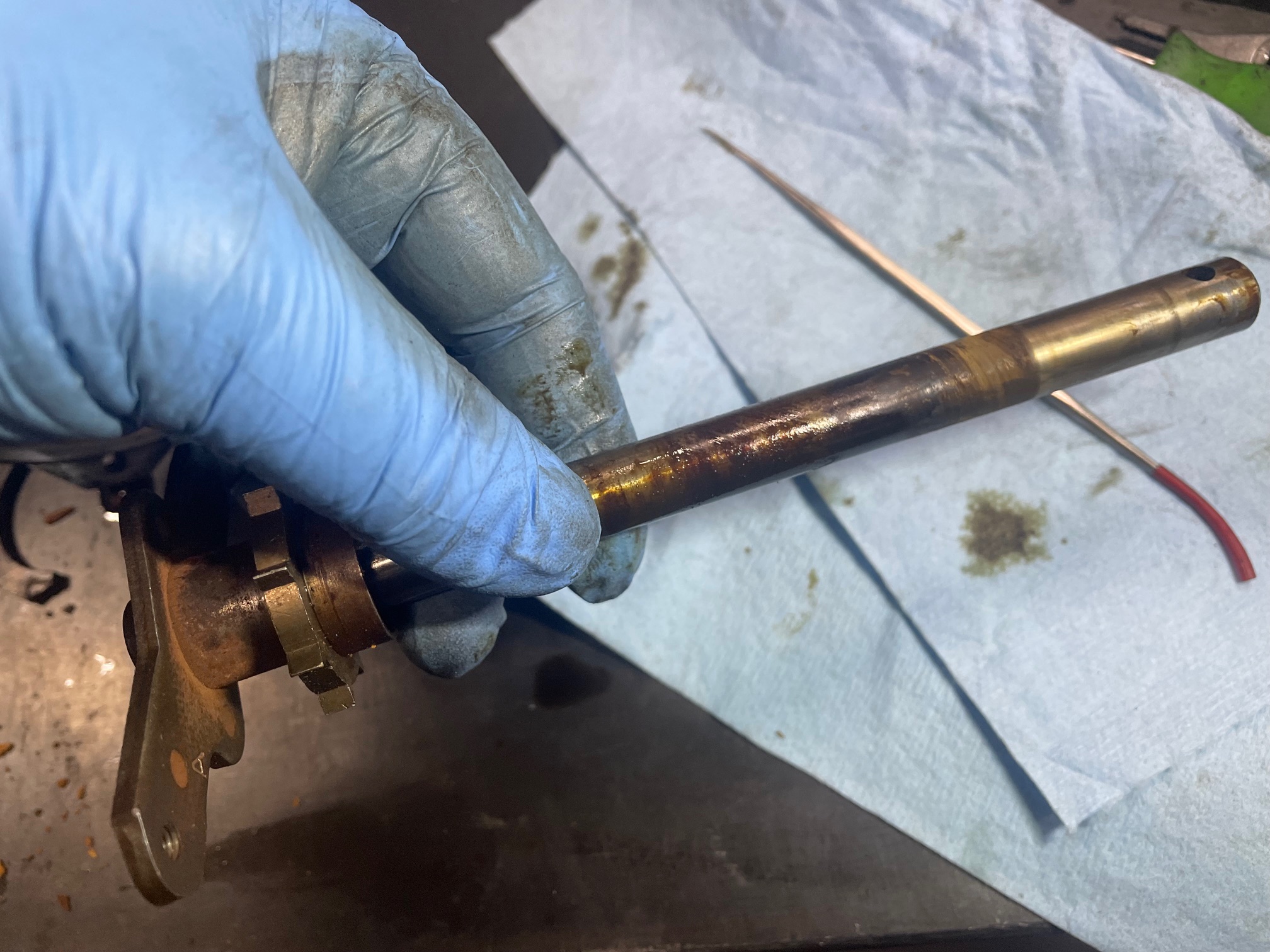

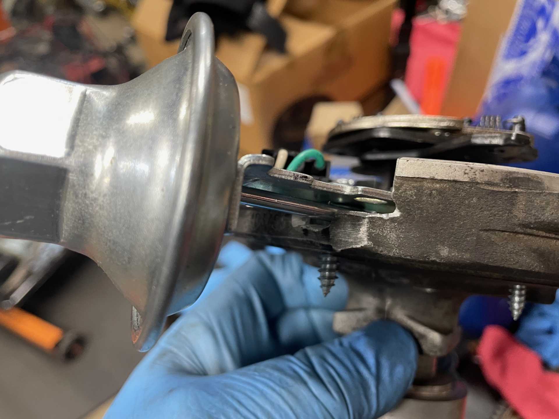

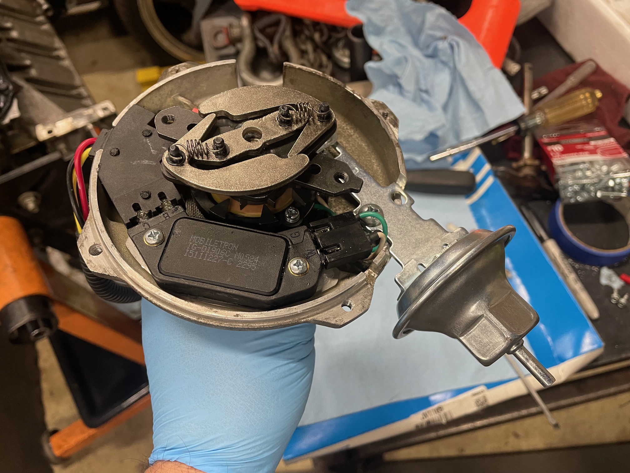

Hey everyone,
I was looking to convert a Cadillac 4.5 distributor to vacuum advance and found they do not have aftermarket options, but thankfully the answer is on the Pennock’s forum. A few members here figured out converting the Caddy distributors to vacuum advance in order to run carburetors, which is great but their threads lost the pics years ago because they were links to Photobucket, etc. I will upload photos of the process in the hope they stay searchable for others. Credit for the original solution to BubbaJoeXXX, Capt Fiero and anyone else that helped.
The conversion is cheap and fairly straight forward. I purchased a new Oldsmobile OLDS V8 HEI Distributor for 260 307 350 403 455 Engine 1968-1976 on eBay for $50 to use for parts. The only other things I needed were screws and spacers, which I already had packs of. The photos should say it all, key things being to not lose the 'C' clips, then mark and cut the Caddy distributor with cutting disc, then cut Olds shaft and drill roll pin hole for drive gear. I used #8 & #10 self tapping screwing to set the vacuum module and #6 for the 4 pin ignition module. I swapped to straight screws with 5/16 nuts as spacers and lock washers to secure it. Here are detailed pics in series, I’ll post a link to the full swap thread once its up.
Cheers

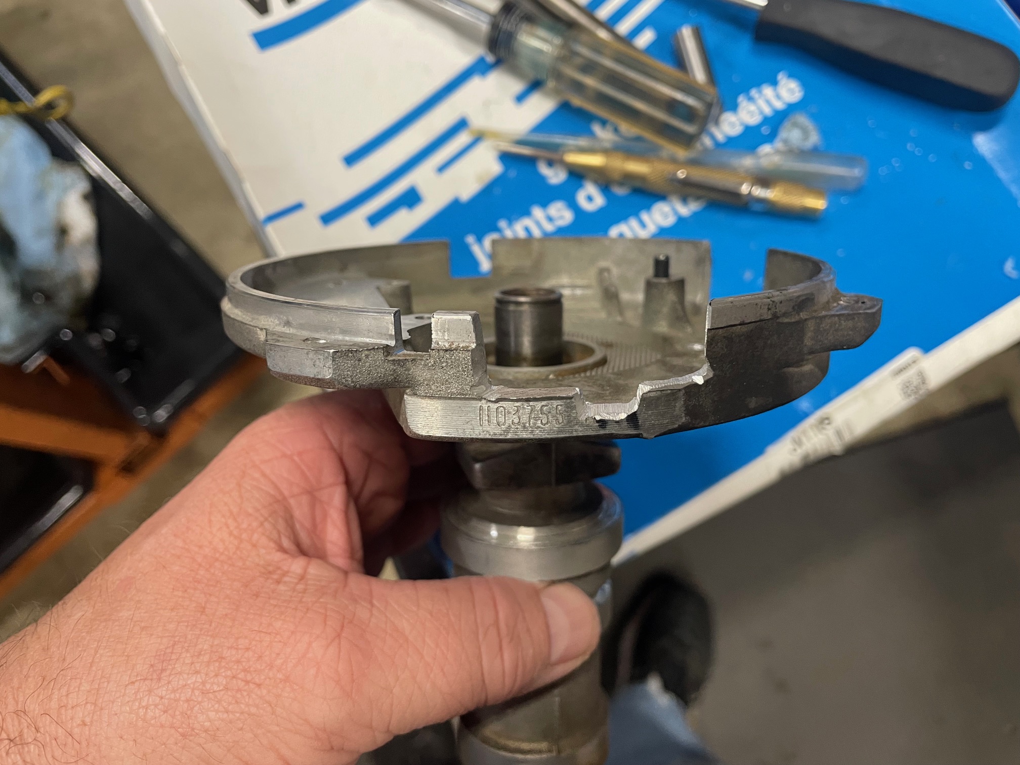

Thanks guys. I have several 4.9 swaps, this one is budget oriented and probably the best for novice first attempts - working on swap post that has the details. I plan to upgrade the ignition, but needed this to get started and wanted to document it for others. I've been driving it for a couple weeks now and it works well.
Also, I added a pic I missed of the cut shaft.
Cheers
