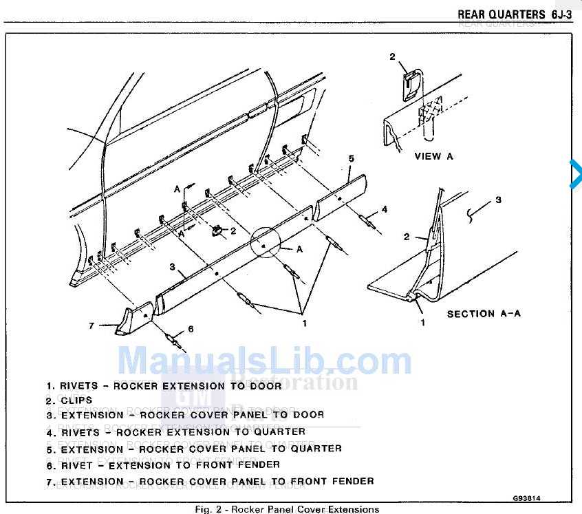

I believe you're talking about the rocker extension to the door....
The service manual has a illustration in the body section on page 6J-3

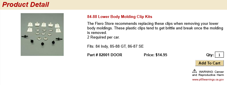

Here's the Fiero Store link to the fasteners. They are the Lower Body Molding Clip Kits and you select the fender, door, or quarter when ordering. The photo I posted is for the door kit as you can tell by the part number.

If your just removing the aero. panel, open the door, with a chisel pop the heads off the half dozen or so plastic rivets that's in the bottom and simply lift the panel up. Once that is off there is what I assume is a stainless steel mounting bracket that's also plastic riveted to the door panel.
