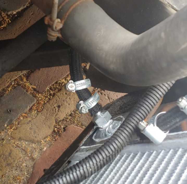

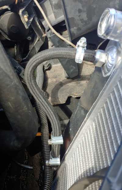

Back on track, the weather is clearing up here so I'm preparing to finish the job. I have three things left to do.
1) Connect lower transmission line
That one is easy. I'll just cut the transmission line at the yellow line, then use a piece of transmission oil grade rubber hose to connect the two
2) Connect upper transmission line
This one is going to be harder and I have a few concerns about this one. I need to connect these two:
I cannot simply use a single rubber hose, since it will pinch:
If the radiator would have the proper fittings, I would be able to use the original piece of transmission line:
So here's my dilemma. I can cut this piece up and only use the bend.
But that means I can't use that piece anymore if I ever choose to go back to a radiator with stock fittings. So I will have to find a piece of metal tubing with a bend of the right size instead. So not sure what to do here yet.

Tubing bender and a piece of brake line to make what you need. You really should adapt a stock fan shroud for the aftermarket fan if you can locate an old OE fan assembly. You tube shows you how.

I'd be concerned about the straight cut lines leaking a bit, but they should be fine to get the car back home a few miles. Ideally you'd want to flare the ends, so they look like the ends on the radiator.
I'd also make sure to use hose that's rated for transmission fluid, no telling what was in there before if it isn't marked.

Remove that nipple thing, it is pointing the wrong way already, you probably can find a 90 degree elbow with the same threadsize and a hose adapter at a normal hardwarestore. No need to make it more complicated.
That looks like a screw they put in to prevent the radiator from draining after they broke the tube and forgot to remove it when installing the rubber hose.

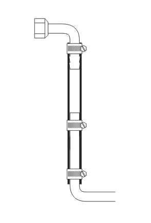

Fix:
1. again, need solder bumps etc so rubber won't slide off.
2. just bent the trans line back some so rubber has a bigger radius to bend. or use a "weak" spring outside of rubber for bending tighter radius. Spring stay there. Or use both if needed. Proper J1532 hose needs 6-8 inches or more radius to bend w/o pinching w/o extra support. A little tighter w/ support.
3. If save the hard line bend, use compression fitting to joint bottom part. Will still need to bend bottom section for clearance.
4. Look like the fan "body" edge will fit under w/ some effort w/o distortion when done. If fan "body" won't clear, If you cut/grind the rad frame only cut bare minimum to fix that problem. Or use spacers on the mounting screw points.

I'm certainly not suggesting that flaring the ends of the metal tubes or adding a bit of solder to them is a bad idea to help keep the hoses on, but the fluid pressure through the transmission cooling lines is minimal. I simply double-clamped the hoses on a repair I made to the transmission cooling lines on my '86 GT years ago and it's never had an issue.

I don't see why you couldn't use the single rubber hose - add some more slack with a slightly longer hose, with a strain relief. It's not high pressure, so as long as your line isn't kinked, you should be all set.
May not "blow off" now because so low pressure or other reasons...
If the line(s) get a little to completely crush/pinched then enough pressure to blow off and quickly drain the Trans while you drive.
Remember Oil Dumping method in cave to change AT oil? In takes < ~ 15 minute to pump the trans dry.
Yes, the trans may may shift "wrong" etc w/ restricted flow but better then running out of trans oil on the highway.
And Ignoring other possible problems causing an oil slick on the road...
Short straight sections w/ minimum gap to span is different then any big gap w/ or w/o bending the hose too.
I was actually thinking of putting the hose on all the way to the bottom bend so it can't slide off. That also gives me some room to use two or even more clamps. Like this:
Yes, that's probably what I'll end up doing if I can't find a bent nipple.
Last night I thought of another problem. I don't think I can even screw it in anymore. With the old radiator, there was room between the top of the radiator and the bracket since it had the rubber pads between them. Now that space is gone and the screws will now actually screw into the radiator? I''m not sure since I haven't checked it yet, but if that is the case, I need to think of another way to put the fan in place.
top & bottom frames on the radiator has notches/holes that should clear the screws for the fan.
Look at mounting holes and see they align w/ those. If needed use a "WD40" can straw or anything fairly soft & flexible and careful poke the mounting holes.
Long hose plan maybe ok. if the gap is short more so. And If "floating" section have nowhere to go.
If 2 sections of hard line can touch or nearly so then compression fitting is better for a given joint. The fitting has a "stop" in the middle and depending on exact fitting type/design the Gap between stops in them can be near 0 to 2+cm. So make sure all parts fit before tightening anything.
But I won't use them on rad fitting even if you trim the hose barb off because of vibration can make Al tube to work lose in the metal olive. ("they" make Plastic olives for normal plumbing for plastic and other very soft tubing but is not rated for oil coolant etc.)

It's alive!
I ended up using a fuel hose because the parts store didn't have hoses for transmission oil. But I needed the car back at my place so I can more easily work on it. I've read on many places that you can't use fuel hoses as a (partial) replacement for a transmission line, but mainly because it can't handle pressure over 30psi. Now I might be wrong but I think the pressure in the transmission lines in the Fiero is waaaaay less than that. So for now I see this as a temporary fix until I can find the proper hoses. [b]Unless y'all thing the fuel hose is fine?[b]
Anyways, this is how the top is connected:
And at first I had the bottom like this:
But when ran the engine, that was leaking transmission fluid. Turned out the top clamp wasn't actually over the transmission line, so I moved it further back and it stopped leaking.
I do have what looks like a very, very small leak at the top outlet coolant hose. But just really a few drops. I tightened the clamp but it still leaks. But again just a few drops, nothing serious. I think the hose is just old and needs to be replaced. I will scour the internet for new hoses. But yeah, it's alive again!

The bends above should be ok.
Fuel line can fail for trans oil. Change it soon.
Amazon and others have SAE j1532 hose.
Note: SAE j1532 hose can not be used as Fuel hose as Hates Ethanol and other gas additives. Remember Have cleaners etc built into fuel before selling it or store additives can have Alcohol and other things "eating" trans hose and many others.

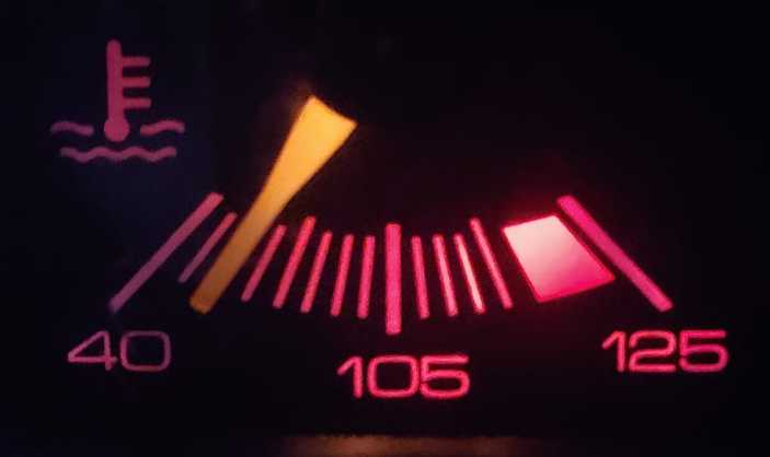

Report this Post08-19-2023 04:07 PM Click Here to See the Profile for Cliff PennockClick Here to visit Cliff Pennock's HomePageSend a Private Message to Cliff PennockEdit/Delete MessageReply w/QuoteDirect Link to This Post
Originally posted by sdgdf:
Run it with no thermostat and a really aggressive fan switch? Just keep that fan on. If it still has temperature swings with that it seems like you have some other kink in your system.
I've ran it without thermostat before, and that made no difference. But today I had to make a longer trip than normal (about 80 miles both ways, mostly highway) and on the way there I had huge temperature swings for the first 20 minutes. Temperature rose to beyond the red in about 10 seconds, stayed there for another 10 seconds, then dropped to about 160*F in about 2 seconds. And that repeated itself for 20 minutes after which the temperature stabilized at around 175*F. The temperature light came on each time the needle was past the red and turned off when temperature was dropping (but still in the red)
But on the way back, things got really weird.
First of all, it never stabilized during the 1.5 hour trip. It kept fluctuating between beyond the red and about 160*F. But it looked like the temperature light was living its own live. Sometimes it came on when the gauge was showing 220*F* (but slowly rising), stayed on and wouldn't go out until temp dropped all the way to 160*F.
Then as soon as I got off the highway and drove with speeds of around 30mph, temperature dropped all the way down to something ridiculously low and stayed there:
PS: my temp gauge is in Celcius. 40*C = ~100*F, 105*C = ~220F, 125*C = ~260*F
As you can see, it shows around 56*C or about 133*F. But oddly enough the radiator fan was on, even though the gauge showed such a low temperature.
So I'm not entirely sure when the temperature warning light comes on (what does it measure? Coolant temperature or oil temperature?).
And apparently, there's a huge difference between the sensors for the temperature gauge and the radiator fan.
