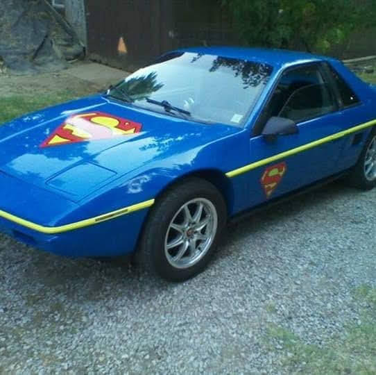

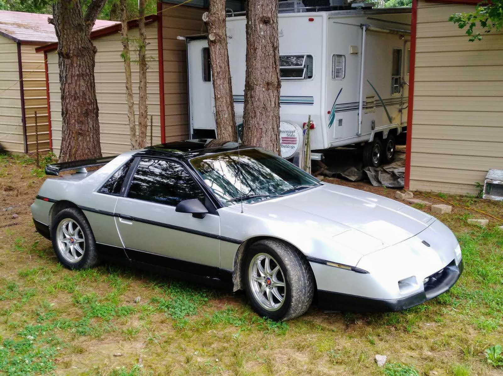

I didn't say I was giving up on it
I do have 2 fieros
