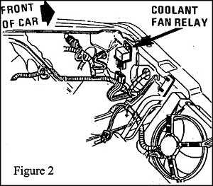

Here we go again! I found a wiring diagram with color coding for the relay. The burnt relay is NOT for the fuel pump! My car, and the extra motor, have two relays side by side. One for the fuel pump ( five wire connector) which appears to be in good shape, and the other one with 4 wire connector which is burnt. That is the one I need to figure out. What is this relay for? I do not have an air conditioned car.
Yes, I understand that you only have two relays on the firewall... but I found a couple of posts that state the left side relay (not labeled in the diagram) is for the cooling fan(s).
Just to confuse the issue further...
The difference in locations mentioned for the cooling fan relays might be dependent on the year of the Fiero.
[This message has been edited by Patrick (edited 02-13-2023).]

Report this Post02-13-2023 07:00 PM Click Here to See the Profile for stevep914Send a Private Message to stevep914Edit/Delete MessageReply w/QuoteDirect Link to This Post
Thanks, now I have found a diagram identifying the colors of wires coming out of the connector off my spare motor ( it was an air conditioned car) That one was for the A/C compressor. The burnt one on my car has no factory color coded original wires, but appears to have been set up to power the two cooling fans in the engine compartment. They were not working after my problem happened; tracing the power wires from the fans led to this relay. So now, unless that relay is responsible for something else as well, I am back to what the real problem with the car is again!

Thanks Patrick, got at this on my day off, and wired the fans into a circuit without the relay. I could not find anything going on with the relay when I tried to put power to it. I fused the line at 20 amps, and there is no heating of the wires. ( they are not large fans) Maybe the relay is why the cooling fans quit in the first place. Took the car out for its usual spin, and everything is working perfectly! Despite all the old car grief, it is worth it for the way this car behaves on the twisty road I take it on. I had a stock Fiero which I drove for awhile, and then stripped it for parts. Night and day between how the two cars behave. My Fiero/Ferrari is 1 and 1/2 feet wider, and runs on 245 tires up front, and 275’s on the back, and drives like it is on rails.
Thanks to you, and all who helped me on this. Maybe at some point I will become knowledgeable enough to be able to assist others. Steve
Posts: 70153
From: Copperas Cove Texas
Total ratings: 436
Report this Post02-25-2023 08:41 PM Click Here to See the Profile for maryjaneSend a Private Message to maryjaneEdit/Delete MessageReply w/QuoteDirect Link to This Post
Originally posted by stevep914:
As an afterthought- I think this relay where the three port connecter plugs into the relay is burnt, is the fuel pump relay. My two engine cooling fans are powered by a wire that connects to one of the three female ports on the connecter. If they don’t come on when the ignition is turned on, it would be reasonable to assume the fuel pump is not being activated by the relay either. Could it be this simple why the engine quit? If this were so, the only confusion would be why it all unpowers, when I try to engage the starter.
Am I reading that right, that you (or a previous owner) had the 2 cooling fans connected to the same relay that energizes the fuel pump?
(It all 'unpowered' because you had poor connections that showed to have 12.5 VOLTS but the high resistance connections wouldn't allow enough CURRENT to flow. You can connect 9 AA batteries in series to produce approx 13.5 VOLTS but that doesn't mean they will turn a starter.
The fuel pump relay is fed by a 'hot at all times' orange wire from fuse block (10amp fuse) that transitions to an orange/blk wire at one of the connectors (c-203?) . A good OEM fuel pump probably won't pull but about 6 amps, but those fans have to be included in total current running to and/or thru the relay. They (fans)need to be on their own protected circuit even if you may have gotten by using the power input side of the relay as supply voltage for the fans.
The other thing to remember is that IF the engine is running and IF your oil pressure switch is good, the fuel pump can/will be powered thru the OP switch even if the fuel pump relay fails. But, a major bad connection at battery or at a fusible kink or at the battery junction can prevent the fp from recieving any power.
[This message has been edited by maryjane (edited 02-25-2023).]
