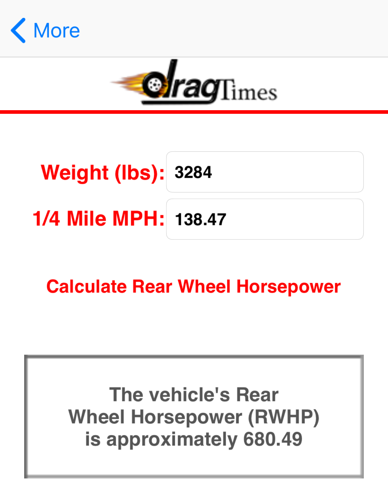

Got the car on a scale today. Scale was reading 20kg when I rolled on, not quite full tank of fuel, with driver. She is a pig lol.
1510-20 = 1490 kg = 3284 lbs
Slightly lighter than I was expecting, but within 50lbs of my estimate.

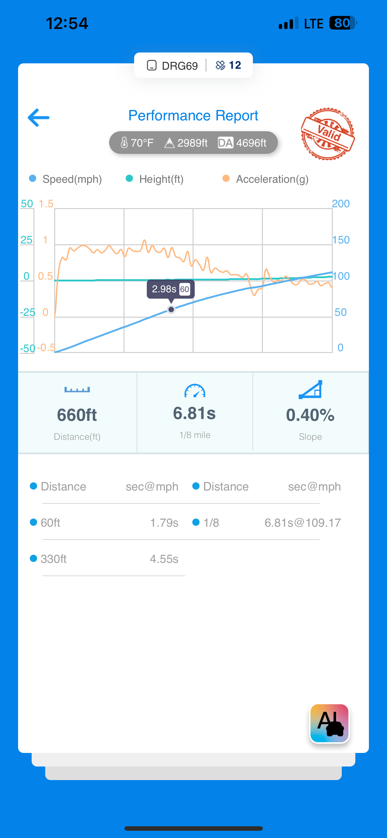

Went and ran a no-prep airport race today, new best 1/8th mile for no-prep, and then another new best. Third run in the cash days race I lost the tire and got driven around, though he probably would have gone around me anyway.
Had a great time, drove home and ready for next outing.
Test pass
First round cash days:
1st round cash days
Second round cash days:
2nd round cash days
Third round cash days:
3rd round cash days - car went left after loosing traction and I let off.
