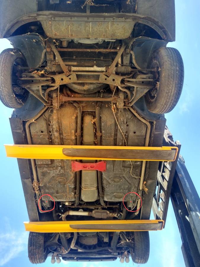

Ok so are you saying the spot in yellow kinda in the circled part called frame body contact hoist ?
https://images.fiero.nl/use...ybax/JackPoints2.gif
1985 Fiero GT
Posts: 1208
From: New Brunswick, Canada
Registered: May 2023
Report this Post06-02-2024 06:40 PM Click Here to See the Profile for 1985 Fiero GTSend a Private Message to 1985 Fiero GTEdit/Delete MessageReply w/QuoteDirect Link to This Post
No, any of the purple locations are good for jackstands, my personal favorite is the one right by that rear yellow one, poor picture, but circled with a dot right where it would go, look on yours and you'll see a natural spot the curved jackstand fits on.
For jacking it up, use a jack in the center of the rear of the cradle, place it on the stands, chock the wheels, place some wood or something else under if the jackstands fail, then you can use the hydraulic floor jack on the front center then rear center of the cradle to raise and lower one end at a time as needed (make sure you are on a smooth floor and the jack can roll, or it will pull the car off the stands), also make sure the dogbone is disconnected, and beware of cables, wires, etc.

Thanks for the photo, that's the spot I think I noticed before.
So disconnect dog bone but that's it.
