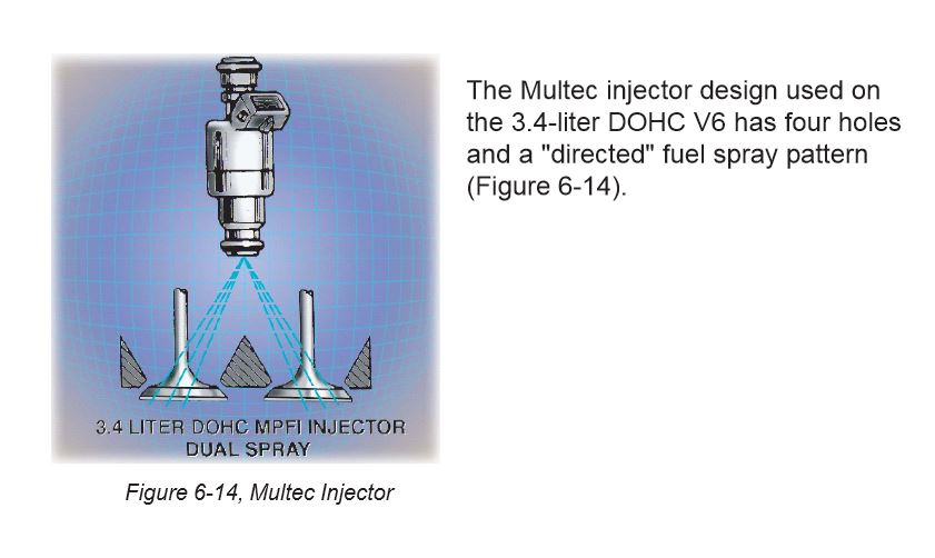

Does that injector spray two plumes of fuel, one towards each intake valve of the DOHC?
With just one intake valve, I think I would prefer an injector that sprays a single plume of fuel.
After running this engine for 20 years, I JUST thought about that after I found the part number this past hour.
Never considered it before (if I knew THEN what I know NOW) and while NOT ideal, it has never presented a problem.
Clearly the shop that got them for me considered the flow, but overlooked spray pattern as well...
Now considering swapping to OEM 3800 S/C Bosch EV6 injectors - rated at 34 lb.
PN 0-280-155-868 - but spray pattern doesn't fan out much.
