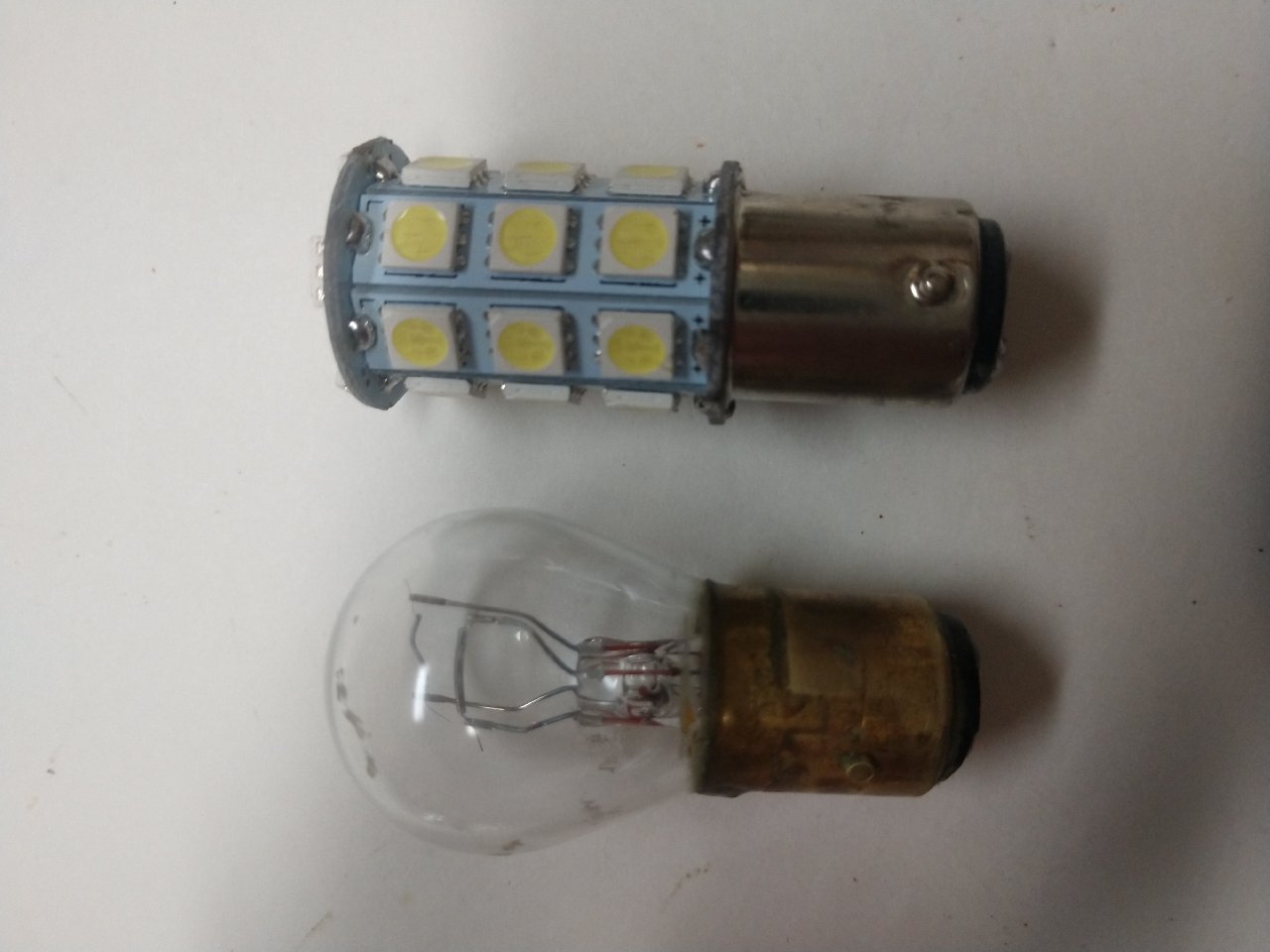

Time to upgrade the tail lights to LED units as they are brighter and use less power. I purchased a pack of 10 of these 25 SMD LED light replacements and they are bright. They will fit the GM sockets but due to the slight ridge where the base meets the LED circuit board the LED jams on the plastic housing by a small amount not allowing it to be pushed all the way in place. . . Tried to slightly grind the ridge away but the bond between circuit board and base is then compromised. Does anyone know if a replacement socket is available that will accept this bulb and fit the Fiero tail light housings?
This one shows the ridge that the LED bulb has not going in the socket
Possible solution is to use the LED bulb in the glass envelop that is shaped like the OEM 2057 bulb.

In one year, you will begin to lose LEDs. Those are crap my good man. Not your fault, just been there done that. The things jiggle like no tomorrow, and bust solders. I went so far as to fix them once, but crapolla.
Edit: The lights have 120 solder joints on them.

I changed mine over to LED's similar to that last year before taking the car across the states. All the lights made it the 4k miles but when I took my lenses off just recetly to change them out to Keith Goodyears I had a couple of the LED's coming apart. While I did not lose any lights it was only a matter of time so be prepared. I am now going to use Danyel's full LED's and ditch the old ones.

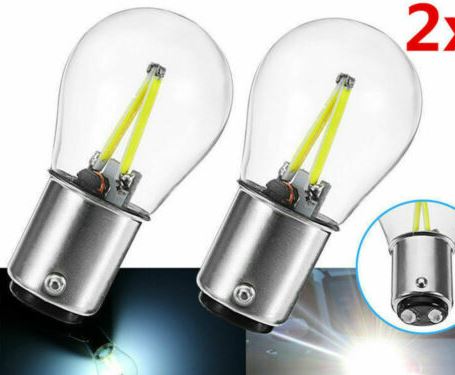

Thanks for the info guys but how about these LED's with the "filament" style COB strips?
or the white red color version. They are supposedly bright
Less connections possibly better reliability?

I like the initial design better than the squared off cree design. Please let us know what you find out. I have been replacing mine with the style you initially posted just due to availability and I can solder a joint properly. It gets old though when you have to continuously check to see if everything works.
That's what I do; I chuck the bulb base in the lathe, then grind away at the base with a Dremel + cutoff wheel.
As required, I would reflow each solder joint with fresh flux + a soldering iron.
For the couple of years I ran this type of LED bulb (constructed from a bunch of printed circuit boards), I didn't run into any reliability issues.

I modified my plastic housings on the socket itself. Just enough to allow the bulb to seat all the way down to turn and lock it in.

Like others, I modified the housing to allow the LED's to fit. I used a round grinding stone to open up the hole. Use Red where the lens is Red, Amber for amber lenses, White for white or clear lenses for best possible light. Makes a big difference on how bright they are. Think of a red lens as a filter only allowing the red component of light to pass through. If you have a white bulb behind it, then maybe 90% of the light is blocked by the lens (only the red wavelengths get through).
Also, if you should convert to Electronic Cruise control, you will need to modify the rear lights to get the cruise to work. Needs a ground interrupt, or just use one old style incandescent bulb in the brake circuit. THe LED's act like a capacitor and hold just enough electricity that the Electronic Cruise thinks the brakes are still on.

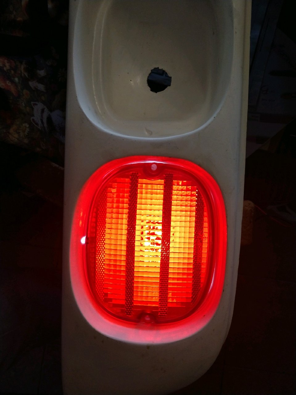

That's what you think. Then why are 100% of all new vehicles coming with LED lighting and they are all made in the same country If I look at the lights on my Chrysler there are probably 200 or so surface mounted devices and no failure in the three that I have owned thru the years. All I know is that compared to incandescent bulbs the LED's are brighter but an electronic flasher must be used.
I'd say this test looks pretty go to me and thats before I painted the interior housing bright silver
This is going to be part of my new Fiero C4 rear tail light panel install
CLICK FOR FULL SIZE
Keep self-justifying your mods all you like...
1. You're comparing aftermarket crap to OEM units that are Build to Meet OEM Specs for Quality etc. IOW complete statement.
2. So many Car's w/ OEMs LED often have failed In and Out of the Warranty period often for same reason(s). Pius and more have iffy Taillights and when fail out of warranty or Denied and cops ticked or failed inspection... Getting replacement thru Dealers can cost Hundreds of $ Each because LEDs are often sealed/bonded to the lens etc.and have to replace the whole assembly then add whatever time/cost to replace... Many are very hard to remove and replace plus often have to remove trim etc not made to remove w/ risk of wrecking them.
Even New Trucklite etc Standard light sizes like 4" and 6" Round made to meet FMVSS use by Many Truck brands have failed only in a few years. Example: T-L PN 44551R 4" Round sells $60 - $90 Each. T-L Claim has lifetime warranty but many ways that warranty gets Denied/Voided plus doesn't cover Cost/Time to replace them even when you get free replacements.
3. Doesn't matter What red lenses are from. Most LED will never match light output colors for Most cars using Tungsten bulbs and more so LED > 4500°K "white" units.
Post your Picture doesn't mean or prove anything. Pictures like this often lie for many reasons even when user can't edit them. By the time everyone here sees it the UL and DL to whatever screen can change the view of them just because monitor type, model and settings. It gets far worse when other re-post them like blue or whatever color dress crap last years even MSM reported on.

While I await delivery of the glass bulb enclosed strip COB LED's , I was able to remove a bit of material from the upper side of the socket w a Dremel with a burr bit and shave a slight amount around the LED SMD board with the grinder. Those units now fit right in.
IMO, LED is the way to go. They use far less power, burn brighter, last far longer and run cooler.
