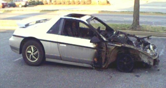

turn off the heater and read this thread!
Potential Fire Risk - Check out your blower motor resistor ASAP
