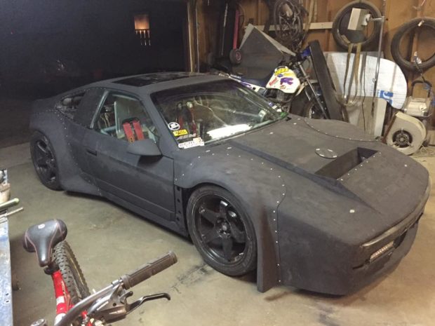

Hello!
I’m here trying to gather detailed information on a few engine swap ideas for my 1988 Pontiac fiero formula, with the Getrag 5 speed.
The purpose for my car is to teach kids about automobiles, foster a love for Fieros, and to start racing this fiero at the track.
Creature comforts are not mandatory for this swap, but my automotive experience in swapping engines is quite limited.
My first and #1 favorite idea for a swap is a Alfa Romeo 3.0 24v 60 degree busso v6. I want this engine for a multitude of reasons, but one is the sound and to build a naturally aspirated screamer. I’ve heard many many many good things about this engine, and from what I’ve gathered it would not be the hardest thing to swap due to the engines simplicity.
Not gonna lie a fiero is like an honorary Italian sports car, so I think this Italian girl would be a good fit.
What I want to know is how feasible is this swap and how would I go about doing it?
Swap idea #2 is a v6 DOHC from a Cadillac Catera. This interests me for the same reasons that the Alfa Romeo engine does except from looking at it it should be an easier swap. I don’t know much about this engine but from members of its forum, it sounds pretty competent.
My last option (witch many people have done) is a built HO quad 4 engine. This one is from what I can tell not hard and would be the easiest out of all of them.
I know everyone worships the 3800 series and what not, but I don’t particularly care for these engines for a great multitude of reasons.
Please keep comments away from trying to tell me that I should swap a 3800 or anything of that nature because I simply don’t want that. I need a light engine with capabilities for lots of power and a high redline.
As I previously stated, the car is for the track, and needs to be as light as possible, while still being somewhat affordable.
