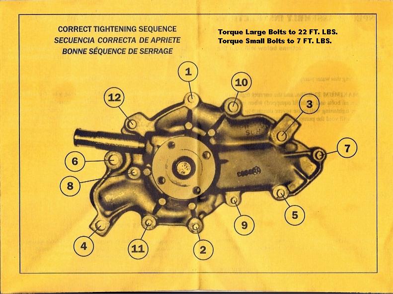

Be really careful with the small bolts (11, 2, 9) they will strip out very easily. To make it worse they are very hard to see or touch in the car. Don't ask how I know.
