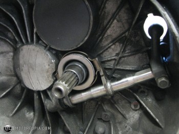

Just took the transmission out of the 88 Formula after clutch failure, I need a release bearing fork, release bearing, clutch disc, and pressure plate.
This is being done at my mechanic's shop and I have not visually seen any of these parts in person.
The Getrag is definitely from a FWD, but how many release bearing forks are there to choose from? I do not know the exact year or model car the donor was.
I have done some research to show that the 88 clutch kit is applicable to the Beretta Getrag, so I was hoping a LUK clutch or similar brand would be okay to buy application-specific to the fiero. The fork and bearing are where I am unsure.

Look here to identify your trans. as a non-Fiero FWD Getrag.
https://www.fiero.nl/forum/Forum9/HTML/000038.html
I expect it has the clutch fork with the arm inside the bell housing?
In that case, you can check RockAuto for 1992 Beretta 3.1L V6 for clutch kits and seals.
