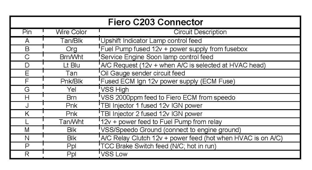

What specifically is the "203" you refer to? Connector? Pin? Thanks

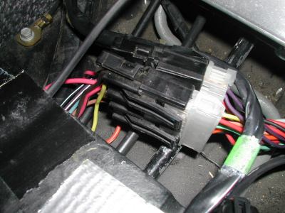

Report this Post02-08-2018 03:08 PM Click Here to See the Profile for fieroguruSend a Private Message to fieroguruEdit/Delete MessageReply w/QuoteDirect Link to This Post
Remove the center console to expose the ECM. At the base of the ecm is a 2 plug connector called the 203C. The yellow wire you want to splice into is pin G.

Thanks for your help with the C203 pinouts and the SGI-5_c. Got it working today!
