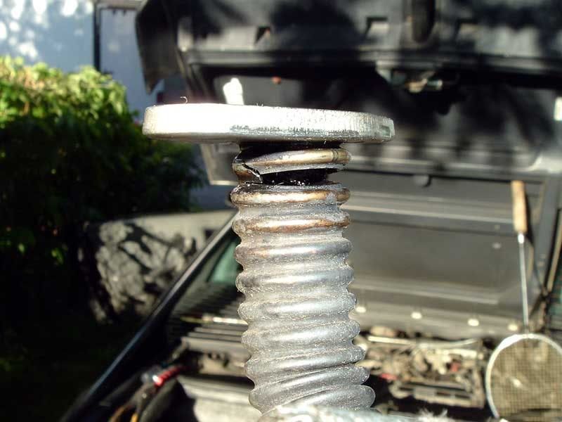

well tested one theory out having a clogged exhaust. not that. legally it hasnt been driven. still gotta test the tps sensor. now bout the cold start injector? if that dont work would that cause my conditions?

If the problem with your very high idle is a stuck open IAC valve, putting your finger over the IAC air inlet will bring the idle down below a normal idle or it might even stall. If it doesn't you could still be looking at a dislodged o-ring where the IAC feed tube inserts into the throttle body or one of the other two suggestions I had listed earlier.
The o-ring can get dislodged if the throttle body is removed from the intake manifold and when it is reattached when the feed tube is inserted it pushes the o-ring out of its internal groove in the TB.
I have only seen this happen when someone removes the throttle body.
95% of the time it is a broken intake to EGR tube.

Put my finger over the iac hole and it didn't change anything. So guessing my problem is somewhere else. Happy 4th by the way

My 87 don't seem to have that iac tube. Pretty sure my egr tube is fine. I'll take it off later and double check

It is a whole lot easier to use the aluminum strip to block it off than it is to take it off. If the strip cuts the idle down, then you can take it off and look at it. If the strip does nothing then look elsewhere.

Originally posted by 87fiero2017:
My 87 don't seem to have that iac tube....
Now that would certainly explain a massive vacuum leak... and high idle!

I don't think you can get the IAC tube out without taking off the throttle body. That said a while back you said injector o-rings. If they were not in place that could do it but I wouldn't think they would be missing but he did just replace the injectors.
