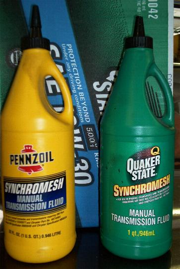

I've heard so many times that the GM Synchromesh fluid is actually produced by Pennzoil. Someone once said that it was also by John Deere. The Pennzoil is so much cheaper from the discount parts stores than the GM fluid at a dealer.
The Pennzoil Synchromesh Manual Transmission Fluid is distributed by Sopus Products out of Texas. It states that it's for transmissions requiring GM Part No. 12345349 or 12345577, Specification 9985648 and Chrysler Part No. 4874464, Specification MS9244.
If someone has a bottle of GM fluid, how do those numbers compare?

All done, FWIW. The hex nut was definitely the way to go versus the VSS. Put a plastic tube on my funnel, fished it down, and poured in the Syncromesh until it started to trickle out. Took about 2.8 qts, which is what the manual says was the capacity.
I didn't notice much shifting effort change, but didn't expect to. Perhaps the oil was still "new" after 10k miles and hadn't broken down, or perhaps the original owner had already made this switch recently. For me though, it was cheap peace of mind to change out in case the fluid was 31 years old. I'm in the process of changing out every fluid and filter for my own peace . . .
And I did use the Pennzoil. I don't know if it is EXACTLY like the GM equivalent, but don't really think there is enough difference between the two to be anything but placebo. I don't use OEM oil in the crankcase either
