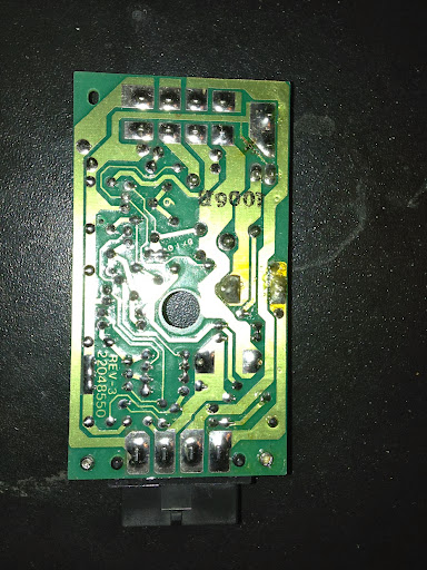

Can you post a picture of your burned up board?
JT.86FieroGT
Posts: 44
From: oklahoma city
Registered: Jul 2013
Report this Post09-25-2013 08:44 PM Click Here to See the Profile for JT.86FieroGTSend a Private Message to JT.86FieroGTEdit/Delete MessageReply w/QuoteDirect Link to This Post
sorry for the wait
A few days ago i tested a new board exactly like the one that was burnt up when I first replaced the board. I put in the 20 amp fuse and turned the key enough for the battery to come on. Then I put the wipers on high for about 5-10 seconds and then turned everything off. I felt the board and it was extremely hot but not burnt up yet. After that I just turned the key but kept the wipers off. I could see smoke coming up off of the board. After that I took out the fuse and the board and took it back and got my money back.
The board in the picture is the board that was in the car when I bought it. It was already burn't up when i got the car. I don't know if the board is the original board that came with the car.

I was hoping to see something more obvious.....you may want to check the motor for an internal short.
