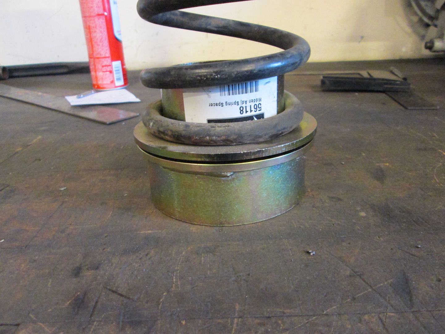

Inspired by Mcguiver3's setup above, I've been researching this a little more, and I think I've come up with a combination of components that would make this possible with only having to modify the lower control arm. That way you could switch back a set of stock lower arms if you ever wanted to, and run a stock setup again.
My idea is this:
Start with a set of these
http://www.jegs.com/i/Ridet...entProductId=1391960
Disassemble them, and just use the body/lower eye mount. You won't need the shaft, or top mount.
Then weld these to the lower control arm (after removing the stock spring pocket and reinforcing with a flat plate)
http://www.jegs.com/i/AFCO/921/20137/10002/-1
Then use these springs.
http://www.jegs.com/i/QA1/122/10GSF350/10002/-1
Using tapered springs would avoid needing to modify the top spring mount on the fiero crossmember.
I'm not sure on the spring length, I haven't done any calculations, but you get the idea.
Your thoughts?
fieroguru
Posts: 12639
From: Champaign, IL
Feedback score:    (45)
Total ratings: 258
Report this Post01-26-2014 09:03 AM Click Here to See the Profile for fieroguruSend a Private Message to fieroguruEdit/Delete MessageReply w/QuoteDirect Link to This Post

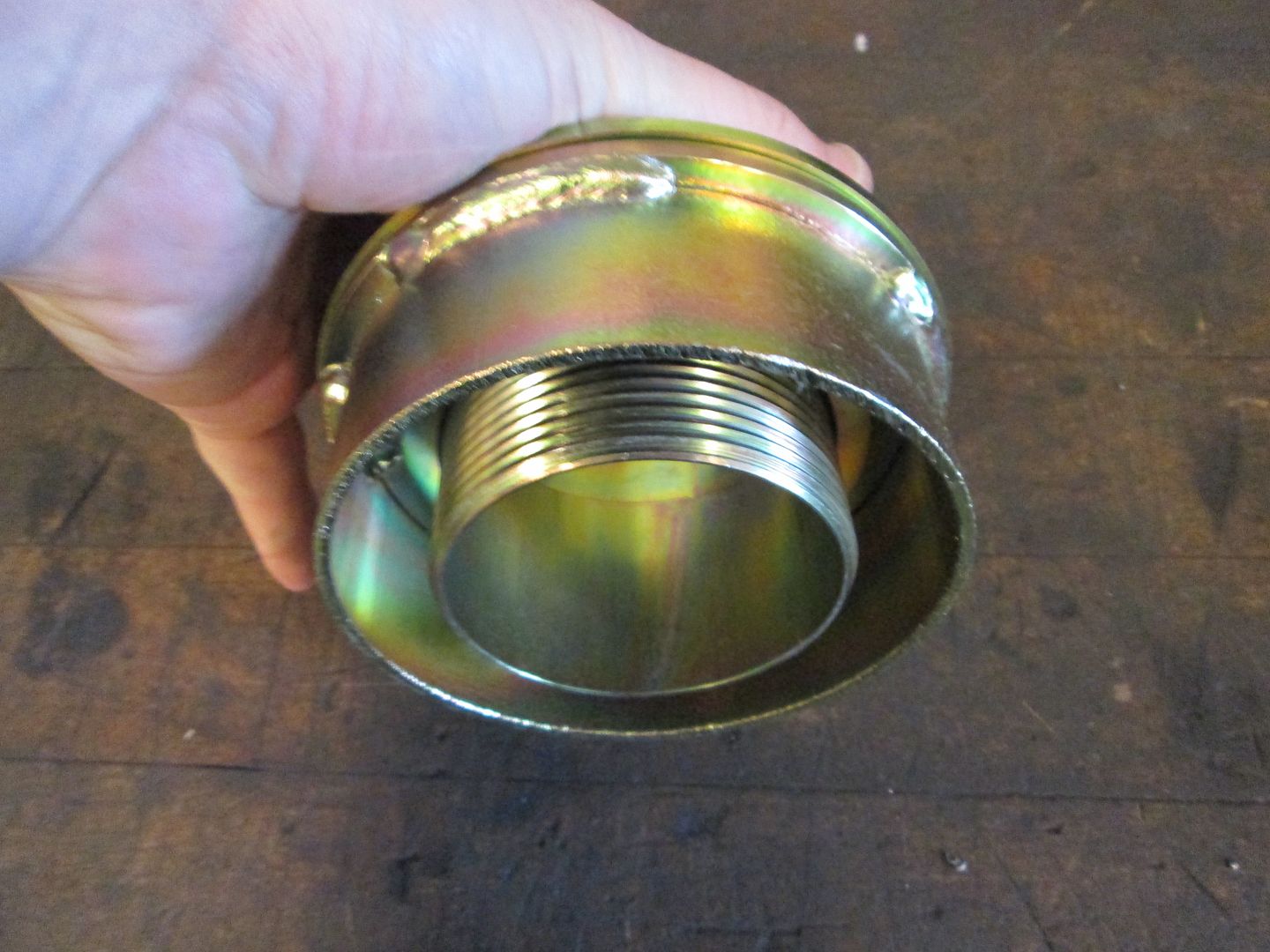

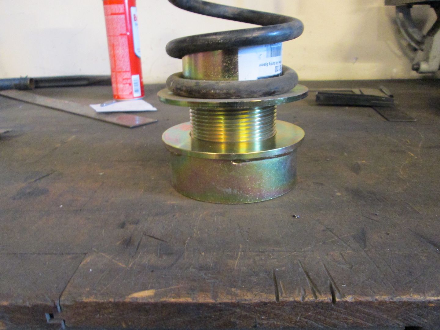

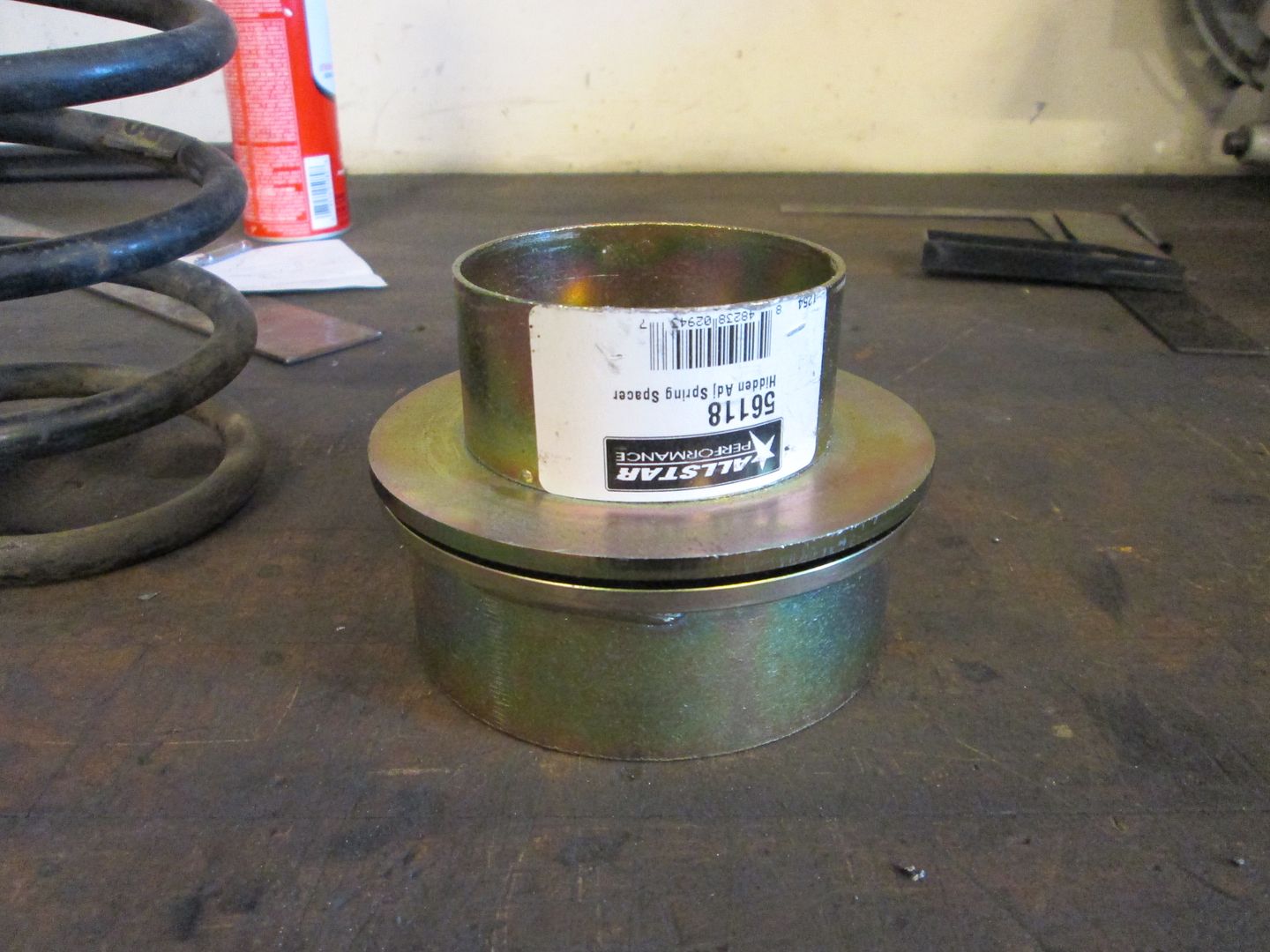

You can use two Allstar 56118 adjusters ($40 each) welded to the lower control arm. They will require a shorter spring, but then you have a simple means of adjusting them. You might want to notch the outer ring for a spanner wrench or drill the threaded tube right at the spring support so you can use a screw driver to turn them for adjustment.
However you do this, you likely need to trim down the factory bump stop sleeve to make room.

Report this Post03-18-2014 07:36 PM Click Here to See the Profile for BridgetownSend a Private Message to BridgetownEdit/Delete MessageReply w/QuoteDirect Link to This Post
Was looking at these, thinking they might work mounted in place of the stock bumpstop on the crossmember.
http://jksmfg.com/i-8938568...ble-coil-spacer.html
