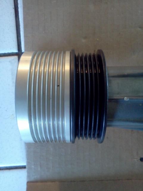

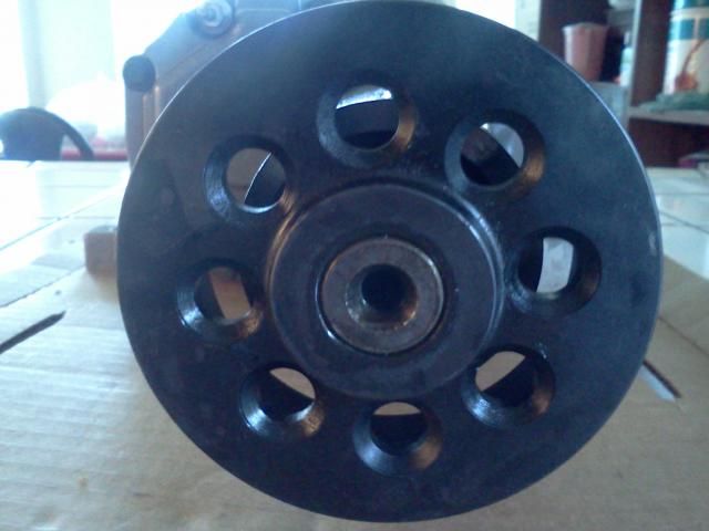

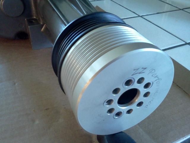

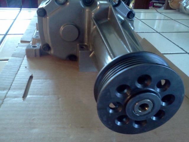

Just got this M90 off the 3800pro forums & it came with this pulley, press on, no markings that I can see, & it looks smaller than my ZZP 3.4 I was planning on using...

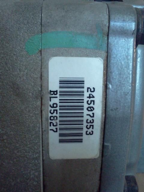

& any way to decode this sticker?

Why don't you just measure the pulley? That will be the only sure way of knowing.

The sticker on the blower is just a serial number used at eaton to ID the part.

depending on your modifications is might not matter, what size ZZP pulley did you get? (i'll assume 3.4") the press on pulley is clearly a size or two smaller.

Thanks, I have the Harbor Freight one, but it's not deep enough to get to the widest part of the pulley, it's either 3.2 or 3.25... I was also hoping someone knew who sold this one, just to know, never seen this style before.
I only have headers (SSAC/XSPower), 4" intake, & a mail order Darth PCM tune for the 3.4... (also have PRJ fuel rails & aftermarket FPR, don't think that makes a difference though).
I'd like to just leave the 3.2 / 3.25 pulley on there but I don't think my mods will support it, I considered getting the SC ported before I put it on, but I still don't think that's enough.

I know every 3800 is different, but I think the pulley limitations for the 3800SC are based of the FWD cars which don't have the best intake setups but most importantly have restrictive exhausts. it seems like every 3800 Fiero is good with a 3.4" pulley while some GTP's have KR with just a 3.4. I have been told by many I could probably try a 3.3
I think if you have a free flowing intake, free flowing exhaust, colder plugs and are scanning for KR since your running headers you might be alright with a 3.2 you may just need to be aware what gas stations have better gas than others. a ported blower will also in theory lower intake temps and reduce chances of KR
as long as your scanning for KR as long as you work your way up to WOT and then longer and longer periods of WOT your going to be good.

I have an Aeroforce scangauge, running Autolite 104's, but I have a 4T65eHD & premium here is 91... I think I would need at least rockers.
