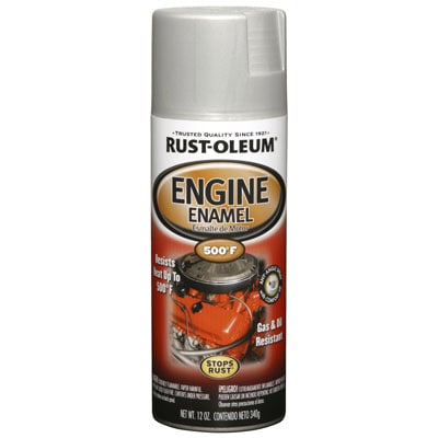

Love the blower - is that media blasted or painted? If it's painted, what did you use?
Looking forward to watching your progress - hope not to be too far behind you...
Thanks, I like the way it turned out too.
http://contentinfo.autozone.../rso/248953/image/4/
RustOleum Cast Coat Aluminum

i used dupli-color aluminum engine enamel from 0rielly's. its the same thing.
