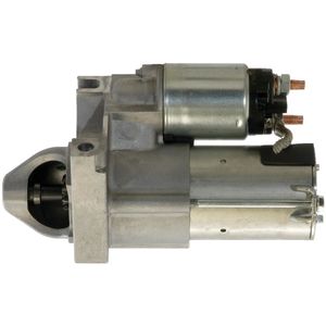

Here is a complete comparison between a 2005 3.5L Starter from an Impala to my stock 1987 2.8L starter from my Fiero GT
This is the biggest difference between the two starters. The power connections. You will need to use the Stock plug and wires from the 3.2L Starter and splice it into the 2.8L Starter lines.
Stock 2.8L Starter has mounting holes at 3 1/4" on center
3.5L Starter has the mounting holes at 3 1/4" on center
2.8L Starter long bolt carrier length is 3 1/4"
3.5L Starter long bolt carrier length is 3 1/4"
2.8L Starter Snout depth is 2 1/8"
3.5L Starter Snout depth is 1 5/8"
2.8L Starter Snout width is 2 3/4"
3.5L Starter Snout width is 2 3/8"
Now here is the biggest question most may want to know the Weight difference.
2.8L Starter Weight is 13.8 lbs.
3.5L Starter Weight is 6.4 lbs
Thats a weight savings of 7.4 lbs.
I will go back to my shop tomorrow and grab the plug so I can install it into my GT. I will post pics of my process after.

Looks to me that the 3800 starter and the 3.5 starter are the same monsters.
That looks like a nuisance. The two 3800 starters I picked up did not have a weird wiring terminal like that 3.5 starter.

I used a starter from a 2002 3400, it has the same weight and dimensions, but with normal electrical connections.

I agree it will could be a PITA for someone. So what we now know is that the starter is physically the same for the 05 Impala but the connection is different. I would suggest then to people to go with the 3400 or 3800 starters unless a confirmed 3500 starter from a specific line of GM cars can be confirmed.

I got a 1.7 kW from a 2006 Grand Prix 3800 S/C
No wiring plug needed. Just wires up as stock.
You have to go by vehicle AND engine.
For the most part, the newer cars up to 2007 with 3800 S/C have the 1.7 kW.
You have to remember the starter is also turning the Supercharger.
AC Delco 336-1915A Rating 1.7 kW
(I counted 9 teeth on the starter gear)
Vehicle list if your shopping at Pick n Pull like me
http://parts-catalog.acdelc...g=5561&parttype=3252
Here's a pic of the 3 different GM starters for comparison - Left to Right.
Stock, a 1.5 kW (11 teeth on pinion gear) and 1.7 kW (9 teeth on pinion gear) I just got which is the smallest.
[This message has been edited by fierosound (edited 05-26-2016).]

AutoZone shows this 1.5 kW starter with 11 teeth for the NA 3800 2006 Grand Prix
http://www.autozone.com/bat...521_0/?checkfit=true
They also show the smaller style as also being 1.5 kW with 11 teeth for the NA 3800 2006 Grand Prix
http://www.autozone.com/bat...v/108726_23521_7833/
The small one of the 3 pictured below, has 9 teeth on the gear and according to AC Delco is the 1.7 kW for the 3800 S/C 2006 Grand Prix
The middle slightly larger one I got a couple of years ago, has 11 teeth and came from a NA 3800 I believe...
[This message has been edited by fierosound (edited 05-28-2016).]

Tony, I suppose there could be a variation in size depending on the actual manufacturer. (I can't check them at this point, but I suspect the two starters I pulled at the wreckers a few years ago were both original ACDelco units.)
I just wanted to make sure it wasn't simply a typo that resulted in it being stated that the 1.7kw starter was smaller than the 1.5kw starter.

Originally posted by Patrick:
...but I suspect the two starters I pulled at the wreckers a few years ago were both original ACDelco units.
I just wanted to make sure it wasn't simply a typo that was responsible for it being stated that the 1.7kw starter was smaller than the 1.5kw starter.
I think the smallest units are the "latest design". They have the external case bolts.
The key to getting a 1.7 kW units seems to be getting it from a 3800 S/C engine.
RockAuto shows AC Delco 336-1915A Rating 1.7 kW as the starter for the 2006 Grand Prix 3800 S/C
Whether the smallest units are actually newer or stronger or prettier or whatever , the good news is that any of these 1.5kw/1.7kw starters are superior to what originally came on our Fieros. It's a good low cost upgrade, especially when found at the boneyard.

Thought I'd just bump this. I did a little bit of research and discovered that for all of the standard replacement starters for our Fiero, they were all 1 KW Rating... and as discussed above, are also 9 teeth, and weigh in at a portly 14.16 pounds.
I ended up going with this one: https://www.rockauto.com/en...einfo.php?pk=3467982
(Note, it's for a 2004 Pontiac Grand Am GT w/ 3400 V6/60)
It's also 1KW rating, 9 teeth, and weighs in at 6.55 pounds. It's brand new, not rebuilt. I was considering getting a rebuilt distributor, but with the core charge, there's only a 7 dollar difference, so it only made sense.
Yikes! That's spendy!
I bought this one for my Duke. Designed for a 3800. Made of pure Chinesium, I'm sure.
