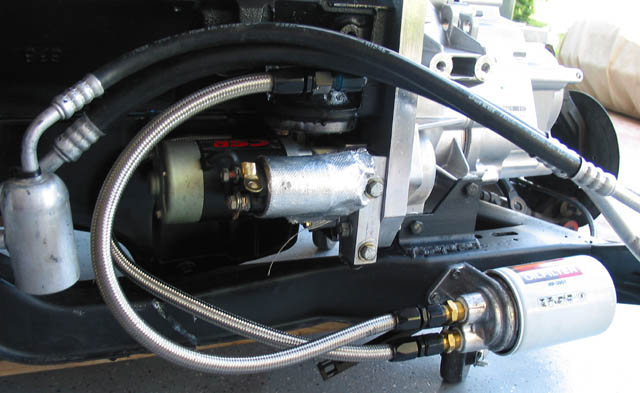

Report this Post09-12-2011 08:43 PM Click Here to See the Profile for EgorSend a Private Message to EgorEdit/Delete MessageReply w/QuoteDirect Link to This Post
I'm not familiar with that last one, but I can definitely say (from experience) that being able to rotate it 360* is a major plus!
I probably spent more time on getting that right with the oil filter remote adapter than any other one thing on my swap.

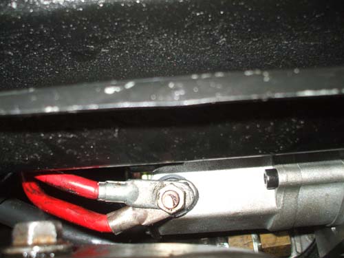

I installed this starter a few minutes ago.
First thought is it fits as well as the Powermaster 9004 if not better but there are some issues. The starter sometimes spins up faster than it can engage the flywheel.
The mounting block had to be cut down and the holes had to be drilled out. But the starter I took off had similar issues so it could be the block supplied with the kit.
The starter spins the motor over just fine and faster than the old starter.
The oil relocation kit has much more space than the old one
The clearence is better as well but the power stud is in a bad spot.

I love the way this starter fits the car. But the quality of the Procomp starter is not very good and you can see the difference compared to the first one I posted a picture of. The starter spins really fast but it starts spinning before it engages the flywheel.
I hoped that it was just because its new but it continues to be an issue.
The fit is so much better than the other starter, I may just spend the money and get a good quality starter. This one is mine, I modified it and voided the warranty but it was worth it to find out these starters fit.

I'm trying to get more rotation out of the starter to give more room for the oil lines. If the CSI would rotate that much I would candider it.

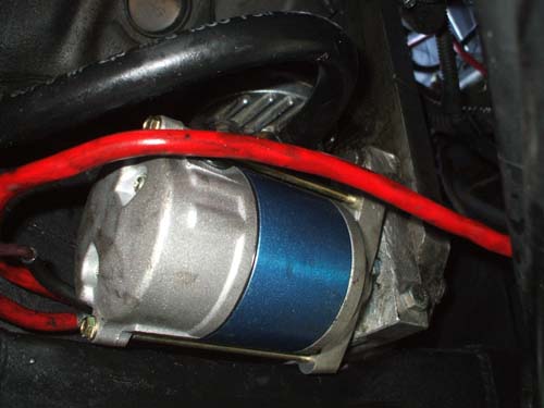

Report this Post10-30-2011 02:30 PM Click Here to See the Profile for Jake_DragonSend a Private Message to Jake_DragonEdit/Delete MessageReply w/QuoteDirect Link to This Post
http://www.summitracing.com/parts/CVS-5323/
The starter is installed and its night and day from the Procomp starter.
But what a pain in the ass to get shimmed, the mounting plate isn't centered in the same place as the last two and I had to shim it where the last two didn't require any shims.
But its in and I have accomplished my goal of this thread and perhaps given us another option when having to replace our starters.
The CVS starter is not only heaver its a little bigger but it fit and I will be able to use both ports of my oil adapter and not tap the block. I plan on using the port in the block for a oil pressure safety switch.
I will keep everyone updated.

Report this Post04-07-2012 11:00 AM Click Here to See the Profile for Jake_DragonSend a Private Message to Jake_DragonEdit/Delete MessageReply w/QuoteDirect Link to This Post
Just a follow up on the starter. As you know the way the Archie mounting block is use it needs the two inside holes on the starter block, well always measure twice and cut once. LOL
I cut both sides of the block down, it wont effect anything but it did make the mounting block smaller. Hey I saved weight, its all about saving weight. Ok I got in a hurry and marked the wrong side, but it turned out ok.
Anyway I did try to swap the block I already cut down and the blocks were close but not exactly the same so I ended up cutting my new starter block instead of using the one already cut down.

Multiple starter and water pump issues prompted me to get rid of the SBC and go with the DOHC.
That and the fact I got a BRAND NEW crate DOHC for $300!
Posts: 33125
Total ratings: 399
Report this Post11-12-2013 03:31 PM Click Here to See the Profile for Jake_DragonSend a Private Message to Jake_DragonEdit/Delete MessageReply w/QuoteDirect Link to This Post
I never had a problem with an OEM replacement starter on mine. Worked fine with the 350 and 383 stroker. Ive never put much reliability in aftermarket performance stuff.
What kind of transmission were you running? I don't know that there are any OEM starters that work with the standard transmissions and Archie V8 kits.
The starter has good reviews its just not setup to run upside down. I will plug the weep hole and drill a new one and it should be fine.
The same thing with the water pump.
Honestly I caused this by leaving the car out in the weather and being to aggressive with engine degreasers and the power washer.
I have taken steps to correct this and will invest in a cover if I have to leave the car out in the weather.

I've used a Tilton starter with my V-8 Archie kit. It's been in there since 1994 and is now on it's second engine,

On my archie auto kit ( with a 440T4, 4T60, and a 4T60-E) I used a tildon starter first. it lasted for years. Rusted when it was off the car. I have always got the same type of starter, just non a tildon, and used them with the modifided tildon block. Non of them were ever as good as the tildon.
