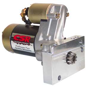

My first cheap Powermaster lasted one week. Then I got this CSR. Five years and 20K miles wiht it. Expensive but I think worth every penny.
http://www.jegs.com/i/CSR/170/100P/10002/-1

Will that work with a 70s block? Another $100 would be ok if I knew it would last.
I think my starter would still be ok if it wasn't for the oil soaking it got from the oil filter adapter.
Don't know. Mine is an 88+ block
Posts: 33127
Total ratings: 400
Report this Post03-17-2010 07:29 PM Click Here to See the Profile for Jake_DragonSend a Private Message to Jake_DragonDirect Link to This Post
It probably will, the only worry would be if the oil adapter is lower. Haven't pulled the old one off yet will probably do that this weekend.
