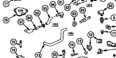

OK, I've found lots of archived threads about the PCV elbow for the 1984 Duke saying the part is no longer available. So what are people doing when they need to replace the elbow? There has to be an alternative solution, right?
If you don't know the part I'm talking about, here's a good thread with pics:
https://www.fiero.nl/forum/A...120111-2-111500.html
I'm looking for part #85 in this diagram. I can get the PCV valve and grommet locally. (Is #9 the grommet? Because it looks a lot different/bigger in this pic than I would expect.)
The thread above states that the 84-86 Duke used the same configuration. If that's the case, will this elbow (for an '85) work?
http://www.dormanproducts.com/p-9893-47037.aspx
If I go with this part, do I then need a different grommet and PCV valve?

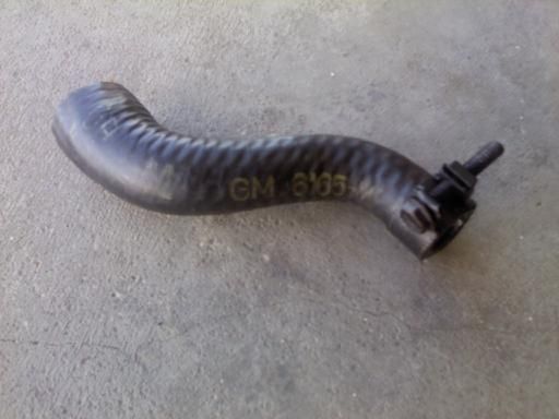

My 86 Duke has this hose about 1/2" on one end and 3/4" on the other with a molded bend. Its getting dry cracked on the end. I may have to try RWDPLZ fix too.
