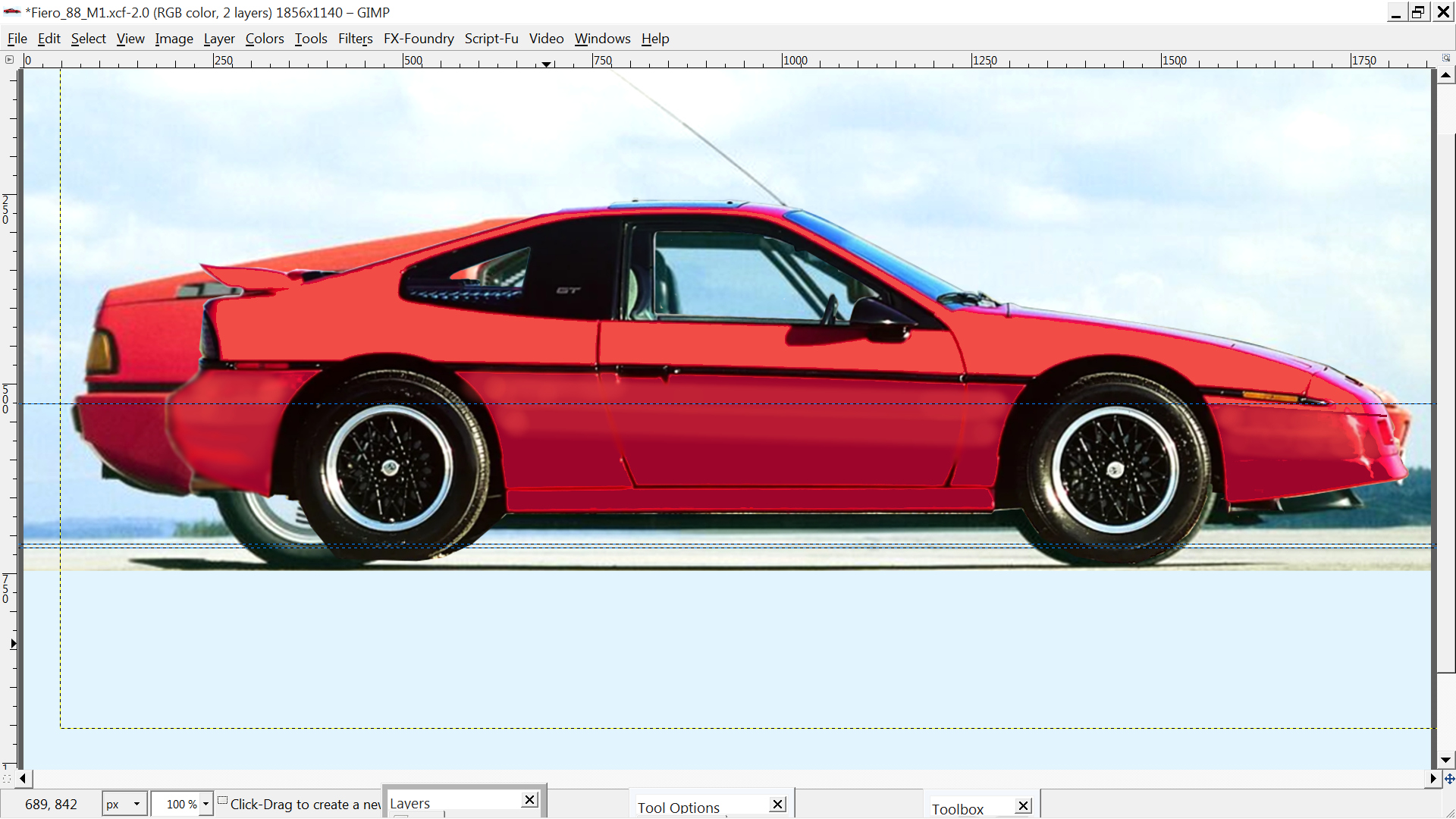

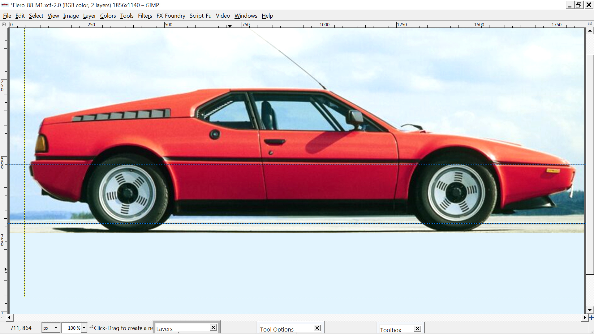

Made in Germany,
a polyester fiberglass body kit on a factory wheelbase Matra Murena,
BMW M1.............2560mm, 100.79"
Matra Murena.....2435mm, 95.9"
Pontiac Fiero......2373mm, 93.43"

PontiacFieroGTO-16-jpg, remodelled Saier-S1 bodykit panels on a Fiero chassis.
Not the average build, something more '70s, a sharper suit, the original cut.

Bloozeberry's vital blueprints, stretched further.
2560 - 2373 = 227mm, matching the wheelbase of the original, genuine BMW M1.
Positioning the Atlas 4.2L longitudinally, 147mm from the axle CL.
Fiero Atlas Fitting
Encroaching into the firewall, a few cm, makes for jackshaft accessory drives.
Dallara designed the race chassis with a cab forward concept, Pontiac compromised for the runabout production model, the transverse engines more compact.
The front axles aligned, Fiero in blue.
The Atlas will fit with extensive remodeling, like, shortening the front frame rails a few cm, moving the foot-wells forward a few more, the rear firewall of the Fiero is farther to the rear by ~180 mm.
Modified to make M1, err, Saier S1.
Redesign a Fiero suspension for better..., uh, everythings.
Cutting and Hacking., the tutorial.
A great deal of work is involved to build a Saier S1 tribute to a high standard, at less than 7% the cost of the real deal.
