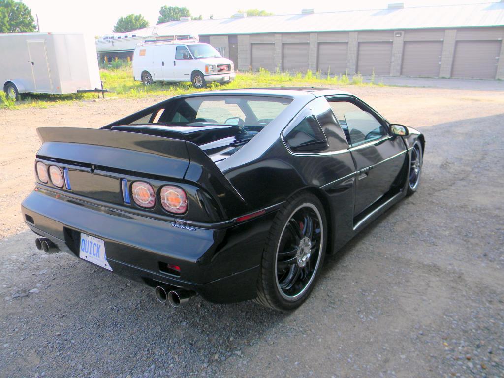

There was a version with revesre lights for the C4 corvette lights, I have one I planned on using in my car one day. I bought a set of Keiths lights and the paint inside is coming off now. May go back to my original idea with the C4 lights now.
