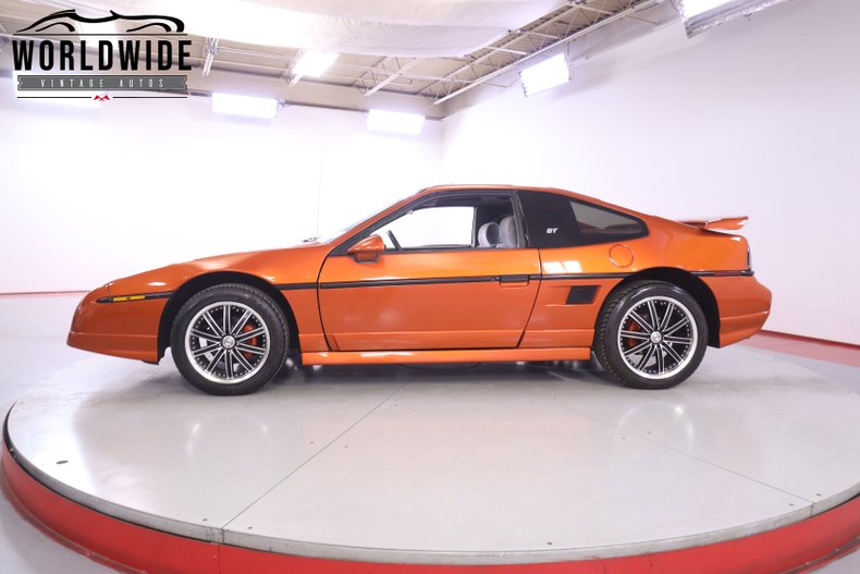

Congrats on the pickup. "Sunburst orange" was not a factory color, though it looks like whoever sprayed it did a good job.

wow ok... yeah i would have put money on it being oem... of course the dealer said "rare color"
check out the sales link... unless somebody did the mother of all resprays... this looks dead on factory.. no overspray or anything.
https://www.worldwidevintag...9/1987-pontiac-fiero

It's "rare" alright... one of a kind! Looks good.
All of the panels on the Fiero are removable. The only part of the Fiero that puts up a fight when trying to be removed is the roof panel due to the adhesive. Your car was probably a panel-off paint job so that's why there's no overspray. Looks gorgeous.

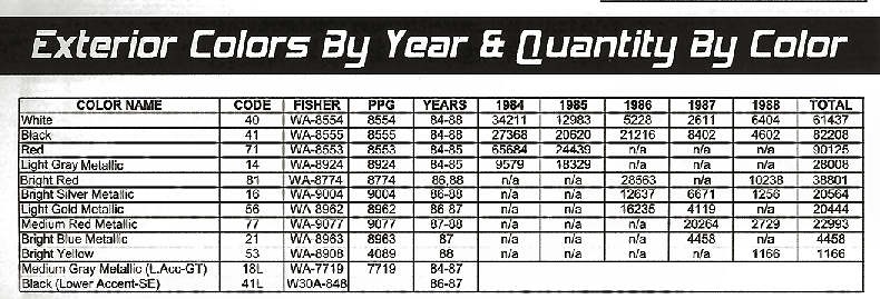

i will have to look up the paint codes at some point and see what she was born as
The check out your 'Regular Production Option' label on the front wheel well at the bottom of the sticker as WA-????

Yeah... no Fiero - of any year - ever left the factory with orange paint. So you have a one-of-one. Beautiful, by the way.

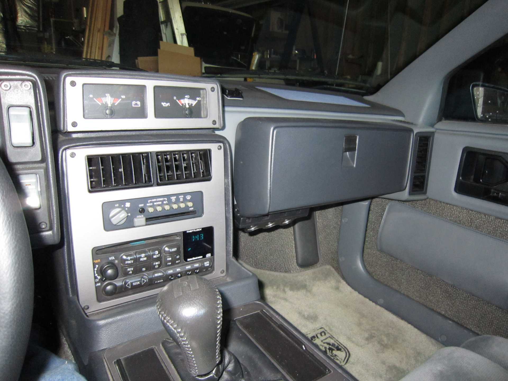

Early 90s Delco CD players can be adapted fairly easily.
There is one head unit that really stands out, to me. It looks like the top of the line (other than the pushbutton keypad) Fiero unit, but plays CDs instead of tapes.
What makes it special? Under the CD slot it has a "COMP" button. Which compresses the audio a bit, to make it a bit more listenable in the car. Others may differ, but that's a feature I like.
One of my Fiero friends actually thought I had a subwoofer system but, in reality, it was that headunit, Playing through Pioneer TSA-4103s in the dash.
Edit - I checked out the other thread. Patrick posted the exact headunit I was talking about.
Borrowed from his post.
CLICK FOR FULL SIZE

That's my radio!!! Hahaha...
That picture is from the eBay auction from like 16 years ago. I have that very radio in my 87 Fiero, which has been sitting in storage for literally 14 years now.
They actually sell them on eBay now where, instead of an aux jack, they even have a built in BlueTooth adaptor and you can pair your phone with the late 80s radio, it's wild.
I've got a early 2000s Delco radio from a Sonoma in my GT. It's had an iPod adapter and a Bluetooth adapter (both aftermarket) added.
I like it better than the Retrosound Newport in my coupe.

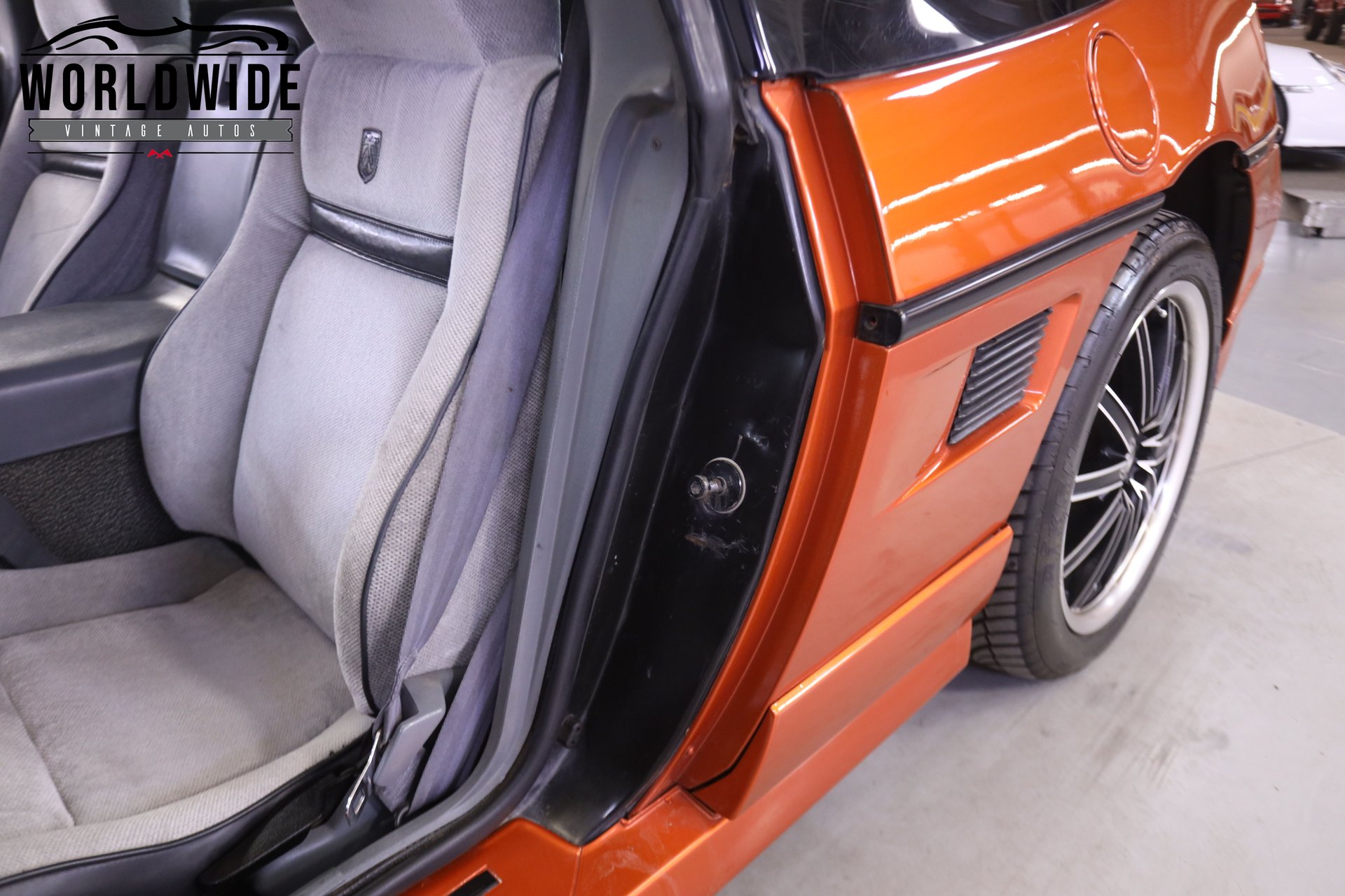

Something fishy happened in the B-pillar area of your car.
Maybe the damage was from an accident, but more likely it looks like someone tried to use a prybar to force the door open.

Looks like a really a very nice GT, thanks for sharing. Those dents on the pillar look to be very simple fixes (if you even wanted to address them) like mentioned above likely someone pried at the door. I love the color. Make sure you check out the heater core box, even the nicer Fiero's seem to have debris in there that can catch fire, mine certainly was plugged up!

Yes the color is a repaint but good compare to most I see.
The Radio I did was a late 90's Pontiac with CD. It will light up red like the rest of the dash. It looks stock and even GM offered a plug in adapter for it. Metra does too. plug and play.
You made a comment on the seat. Note these seats do not have replaceable foam like most cars. The foam is molded to the seats. You either need to glue and build up the foam on the seats you have for repair.
Or if the lower part of the seat is sagging you pull the seat install metal slats across the bottom of the seat with a piece of burlap on it and it will restore the seat bottom to where it should be. The foam is dead in all Fiero seats at this date as it gets hard and fails. Most of us will need to do this repair at some point.
As for price it is on the high side but prices are going up. Many have yet to grasp that a car needing little work is now at or over $10K anymore. Many cheaper cars will cost you more to fix up than the money you paid and it is still an old beat up car.
Not trying to scare you but it sounds like you are new to the Fiero. It also sounds like you may not know what to look for so really check out the car before investing much as too many buy a good looking car and invest a lot of money to find that they have rust or other issues too late to stop. I think you will be ok but just be safe and look first. Get under the car and really look around.
Welcome to the club. Note many parts are difficult to get today. So getting a complete car was a good idea. Body and trim parts are not an easy find in like new condition and if you do they are not cheap.
