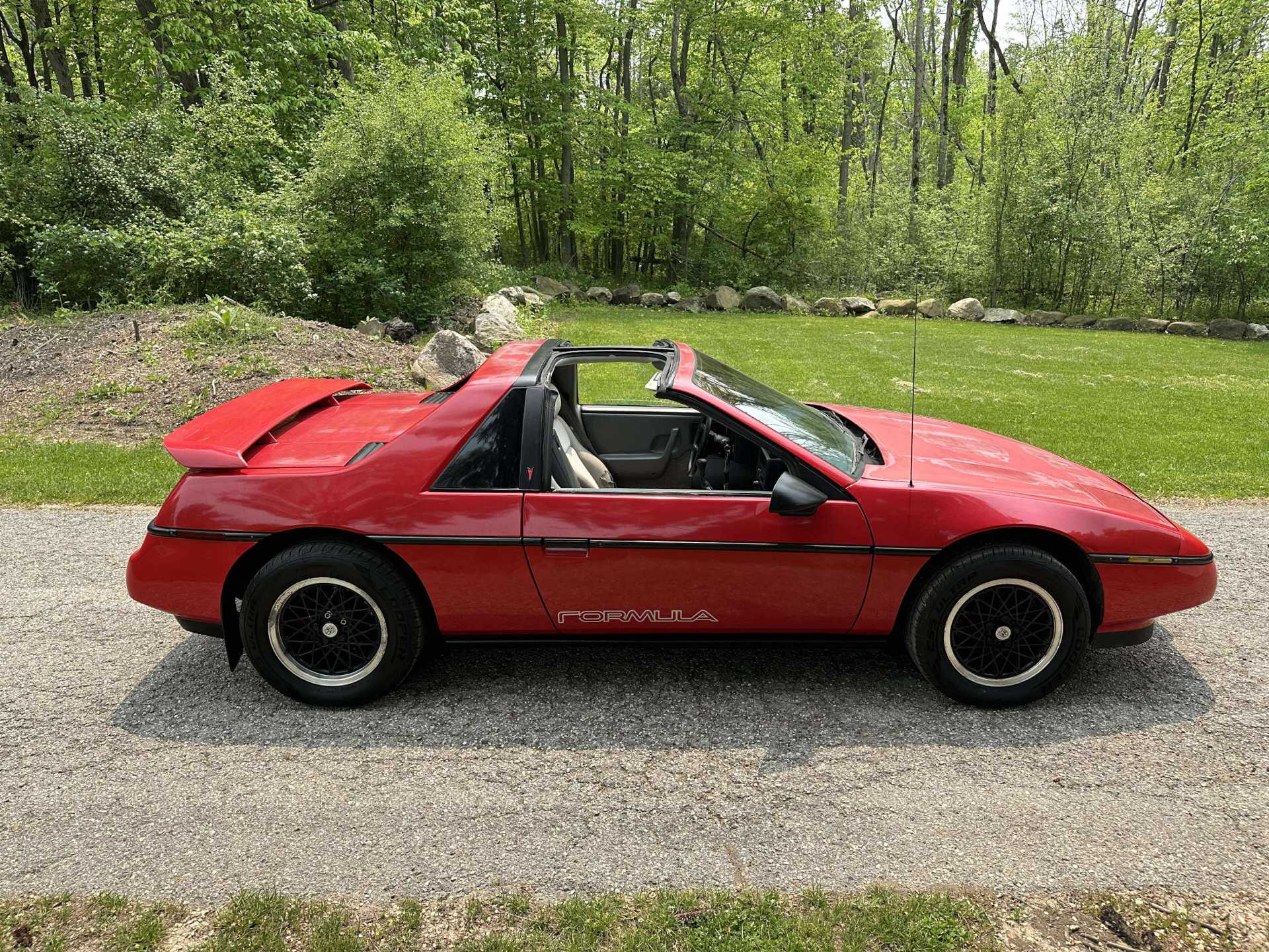

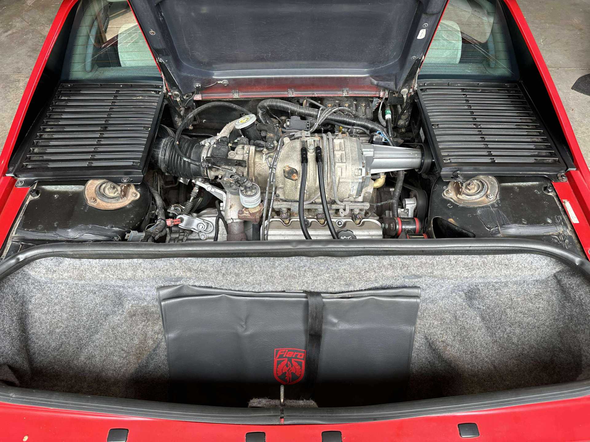

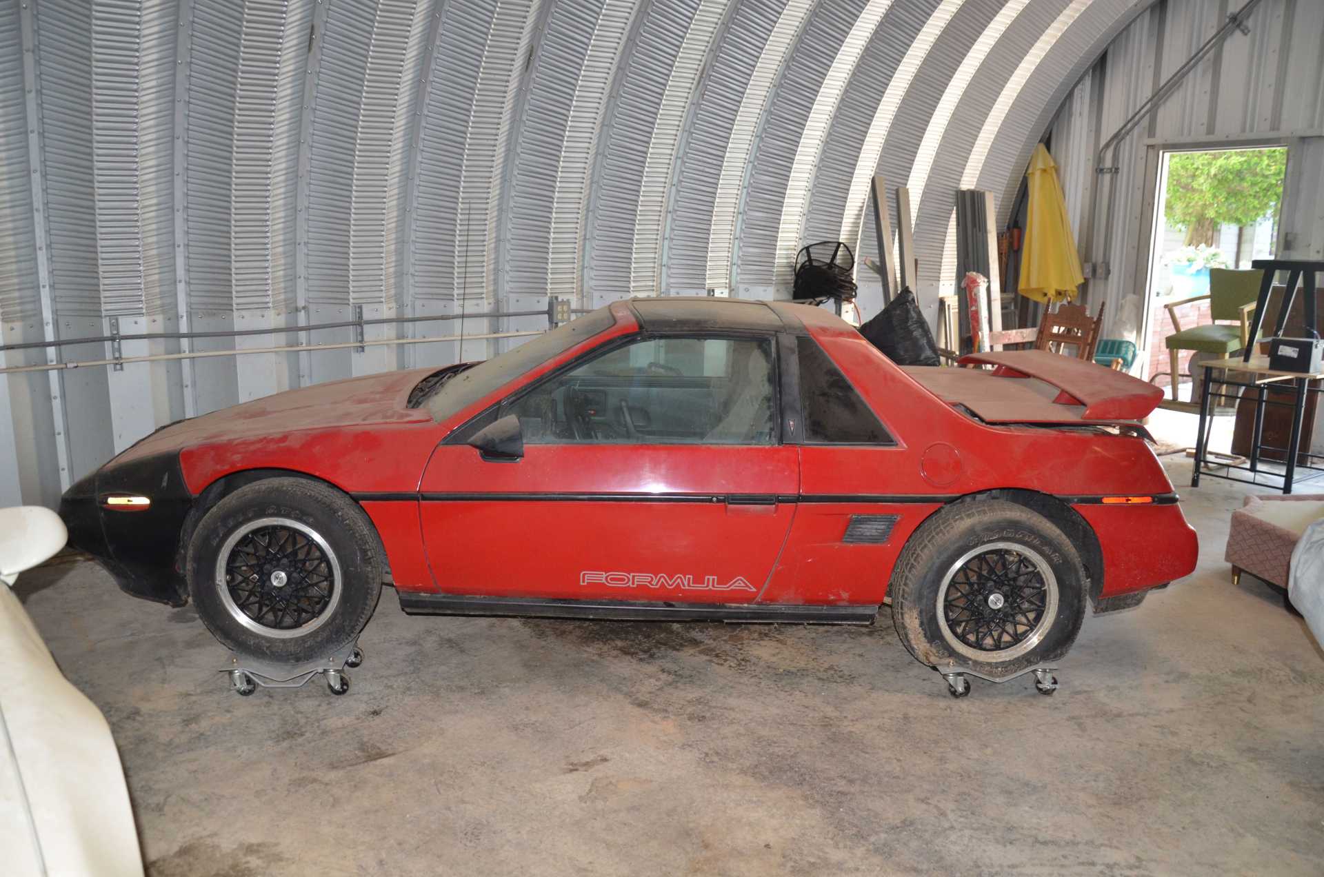

Hi there, this weekend I flew to Wisconsin to purchase my second Fiero, a red Formula! It was a long day, woke up at 2am on Friday to drive to the airport, and got back home around 2am on Saturday. It's been a long time coming for this, my neighbor picked up a manual Formula and let me drive it, needless to say I got hooked and had to get my own. I will be keeping my auto 86GT (my very first car) and adding this to the garage. It'll be fun going on a drive together in our Formulas. I wish NC had an active Fiero club. I certainly miss the NIFE club back in Illinois!
Onto the car, it's red, has an L67, Getrag, and T-Tops. It has had a lot of work done to it already, and I am going to do my best to finish up the small things and I will take very good care of the car. Right now it is waiting to be picked up and shipped to NC. I hope to have it in my garage by the end of the week so I can get started.
I wish that I made a worklog for my 86GT, unfortunately I didn't so I am starting from the beginning with this car to document everything that I do to it.

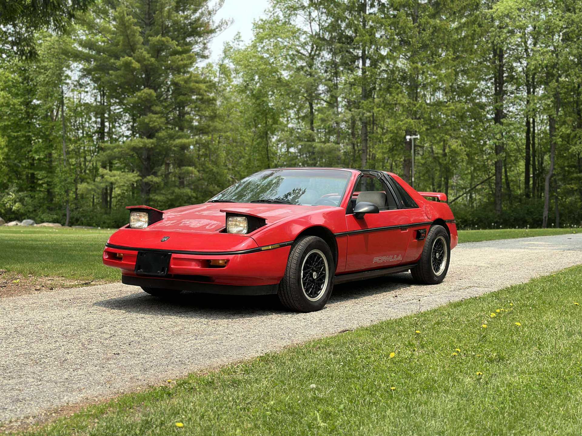

First things first, the photos!
Some photos of when the previous owner picked it up:
Here are some old photos from a car show (maybe a dedicated Fiero show?) a long time ago:
Even have a flyer from 1998 too!

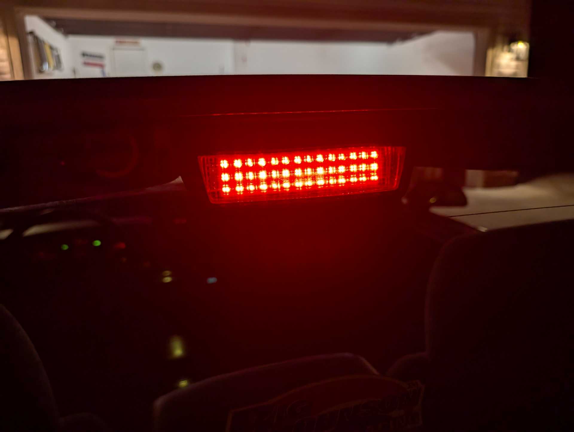

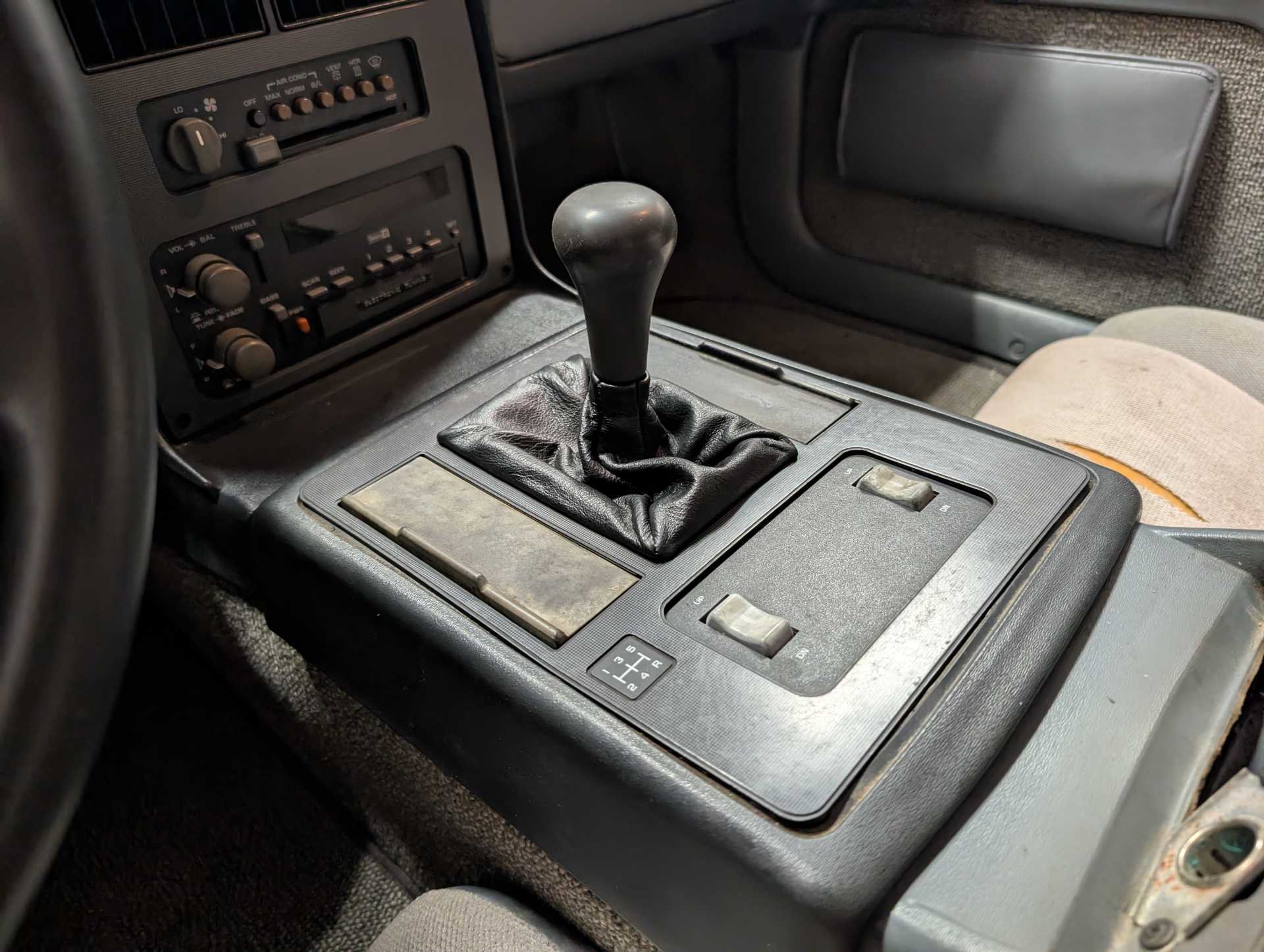

Today I just got my shifter from Rodney and got that installed. I think my clutch pedal is bent so I ordered a replacement. I like it much more than the factory shifter and the install was extremely easy.
I also followed the guide here from fierosound but I also incorporated the flashing unit from Cravenspeed located here in between the LED panel and the bulb connector, all I did was cut off the ends and solder them onto the panel and the connector.

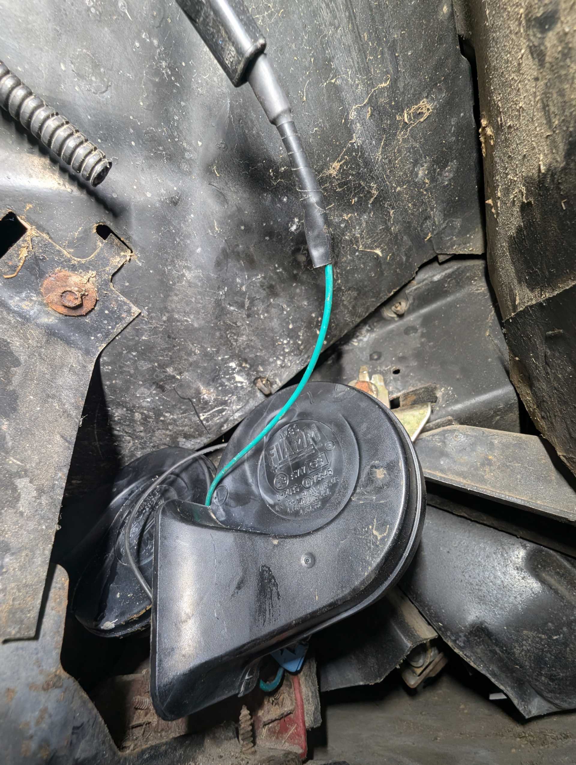

Got the horn working this morning. I picked up a Firebird horn from the yard and took the old horn out. I tested the old horn, it worked so that meant the horn wasn't the problem, and I noticed the mounting/grounding screw and hole had a lot of corrosion and I cleaned that up. I used a ring terminal on that screw for the ground as the Firebird horn has wires for power and ground, unlike the Fiero which has the ground built into the mount. I used a blue male spade connector on the positive wire and input that into the Fiero's female horn connector to maintain the stock wiring, perfect fit. I had to cut a bit of the Firebird horn's mount off to make it fit, but after hooking everything up it works again. I certainly need a horn driving a tiny car surrounded by squatted trucks. Drive defensively and always assume someone will do something stupid!

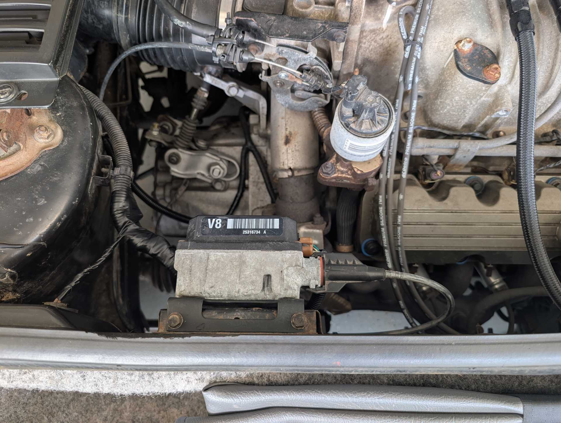

I've also completed the wiring and mounting for the digital cruise. I got everything hooked up, and it didn't work. I think that is because I'm using the "AR" module when instead I should have a "V8" module because of the cruise inhibitor signal from doing a bit more research. Nothing a trip to the junkyard can't fix. I'll probably work on that again next weekend when I can get the module.

i replaced my horns with a pair from a full sized Olds from the same era (84's are wired for two horns). They were plug and play. Sounds a lot better

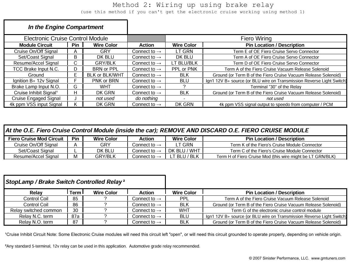

Here are the links to the how-to's that I used, I combined them together for my installation:
Click on "Articles" and then find "Installing a digital cruise in the Fiero" by Oliver Scholz
I mainly used this one for the inspiration, getting the 4000ppm signal from the speedometer to the module without running another wire, wiring in the clutch release switch, and walking me through where everything was located.

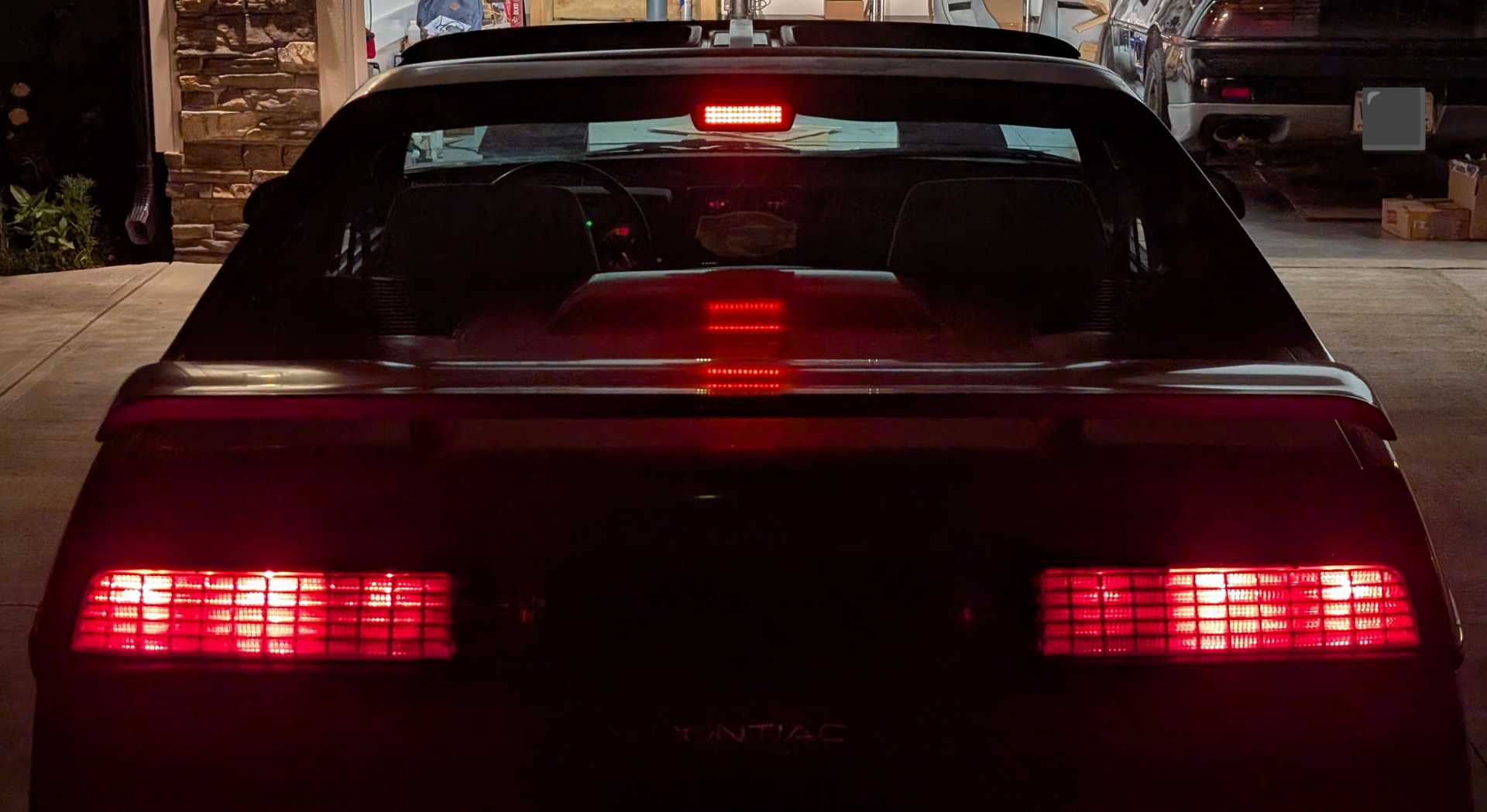

I found out that my install wouldn't work because of the Formula taillight design, so I switched gears and went this route with instructions from Darth Fiero at GM Tuners:
File Index
Originally posted by Darth Fiero here:
I have had some issues with some of the GM electromotive cruise control units (even those marked "AR") in Fiero swaps not wanting to engage at all. This is when they are NOT connected to the PCM on the cruise inhibit and status circuits.
I believe the problem is some of these cruise control modules want to see the cruise inhibit input change state at a certain speed (perhaps?) and that won't happen if you just ground that wire.
If you are using a manual transmission in your swap, the PCM may never ground the cruise inhibit wire to enable cruise operation because there is no electronic auto transmission present.
Since the discovery of this problem, I have been building my stockpile of 96-99 Cadillac Northstar cruise control modules (they look identical to the ones used on the 3800s; except the Cadillac ones are marked "V8"). Every single 96-99 Northstar cruise control module I've gotten from a Cadillac has worked fine without having the cruise inhibit and status wires hooked up to the PCM. All you'll need to do is permanently ground the cruise inhibit input to the cruise module.
Cables can be easily swapped out on these cruise modules so you can use any cable you need to match your throttle body.
-ryan

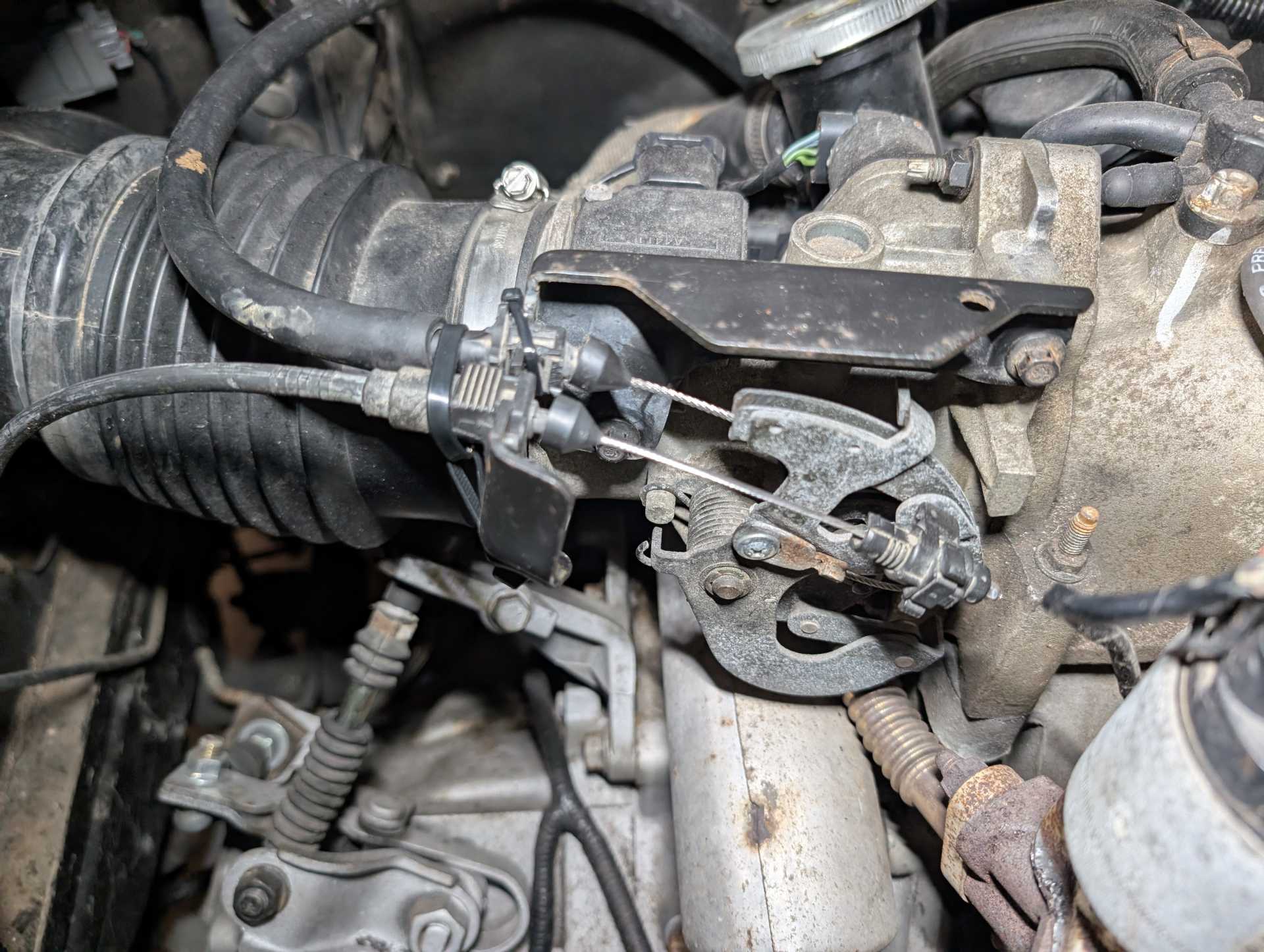

To make this work I used the following:
- V8 digital cruise module as Ryan said
- Grand Prix throttle cable and mount
- I bought my relay from Napa here
Once I had the parts, I used the instructions from both links and it was pretty easy to accomplish.

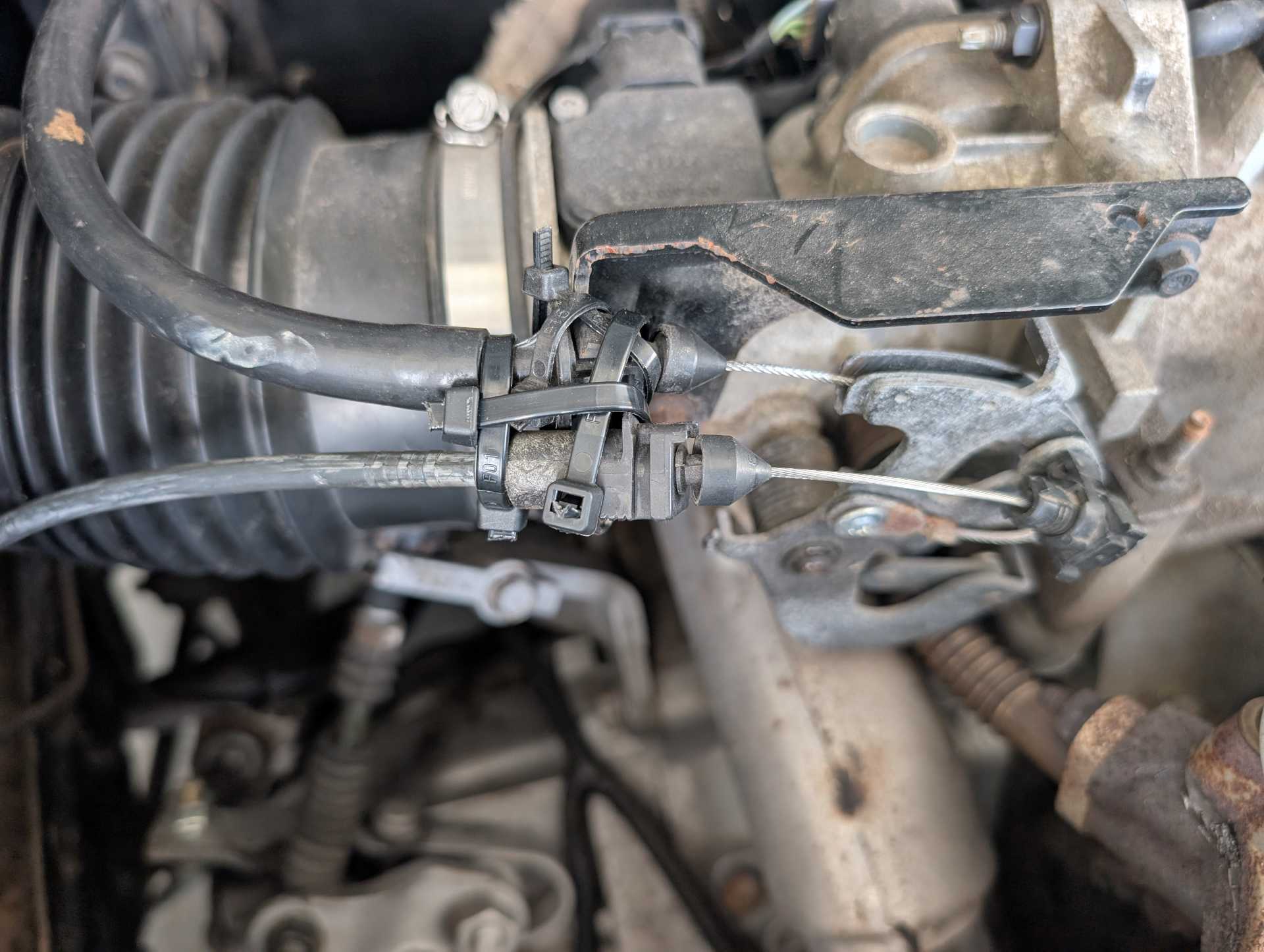

Finished product, I opted to route my throttle cable down and around the driver side of the engine bay, the throttle cable length was perfect:

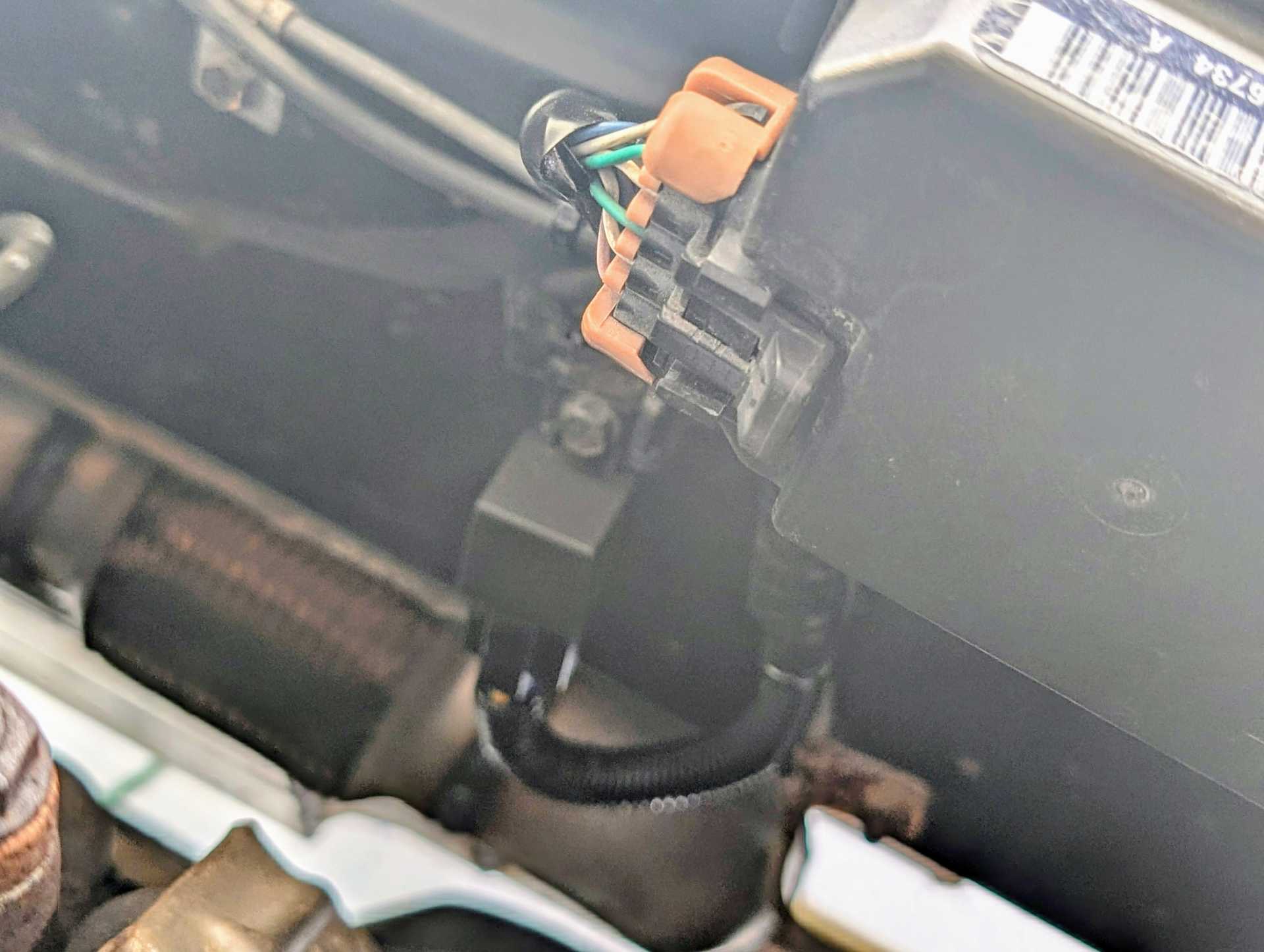

Relay location, there was a mounting position right below the cruise module that was perfect:
I do need to figure something out with the throttle cable mount, because I have no idea what is going on with this and I needs to be cleaned up. The previous owner pointed it out to me that he wasn't too happy with it, neither am I, but it's working for now. Maybe next weekend I can find a suitable bracket to fix it. It looks like it was snapped or broken somehow:

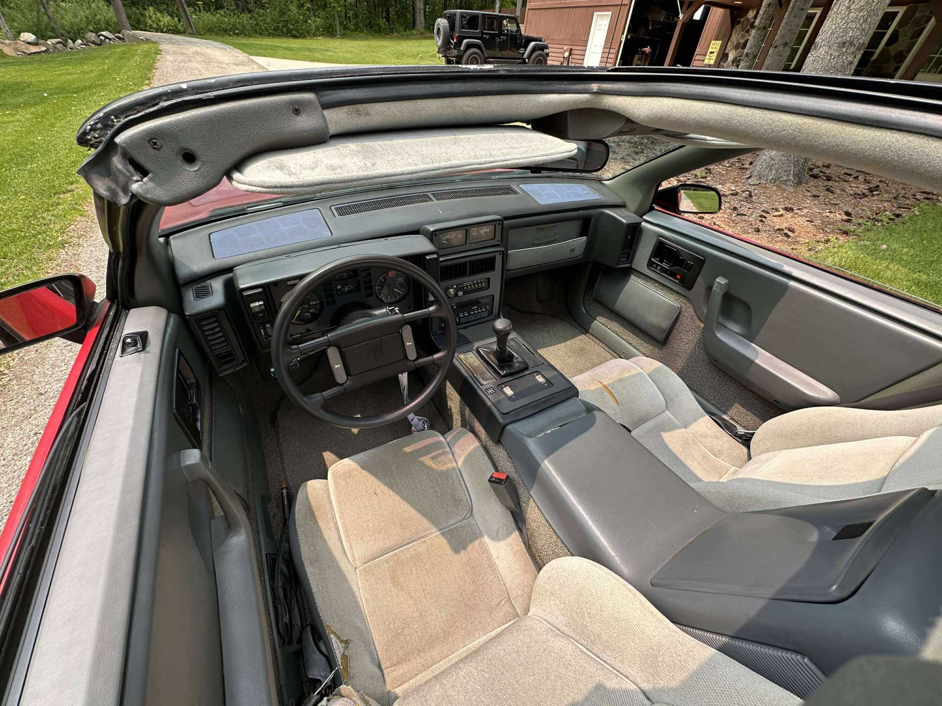

Went to the yard and grabbed a new throttle cable bracket. I see why zip ties were needed, the throttle cable doesn't fit in there perfectly. I was able to put the cruise cable in though and trimmed the throttle cable moment some and made it work with minimal zip ties.

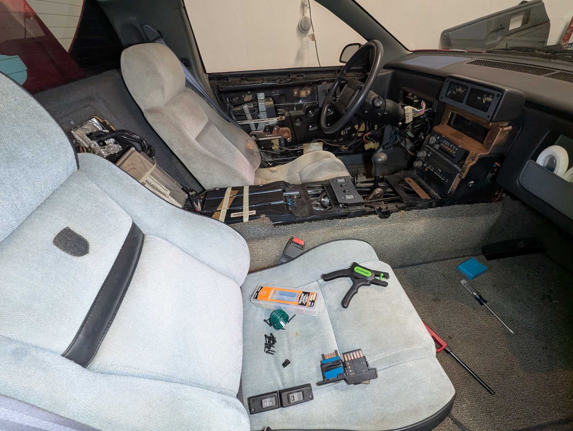

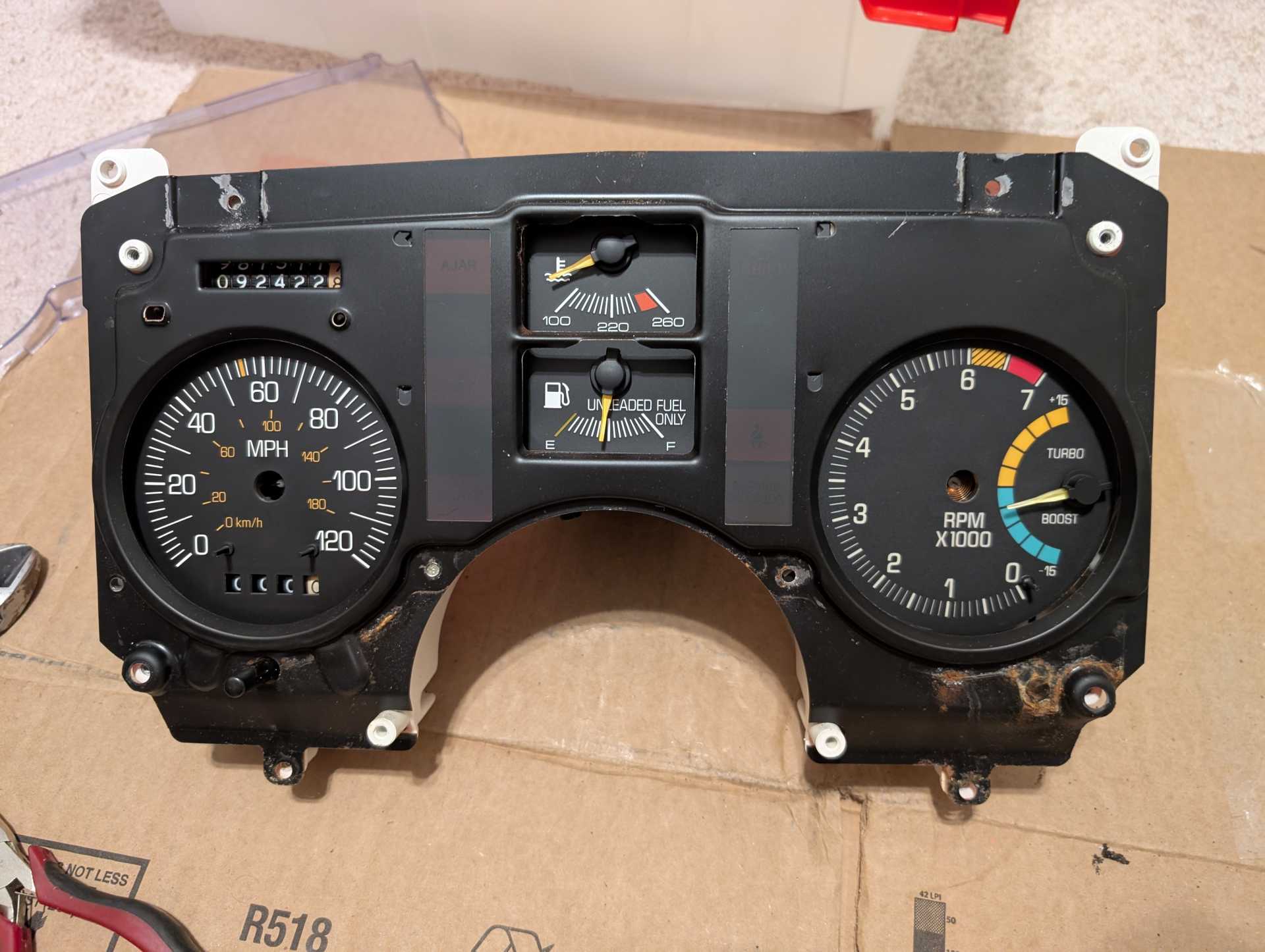

This is the current interior. I took out the gauge cluster and did the temp gauge fix. I also replaced the trip stepper motor and hopefully it starts working again. I'm nearly done with the Sunbird boost gauge as well, I need to replace the battery and calibrate the tach to a V6 and hook it up to the ECU on Pin 25. Note that the Fiero tach needle is a little shorter on the mount than the Sunbird's so I couldn't swap them over. When the key is on start then I'll put the needles back on pointed at 0 and then I can proceed with calibration.
While everything is out, I'll also do my auto headlight module and replace the radio. I've already done everything needed for the trunk release, that'll be very nice to have.
I have replaced the passenger seat, I'll do the driver seat soon. I found out the clutch master cylinder is leaking, so I'll replace that and the clutch pedal at the same time and then do the seat. I think I'll need all the space I can get.
Finally, I have received my rubber glue in the mail. There are a few nicks and small tears in the T Top seal that I'll be repairing.
