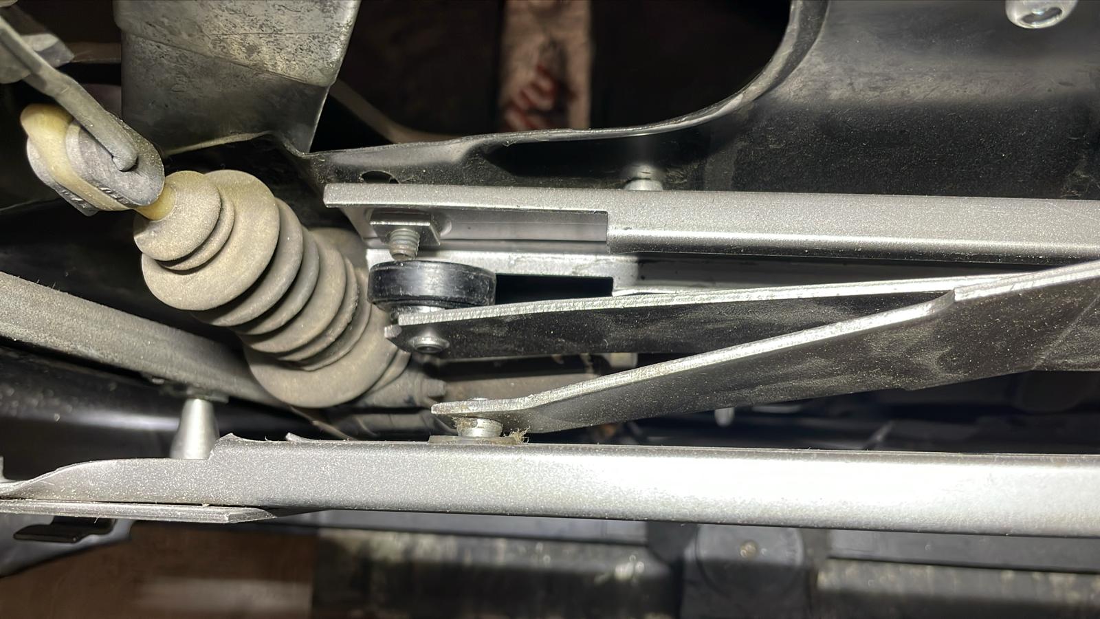

Hello, I'd like to ask about a problem I'm having.
I replaced the motors and restored the all glass support. I reassembling it, the horizontal wheel always falls off the track.
I can't find the fault. Whenever I raise or lower the glass, it pops out at the midpoint.
Any suggestions? What am I doing wrong?

The window tracks are fastened to the inner door panel with two bolts that are adjustable. The window height is also adjustable with window stops. Sounds like you need to adjust the tracks by moving them in.

I'll try to modify it, but this doesn't go forward or backward, it goes up or down. But it always has a fixed point on one side.

Move the TRACKS that the window rides in not the mechanism. They are adjustable.

Yes when things bind other things pop. An adjustment will fix this.
