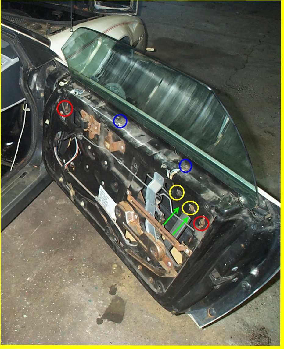

Adjusting windows can be trickey but let me gather up some pics.

AHH there we go!
Blue
Will take out general floppyness of the window when it is fully up. DON'T make it to tight because it will bind the window when it's 1/2 way down and scratch the crap out of the glass.
Yellow
Adjusts (centers) the front and rear of the window in the door seal when the door is closed.
Red
Is the most trickey, it adjusts the full up position of the window. the hard part is the stops get floppy over time and it gets hard to make a fine adjustments. The real trick it to get the window to hit the front and rear stops at the same time. If you don't get it right the window will tilt if it hits one before the other.
Green arrows
In the door on the underside.
Adjusts the in and out of the window against the frame and is adjusted in conjunction with the BLUE circles. If you get the window to tight against the seal then it will be hard to roll the window up. to loose and you will get leaks and wind noise.
I think there is another in /out in the "nose channel" in the front but I'm not sure because I have never had to adjust it.
Be patient it takes time to get it right.

OH and make sure your door hinges are not worn out. All the adjustment in the world wont help.
