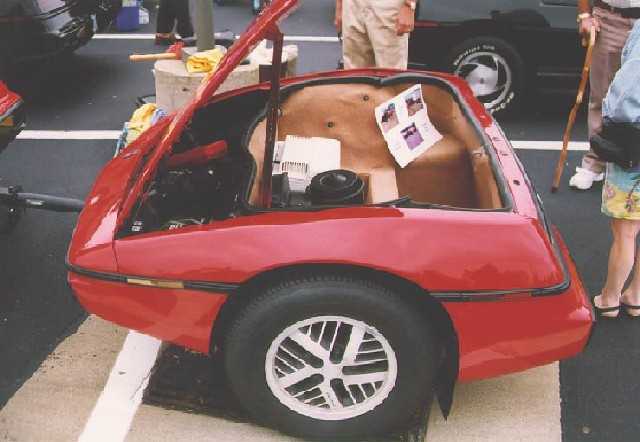

So everyone is supposed to be awed by a build that is Not even remotely unique or new. (No, that not a question.) Several times has been done here alone in various ways and some are far better looking like...
from https://www.fiero.nl/forum/...040223-1-035784.html
Other had kept the "back window" w/ and w/o glass like you and look bad too and worse causes more drag etc eating more MPG and other problems.
You ask a Q and No Clue what a "heavy trailer" means let alone that term often is ref to the tow vehicle used... (Tow 2000lb behind F350 or C3500 and they won't even notice.)
These new pics prove what?
I already guess most of this because of tongue length and shape and other pics.
And use Edit to remove the space at .fieroforu m.com in 2 img tags that are "broken" above. Pics are there but the space break the tag.
Your trailer likely started as this type... https://www.fiero.nl/forum/...110502-1-070402.html
Very likely the base trailer weights around 200# before adding the floor and walls then now the Fiero body parts and extra metal to hold them.
If trailer is close to balance on the axle now then can become unstable towing. You need ~ 10% tongue heavy empty and loaded for this reason.
You have Fiero Taillights but may need other lights/reflectors to be legal everywhere you tow it. Base Trailer or low box it became before this may have some rules that are different because of length width and/or height. (Like many Trailer taillight kits often have side markers built into them for this reason.)
Also, same thread is showing a car Over Weight by ~ 1100lb... GVWR for most Fiero is Under ~ 3100lb or ~ 1400kg
May "look ok" on a scale to many people and maybe under GVWR for the trailer But these 1 axle trailers Have No Brakes so The Car has to Stop the Trailer and it's Load on it On Top of whatever else as The Car was likely still Over Loaded w/o the trailer going by the scale display. Yet Many people claim "Fiero Brakes Suck" even when they work right....
