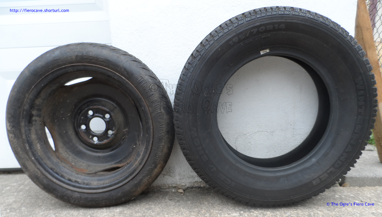

Any way to put a stock wheel where the spare is?
No.
195/70-14 hits both Brake MC and jack bracket before even 50% in the tire well.
Even if you remove the jack bracket letting washer fluid tank hanging on 1 bolt you just hit other things 1 or 2 inches away and still hitting MC.
185/80-13 wheel used for some 84 & 85 won't fit because very close to same diameter and anything larger just hits things sooner and easier to wreck them.

I'm bored so did some measuring today...
195/70-14 is ~ 24⅝" diam, 7" wide
125/70D15 is ~ 21½" diam, 5⅛ wide for just the tire. Rim and tire is 5¾" wide because of weird center section.
Two together...
Not only won't fit as said above... (And that hit's the jack bracket, forget trying w/ jack mounted before or after. Either Not Happening.)
The width will stop you a bit farther down in the bay.
That's w/ or w/o AC because of frame just below AC parts.
Even if can put a normal tire in, can't shut the hood.
I Assumed Toddster "mod" above is a joke...
Because Damn near impossible to mod the front to take a full size tire.
Not only the above would need changing or removal,
Rad and it's fan, Steering Rack and Lower Column likely have problems too.
Sadly the Real Trunk have problems w/ bigger tires too. Even some OE tires...
Measure, Trunk allows ~ 24-25 high and 7½" total wide.
Barely fits 195/70-14, Maybe 205/60-15. (205 Tread is ~ 7" but sidewalls 8+".)
Does anyone ever put bigger OEM GT Rear, 215/60-15, there?
Maybe either/both:
. 8" to 9" total width but only flat so can squeeze the sidewalls.
. 25" or bit more but only flat so can squeeze the height.
If you have the power trunk options... the solenoid take up some space and maybe problems w/ maximum size flat tires.
I bet most w/ wider and/or taller tires never tried that until after a flat and can't get in there or can't close the trunk lid.
[This message has been edited by theogre (edited 05-24-2021).]
